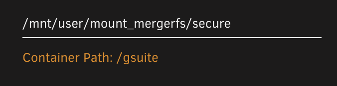

This is the path used in plex:
/gsuite/video_files/movies/4K/_meta70/Interstellar.2014.UHD.BluRay.2160p/Interstellar.2014.UHD.BluRay.2160p.mkv

Hi - little confused on this. I set up the script with the default settings. I want to use local and remote files and have them merged. However when I go to Plex and try to set up the mount point to be /mnt/user/mount_mergerfs, there is only my mount folder displayed. Is this expected? Where should I be pointing Plex to scan files from?
I can set plex to /mnt/user/rclone or /mnt/user/local, but doesn't that defeat the purpose.
Edited by thekiefs
you should point plex to the mergerfs folder.  You have to start plex AFTER you've created the mount, which might explain your problem.

It looks like I have the same problem, here are my sonarr and qbt docker conf
image.png.fb22deb14b7183fdfb78e400552ef6f6.pngimage.thumb.png.19b1b6b02860565152466d1499238920.png
and ls -ldi from a file :
ls -ldi /mnt/user/mount_mergerfs/gdrive_vfs/medias/tv/hd/Friends\ \(1994\)/Season\ 1/Friends\ -\ S01E01\ -\ The\ One\ Where\ Monica\ Gets\ a\ Roommate\ x265\ AC3\[EN+FR\]\ \[FR+EN\]\ Bluray-1080p.mkv
6952752600862098309 -rw-r--r-- 1 nobody users 399322889 Mar 22 12:33 /mnt/user/mount_mergerfs/gdrive_vfs/medias/tv/hd/Friends\ (1994)/Season\ 1/Friends\ -\ S01E01\ -\ The\ One\ Where\ Monica\ Gets\ a\ Roommate\ x265\ AC3[EN+FR]\ [FR+EN]\ Bluray-1080p.mkv

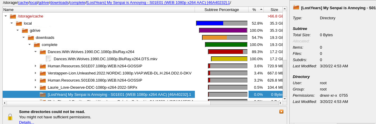

Hi all!
All is working well, i only have this issue, and it makes me clean up the path like once a month.
so in my /local/gdrive/downloads/complete/ i have some files just laying around filling up my cache.
there is no failed files in sabnzbd so it cant be from there? anybody tried something like this?
Your destination in the Flood download client config in Sonarr should be /user/mount_mergerfs/downloads/complete/sonarr/ I believe. That should hopefully get it sorted :)
