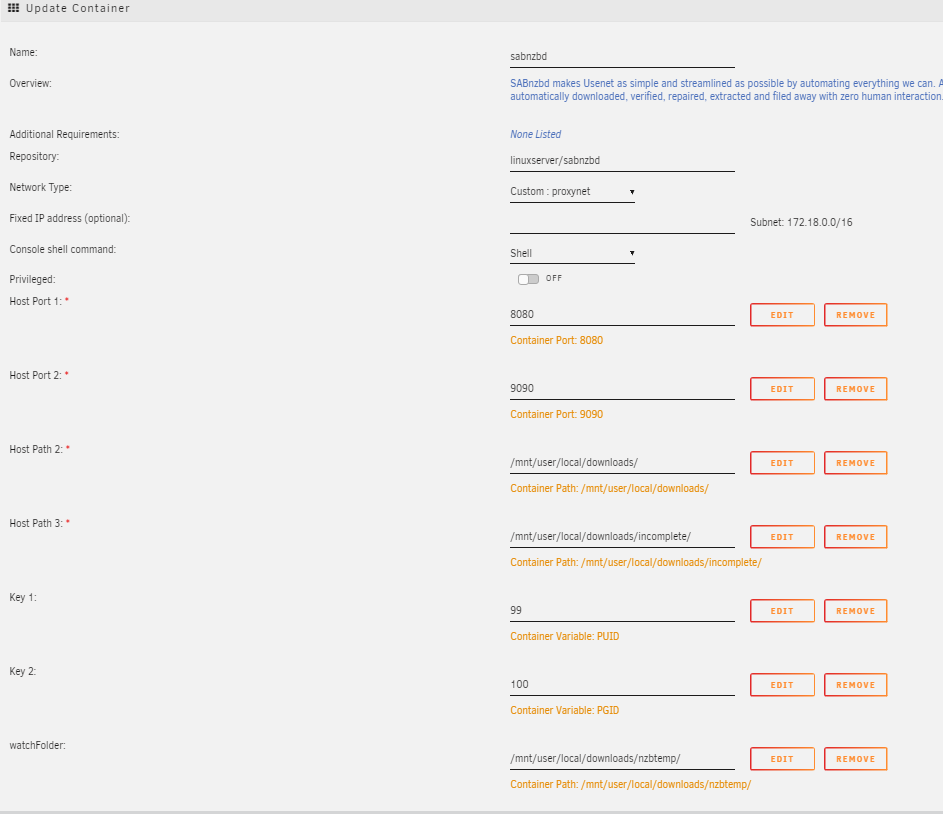

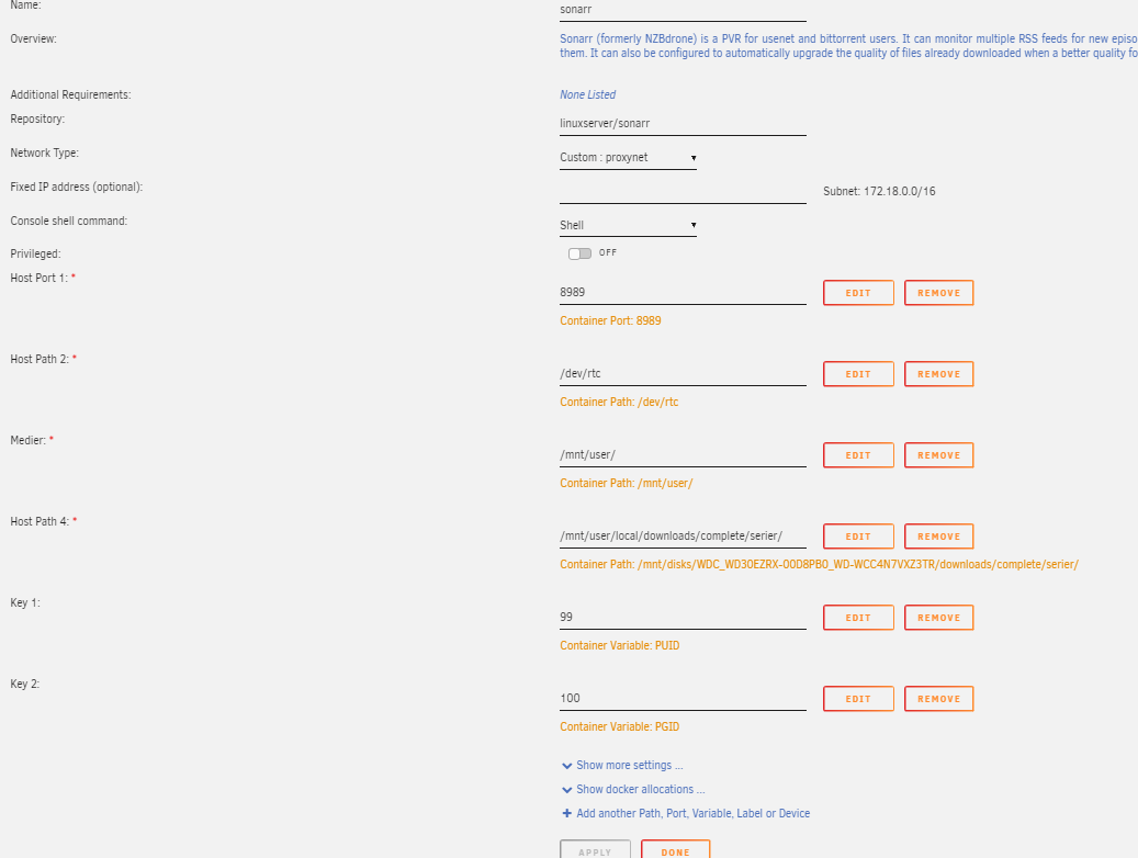

Hi @Bolagnaise: I have update Unraid to 6.10 stable in order to avoid any problems, but I have problems with Sonarr not moving files because of permissions.
My folders is showing this.
Which of you fixes should I use.
Should I just add
--uid 98 \
--gid 99 \
to my scripts or do I need to do some extra work.
You don't show the owners of your media folders?
But I think it's an issue with the docker paths. You need to show your docker templates for Sab and Sonarr.

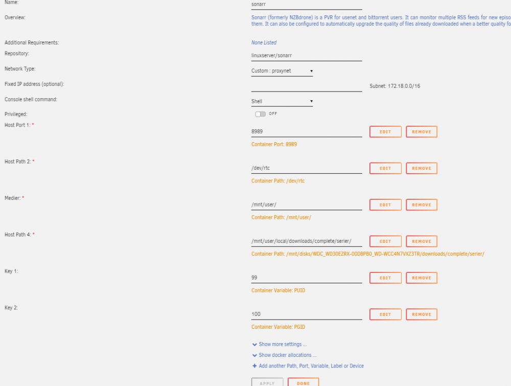

This is how it looks.
But it has never been a problem with 6.9.2 but 6.10 is a problem.
Sonarr is PUID 99 and GGID 100
Well I'm not a big fan of your mappings. I don't really see direct conflicts there, but I personally just removed all the specific paths like /incomplete and such. I'm talking about the media paths here, not paths like the /dev/rtc one.
And only use /user (or in your case /mnt/user). And then within the docker use that as start point to get to the right folder. Much easier to prevent any path issues, but that's up to you.

Thanks for the answer.
I'm not sure I follow. What's wrong with my mappings.
When I start to download it puts it in local folder before uploading it.
The dockers are mounted path in media folder in mount_merger folders.
All is what I was adviced in here and have worked before.
The /dev/rtc is only shown once in template, but that's default.
The other screenshots from ssh is the direct paths as asked for.
I'm not an expert, so please share advice on what I should map differently.
With the mappings what I'm saying is that you can remove the paths for /incomplete /downloads for Sab and for Sonarr /downloads and /series and just replace those with 1 path to /mnt/user/. Then inside the dockers for example Sab you will just point your incomplete folder to /mnt/user/downloads/incomplete instead of /incomplete. That way you keep the paths uniform and dockers will look at the same file through the same route (this is often a reason for file errors).
What I find confusing when looking at your screenshots again, is that you point to the local folders. Why are you not using the /mnt/unionfs/ or mnt/mergerfs/ folders?
I'm talking about the user script, but within (depending on what your script looks like) you have a part that is the mount and after the mount you merge the mount (cloud) with a local folder. So I was talking about the 2/3 flags that you need to add to your mount part of your user script. If you use the full template of DZMM then you can just add those 2 flags (--uid 99 --gid 100) in the list with all the other flags.

Thanks Kaizac. It regards to the paths that makes sense with /mnt/user only. The only problem I see if I do it that way in Sonarr and especially in Plex it would need to refresh libraries because of file change.
One of my scripts looks like this below.
I'm guessing the guid gid umask should be under this section?:
 --drive-pacer-min-sleep 10ms \
    --drive-pacer-burst 1000 \
    --vfs-cache-mode full \
        --vfs-read-chunk-size 256M \
    --vfs-cache-max-size 100G \
    --vfs-cache-max-age 96h \
    --vfs-read-ahead 2G \
The reason is that I point all downloaded stuff to local folder and in the night it will upload.

Thanks for the answer @DZMM. I will strongly consider if it's worth the effort because it is working fine that part.
But can you answer guid gid umask should be in the scrip above?
Also I've seen a couple of times that my movies share dissappear suddenly without any reason all other scripts don't have this. Am I the only one who have seen this?
Should I just add
--uid 98 \
--gid 99 \

For the GID and UID you can try the script Bolagnaise put above this post. Make sure you alter the directory to your folder structure. For me this wasn't the solution, cause it was often stuck on my cloud folders. But just try it, maybe it works and you don't need to bother further.
If that doesn't solve your issue, then you need to put the GID and UID commands where you suggested yes.
We discussed your local folder structure earlier. The whole point of using mergerfs and the merged folder structure (/mnt/user/mount_unionfs/gdrive instead of /mnt/user/local/gdrive) is that it doesn't matter to your server and dockers if the files are actually local or in your cloud storage, it treats it the same.
If you then used the upload script correctly, it will only upload the files that are actually stored locally, because the upload script does look at the local files, not the merged files/folders.
The dissapearing of your folders is not something I've noticed myself. But are you looking at the local folder or the merged folder when you see that happening? If you look at the local folders it would explain it to me, because the upload script deletes source folders when done and empty. If it's when you look at your merged folder, then it seems strange to me.

Regarding the paths you can remove or edit the /data paths and add /user in the docker template. Within the docker itself you need to check the settings of that docker and change the paths accordingly. I know binhex uses /data so if you use mostly binhex it will often work ok. But because you use different path/mapping names Unraid will not see it as the same drive and thus will see it as a move from one drive to another, instead of within the same drive. And moving server side is pretty much instant, but if you use the wrong paths it will go through your server back to the cloud storage.
So again, check your docker templates and mappings/paths that point to media files and such delete those and only use 1 path which is high level like /mnt/user or /mnt/user/mount_unionfs/Gdrive. And then go in the docker and change the paths used inside. Once you know what you are doing and looking for it's very simple and quick. Just do it docker by docker.
Regarding your ITX build, I would recommend if you have the money to get at least 1 cache SSD and better is to get 2 SSD's (1 TB per SDD or more) for cache put in a pool with BTRFS. It's good for your appdata, but you can also run your downloads/uploads and Plex library from it. Especially the downloading/uploading will be better from the SSD because it does not have to switch between reading and writing like a HDD. Using 1 SSD for cache is fine as well, just be careful of what other data you let go through your cache SSD, because if your SSD dies (and it will often instantly die, unlike a HDD). your data will be lost. And get backups of course. Just general good Server housekeeping ;).
EDIT: If you are unsure if you are doing the mappings right, just show screenshots of before and after from the template and inside the docker if you want and we can check it for you. Don't feel bothered doing that, I think many struggle with the same in the beginning.
Edited by Kaizac
IMO you can't go wrong with using /user and /disks - at least for your dockers that have to talk to each other.  I think the background to Dockers is they were setup as a good way to ringfence access and data.  However, we want certain dockers to talk to each other easily!

I also had the permissions issues so what I did is adding these lines to my mount scripts (not the merger, but the actual mount script for your Rclone mount). Those root/root folders are the issue, since sonarr is not running as root.
--uid 99 --gid 100
And in case you didnt have it already (I didn't): --umask 002
Add these and reboot, see if that solves the importing issue.
@KaizacI tried using the UID/PID/UMASK in userscripts mount and added it to the section in the mountscript:
# create rclone mount
    rclone mount \
    --allow-other \
    --buffer-size 256M \
    --dir-cache-time 720h \
    --drive-chunk-size 512M \
    --log-level INFO \
    --vfs-read-chunk-size 128M \
    --vfs-read-chunk-size-limit off \
    --vfs-cache-mode writes \
    --bind=$RCloneMountIP \
    $RcloneRemoteName: $RcloneMountLocation &
    --uid 99
    --gid 100
    --umask 002
Sonarr still won't get import access from the complete local folder where it's at.
My rclone mount folders are still showing root:
@BolagnaiseIf I try the permission docker tool, I would risk breaking Plex transcoder, which I don't want.
