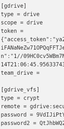

These are the 2 remotes I have made:
This is the mount script:
Could you please tell me if this is setup correctly? I have now tried to keep the names of mounts and folders the same as the default mount script and first post in this thread. Can I safely start the mount script now?
6 minutes ago, workermaster said:
I suspected that names could be changed, but am not that confident that I got it right.
Rename your crypt to gdrive_vfs through rclone config and you're good to go.

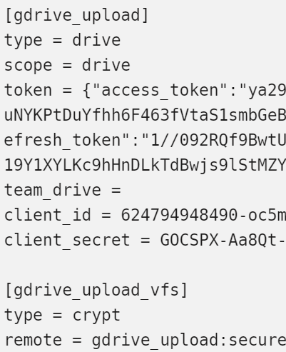

Here's your problem:
2022/10/14 00:10:01 DEBUG : Using config file from "/boot/config/plugins/rclone/.rclone.conf"
2022/10/14 00:10:01 DEBUG : Creating backend with remote "gdrive_upload_vfs:"
2022/10/14 00:10:01 Failed to create file system for "gdrive_upload_vfs:": didn't find section in config file
You don't have a gdrive_upload_vfs remote in your config.  Create another remote with a new API key or service account if you've setup teamdrives (recommended as you will likely need teamdrives in the future).
The upload uses a diff remote and API to try and reduce the risk of an API ban (very rare if you set things up correctly) affecting the mount responsible for playback.
Edited by DZMM

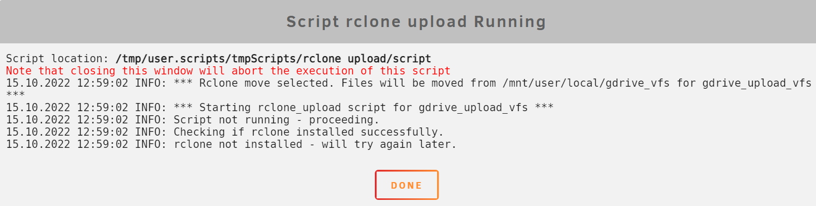

1 minute ago, DZMM said:
Much easier to post direct:
Script Starting Oct 13, 2022  23:10.01
Full logs for this script are available at /tmp/user.scripts/tmpScripts/rclone upload/log.txt
13.10.2022 23:10:01 INFO: *** Rclone move selected.  Files will be moved from /mnt/user/local/gdrive_vfs for gdrive_upload_vfs ***
13.10.2022 23:10:01 INFO: *** Starting rclone_upload script for gdrive_upload_vfs ***
13.10.2022 23:10:01 INFO: Script not running - proceeding.
13.10.2022 23:10:01 INFO: Checking if rclone installed successfully.
13.10.2022 23:10:01 INFO: rclone not installed - will try again later.
Script Finished Oct 13, 2022  23:10.01
Script Starting Oct 14, 2022  00:10.01
14.10.2022 00:10:01 INFO: *** Rclone move selected.  Files will be moved from /mnt/user/local/gdrive_vfs for gdrive_upload_vfs ***
14.10.2022 00:10:01 INFO: *** Starting rclone_upload script for gdrive_upload_vfs ***
14.10.2022 00:10:01 INFO: Script not running - proceeding.
14.10.2022 00:10:01 INFO: Checking if rclone installed successfully.
14.10.2022 00:10:01 INFO: rclone installed successfully - proceeding with upload.
14.10.2022 00:10:01 INFO: Uploading using upload remote gdrive_upload_vfs
14.10.2022 00:10:01 INFO: *** Using rclone move - will add --delete-empty-src-dirs to upload.
2022/10/14 00:10:01 INFO  : Starting bandwidth limiter at 12Mi Byte/s
2022/10/14 00:10:01 INFO  : Starting transaction limiter: max 8 transactions/s with burst 1
2022/10/14 00:10:01 DEBUG : --min-age 15m0s to 2022-10-13 23:55:01.599038088 +0200 CEST m=-899.976808163
2022/10/14 00:10:01 DEBUG : rclone: Version "v1.59.2" starting with parameters ["rcloneorig" "--config" "/boot/config/plugins/rclone/.rclone.conf" "move" "/mnt/user/local/gdrive_vfs" "gdrive_upload_vfs:" "--user-agent=gdrive_upload_vfs" "-vv" "--buffer-size" "512M" "--drive-chunk-size" "512M" "--tpslimit" "8" "--checkers" "8" "--transfers" "4" "--order-by" "modtime,ascending" "--min-age" "15m" "--exclude" "downloads/**" "--exclude" "*fuse_hidden*" "--exclude" "*_HIDDEN" "--exclude" ".recycle**" "--exclude" ".Recycle.Bin/**" "--exclude" "*.backup~*" "--exclude" "*.partial~*" "--drive-stop-on-upload-limit" "--bwlimit" "01:00,off 08:00,15M 16:00,12M" "--bind=" "--delete-empty-src-dirs"]
2022/10/14 00:10:01 DEBUG : Creating backend with remote "/mnt/user/local/gdrive_vfs"
14.10.2022 00:10:01 INFO: Not utilising service accounts.
14.10.2022 00:10:01 INFO: Script complete
Script Finished Oct 14, 2022  00:10.01

14.10.2022 01:10:01 INFO: Script not running - proceeding.
14.10.2022 01:10:01 INFO: Checking if rclone installed successfully.
14.10.2022 01:10:01 INFO: rclone installed successfully - proceeding with upload.
14.10.2022 01:10:01 INFO: Uploading using upload remote gdrive_upload_vfs
14.10.2022 01:10:01 INFO: *** Using rclone move - will add --delete-empty-src-dirs to upload.
2022/10/14 01:10:01 INFO  : Starting transaction limiter: max 8 transactions/s with burst 1
2022/10/14 01:10:01 DEBUG : --min-age 15m0s to 2022-10-14 00:55:01.633774573 +0200 CEST m=-899.977784544
2022/10/14 01:10:01 DEBUG : rclone: Version "v1.59.2" starting with parameters ["rcloneorig" "--config" "/boot/config/plugins/rclone/.rclone.conf" "move" "/mnt/user/local/gdrive_vfs" "gdrive_upload_vfs:" "--user-agent=gdrive_upload_vfs" "-vv" "--buffer-size" "512M" "--drive-chunk-size" "512M" "--tpslimit" "8" "--checkers" "8" "--transfers" "4" "--order-by" "modtime,ascending" "--min-age" "15m" "--exclude" "downloads/**" "--exclude" "*fuse_hidden*" "--exclude" "*_HIDDEN" "--exclude" ".recycle**" "--exclude" ".Recycle.Bin/**" "--exclude" "*.backup~*" "--exclude" "*.partial~*" "--drive-stop-on-upload-limit" "--bwlimit" "01:00,off 08:00,15M 16:00,12M" "--bind=" "--delete-empty-src-dirs"]
2022/10/14 01:10:01 DEBUG : Creating backend with remote "/mnt/user/local/gdrive_vfs"
2022/10/14 01:10:01 DEBUG : Using config file from "/boot/config/plugins/rclone/.rclone.conf"
2022/10/14 01:10:01 DEBUG : Creating backend with remote "gdrive_upload_vfs:"
2022/10/14 01:10:01 Failed to create file system for "gdrive_upload_vfs:": didn't find section in config file
14.10.2022 01:10:01 INFO: Not utilising service accounts.
14.10.2022 01:10:01 INFO: Script complete
Script Finished Oct 14, 2022  01:10.01
Script Starting Oct 14, 2022  02:10.01
14.10.2022 02:10:01 INFO: *** Rclone move selected.  Files will be moved from /mnt/user/local/gdrive_vfs for gdrive_upload_vfs ***
14.10.2022 02:10:01 INFO: *** Starting rclone_upload script for gdrive_upload_vfs ***
14.10.2022 02:10:01 INFO: Script not running - proceeding.
14.10.2022 02:10:01 INFO: Checking if rclone installed successfully.
14.10.2022 02:10:01 INFO: rclone installed successfully - proceeding with upload.
14.10.2022 02:10:01 INFO: Uploading using upload remote gdrive_upload_vfs
14.10.2022 02:10:01 INFO: *** Using rclone move - will add --delete-empty-src-dirs to upload.
2022/10/14 02:10:01 INFO  : Starting transaction limiter: max 8 transactions/s with burst 1
2022/10/14 02:10:01 DEBUG : --min-age 15m0s to 2022-10-14 01:55:01.575049712 +0200 CEST m=-899.971436350
2022/10/14 02:10:01 DEBUG : rclone: Version "v1.59.2" starting with parameters ["rcloneorig" "--config" "/boot/config/plugins/rclone/.rclone.conf" "move" "/mnt/user/local/gdrive_vfs" "gdrive_upload_vfs:" "--user-agent=gdrive_upload_vfs" "-vv" "--buffer-size" "512M" "--drive-chunk-size" "512M" "--tpslimit" "8" "--checkers" "8" "--transfers" "4" "--order-by" "modtime,ascending" "--min-age" "15m" "--exclude" "downloads/**" "--exclude" "*fuse_hidden*" "--exclude" "*_HIDDEN" "--exclude" ".recycle**" "--exclude" ".Recycle.Bin/**" "--exclude" "*.backup~*" "--exclude" "*.partial~*" "--drive-stop-on-upload-limit" "--bwlimit" "01:00,off 08:00,15M 16:00,12M" "--bind=" "--delete-empty-src-dirs"]
2022/10/14 02:10:01 DEBUG : Creating backend with remote "/mnt/user/local/gdrive_vfs"
2022/10/14 02:10:01 DEBUG : Using config file from "/boot/config/plugins/rclone/.rclone.conf"
2022/10/14 02:10:01 DEBUG : Creating backend with remote "gdrive_upload_vfs:"
2022/10/14 02:10:01 Failed to create file system for "gdrive_upload_vfs:": didn't find section in config file
14.10.2022 02:10:01 INFO: Not utilising service accounts.
14.10.2022 02:10:01 INFO: Script complete
Script Finished Oct 14, 2022  02:10.01
Script Starting Oct 14, 2022  03:10.01
14.10.2022 03:10:01 INFO: *** Rclone move selected.  Files will be moved from /mnt/user/local/gdrive_vfs for gdrive_upload_vfs ***
14.10.2022 03:10:01 INFO: *** Starting rclone_upload script for gdrive_upload_vfs ***
14.10.2022 03:10:01 INFO: Script not running - proceeding.
14.10.2022 03:10:01 INFO: Checking if rclone installed successfully.
14.10.2022 03:10:01 INFO: rclone installed successfully - proceeding with upload.
14.10.2022 03:10:01 INFO: Uploading using upload remote gdrive_upload_vfs
14.10.2022 03:10:01 INFO: *** Using rclone move - will add --delete-empty-src-dirs to upload.
2022/10/14 03:10:01 INFO  : Starting transaction limiter: max 8 transactions/s with burst 1
2022/10/14 03:10:01 DEBUG : --min-age 15m0s to 2022-10-14 02:55:01.653249435 +0200 CEST m=-899.976725463
2022/10/14 03:10:01 DEBUG : rclone: Version "v1.59.2" starting with parameters ["rcloneorig" "--config" "/boot/config/plugins/rclone/.rclone.conf" "move" "/mnt/user/local/gdrive_vfs" "gdrive_upload_vfs:" "--user-agent=gdrive_upload_vfs" "-vv" "--buffer-size" "512M" "--drive-chunk-size" "512M" "--tpslimit" "8" "--checkers" "8" "--transfers" "4" "--order-by" "modtime,ascending" "--min-age" "15m" "--exclude" "downloads/**" "--exclude" "*fuse_hidden*" "--exclude" "*_HIDDEN" "--exclude" ".recycle**" "--exclude" ".Recycle.Bin/**" "--exclude" "*.backup~*" "--exclude" "*.partial~*" "--drive-stop-on-upload-limit" "--bwlimit" "01:00,off 08:00,15M 16:00,12M" "--bind=" "--delete-empty-src-dirs"]
2022/10/14 03:10:01 DEBUG : Creating backend with remote "/mnt/user/local/gdrive_vfs"
2022/10/14 03:10:01 DEBUG : Using config file from "/boot/config/plugins/rclone/.rclone.conf"
2022/10/14 03:10:01 DEBUG : Creating backend with remote "gdrive_upload_vfs:"
2022/10/14 03:10:01 Failed to create file system for "gdrive_upload_vfs:": didn't find section in config file
14.10.2022 03:10:01 INFO: Not utilising service accounts.
14.10.2022 03:10:01 INFO: Script complete
Script Finished Oct 14, 2022  03:10.01
Script Starting Oct 14, 2022  04:10.01
14.10.2022 04:10:01 INFO: *** Rclone move selected.  Files will be moved from /mnt/user/local/gdrive_vfs for gdrive_upload_vfs ***
14.10.2022 04:10:01 INFO: *** Starting rclone_upload script for gdrive_upload_vfs ***
14.10.2022 04:10:01 INFO: Script not running - proceeding.
14.10.2022 04:10:01 INFO: Checking if rclone installed successfully.
14.10.2022 04:10:01 INFO: rclone installed successfully - proceeding with upload.
14.10.2022 04:10:01 INFO: Uploading using upload remote gdrive_upload_vfs
14.10.2022 04:10:01 INFO: *** Using rclone move - will add --delete-empty-src-dirs to upload.
2022/10/14 04:10:01 INFO  : Starting transaction limiter: max 8 transactions/s with burst 1
2022/10/14 04:10:01 DEBUG : --min-age 15m0s to 2022-10-14 03:55:01.53442693 +0200 CEST m=-899.975643010
2022/10/14 04:10:01 DEBUG : rclone: Version "v1.59.2" starting with parameters ["rcloneorig" "--config" "/boot/config/plugins/rclone/.rclone.conf" "move" "/mnt/user/local/gdrive_vfs" "gdrive_upload_vfs:" "--user-agent=gdrive_upload_vfs" "-vv" "--buffer-size" "512M" "--drive-chunk-size" "512M" "--tpslimit" "8" "--checkers" "8" "--transfers" "4" "--order-by" "modtime,ascending" "--min-age" "15m" "--exclude" "downloads/**" "--exclude" "*fuse_hidden*" "--exclude" "*_HIDDEN" "--exclude" ".recycle**" "--exclude" ".Recycle.Bin/**" "--exclude" "*.backup~*" "--exclude" "*.partial~*" "--drive-stop-on-upload-limit" "--bwlimit" "01:00,off 08:00,15M 16:00,12M" "--bind=" "--delete-empty-src-dirs"]
2022/10/14 04:10:01 DEBUG : Creating backend with remote "/mnt/user/local/gdrive_vfs"
2022/10/14 04:10:01 DEBUG : Using config file from "/boot/config/plugins/rclone/.rclone.conf"
2022/10/14 04:10:01 DEBUG : Creating backend with remote "gdrive_upload_vfs:"
2022/10/14 04:10:01 Failed to create file system for "gdrive_upload_vfs:": didn't find section in config file
14.10.2022 04:10:01 INFO: Not utilising service accounts.
14.10.2022 04:10:01 INFO: Script complete
Script Finished Oct 14, 2022  04:10.01
Script Starting Oct 14, 2022  05:10.01
14.10.2022 05:10:01 INFO: *** Rclone move selected.  Files will be moved from /mnt/user/local/gdrive_vfs for gdrive_upload_vfs ***
14.10.2022 05:10:01 INFO: *** Starting rclone_upload script for gdrive_upload_vfs ***
14.10.2022 05:10:01 INFO: Script not running - proceeding.
14.10.2022 05:10:01 INFO: Checking if rclone installed successfully.
14.10.2022 05:10:01 INFO: rclone installed successfully - proceeding with upload.
14.10.2022 05:10:01 INFO: Uploading using upload remote gdrive_upload_vfs
14.10.2022 05:10:01 INFO: *** Using rclone move - will add --delete-empty-src-dirs to upload.
2022/10/14 05:10:01 INFO  : Starting transaction limiter: max 8 transactions/s with burst 1
2022/10/14 05:10:01 DEBUG : --min-age 15m0s to 2022-10-14 04:55:01.487436985 +0200 CEST m=-899.977354399
2022/10/14 05:10:01 DEBUG : rclone: Version "v1.59.2" starting with parameters ["rcloneorig" "--config" "/boot/config/plugins/rclone/.rclone.conf" "move" "/mnt/user/local/gdrive_vfs" "gdrive_upload_vfs:" "--user-agent=gdrive_upload_vfs" "-vv" "--buffer-size" "512M" "--drive-chunk-size" "512M" "--tpslimit" "8" "--checkers" "8" "--transfers" "4" "--order-by" "modtime,ascending" "--min-age" "15m" "--exclude" "downloads/**" "--exclude" "*fuse_hidden*" "--exclude" "*_HIDDEN" "--exclude" ".recycle**" "--exclude" ".Recycle.Bin/**" "--exclude" "*.backup~*" "--exclude" "*.partial~*" "--drive-stop-on-upload-limit" "--bwlimit" "01:00,off 08:00,15M 16:00,12M" "--bind=" "--delete-empty-src-dirs"]
2022/10/14 05:10:01 DEBUG : Creating backend with remote "/mnt/user/local/gdrive_vfs"
2022/10/14 05:10:01 DEBUG : Using config file from "/boot/config/plugins/rclone/.rclone.conf"
2022/10/14 05:10:01 DEBUG : Creating backend with remote "gdrive_upload_vfs:"
2022/10/14 05:10:01 Failed to create file system for "gdrive_upload_vfs:": didn't find section in config file
14.10.2022 05:10:01 INFO: Not utilising service accounts.
14.10.2022 05:10:01 INFO: Script complete
Script Finished Oct 14, 2022  05:10.01
Script Starting Oct 14, 2022  06:10.01
14.10.2022 06:10:01 INFO: *** Rclone move selected.  Files will be moved from /mnt/user/local/gdrive_vfs for gdrive_upload_vfs ***
14.10.2022 06:10:01 INFO: *** Starting rclone_upload script for gdrive_upload_vfs ***
14.10.2022 06:10:01 INFO: Script not running - proceeding.
14.10.2022 06:10:01 INFO: Checking if rclone installed successfully.
14.10.2022 06:10:01 INFO: rclone installed successfully - proceeding with upload.
14.10.2022 06:10:01 INFO: Uploading using upload remote gdrive_upload_vfs
14.10.2022 06:10:01 INFO: *** Using rclone move - will add --delete-empty-src-dirs to upload.
2022/10/14 06:10:01 INFO  : Starting transaction limiter: max 8 transactions/s with burst 1
2022/10/14 06:10:01 DEBUG : --min-age 15m0s to 2022-10-14 05:55:01.261004266 +0200 CEST m=-899.982153792
2022/10/14 06:10:01 DEBUG : rclone: Version "v1.59.2" starting with parameters ["rcloneorig" "--config" "/boot/config/plugins/rclone/.rclone.conf" "move" "/mnt/user/local/gdrive_vfs" "gdrive_upload_vfs:" "--user-agent=gdrive_upload_vfs" "-vv" "--buffer-size" "512M" "--drive-chunk-size" "512M" "--tpslimit" "8" "--checkers" "8" "--transfers" "4" "--order-by" "modtime,ascending" "--min-age" "15m" "--exclude" "downloads/**" "--exclude" "*fuse_hidden*" "--exclude" "*_HIDDEN" "--exclude" ".recycle**" "--exclude" ".Recycle.Bin/**" "--exclude" "*.backup~*" "--exclude" "*.partial~*" "--drive-stop-on-upload-limit" "--bwlimit" "01:00,off 08:00,15M 16:00,12M" "--bind=" "--delete-empty-src-dirs"]
2022/10/14 06:10:01 DEBUG : Creating backend with remote "/mnt/user/local/gdrive_vfs"
2022/10/14 06:10:01 DEBUG : Using config file from "/boot/config/plugins/rclone/.rclone.conf"
2022/10/14 06:10:01 DEBUG : Creating backend with remote "gdrive_upload_vfs:"
2022/10/14 06:10:01 Failed to create file system for "gdrive_upload_vfs:": didn't find section in config file
14.10.2022 06:10:01 INFO: Not utilising service accounts.
14.10.2022 06:10:01 INFO: Script complete
Script Finished Oct 14, 2022  06:10.01
Script Starting Oct 14, 2022  07:10.01
14.10.2022 07:10:01 INFO: *** Rclone move selected.  Files will be moved from /mnt/user/local/gdrive_vfs for gdrive_upload_vfs ***
14.10.2022 07:10:01 INFO: *** Starting rclone_upload script for gdrive_upload_vfs ***
14.10.2022 07:10:01 INFO: Script not running - proceeding.
14.10.2022 07:10:01 INFO: Checking if rclone installed successfully.
14.10.2022 07:10:01 INFO: rclone installed successfully - proceeding with upload.
14.10.2022 07:10:01 INFO: Uploading using upload remote gdrive_upload_vfs
14.10.2022 07:10:01 INFO: *** Using rclone move - will add --delete-empty-src-dirs to upload.
2022/10/14 07:10:01 INFO  : Starting transaction limiter: max 8 transactions/s with burst 1
2022/10/14 07:10:01 DEBUG : --min-age 15m0s to 2022-10-14 06:55:01.141222787 +0200 CEST m=-899.980360873
2022/10/14 07:10:01 DEBUG : rclone: Version "v1.59.2" starting with parameters ["rcloneorig" "--config" "/boot/config/plugins/rclone/.rclone.conf" "move" "/mnt/user/local/gdrive_vfs" "gdrive_upload_vfs:" "--user-agent=gdrive_upload_vfs" "-vv" "--buffer-size" "512M" "--drive-chunk-size" "512M" "--tpslimit" "8" "--checkers" "8" "--transfers" "4" "--order-by" "modtime,ascending" "--min-age" "15m" "--exclude" "downloads/**" "--exclude" "*fuse_hidden*" "--exclude" "*_HIDDEN" "--exclude" ".recycle**" "--exclude" ".Recycle.Bin/**" "--exclude" "*.backup~*" "--exclude" "*.partial~*" "--drive-stop-on-upload-limit" "--bwlimit" "01:00,off 08:00,15M 16:00,12M" "--bind=" "--delete-empty-src-dirs"]
2022/10/14 07:10:01 DEBUG : Creating backend with remote "/mnt/user/local/gdrive_vfs"
2022/10/14 07:10:01 DEBUG : Using config file from "/boot/config/plugins/rclone/.rclone.conf"
2022/10/14 07:10:01 DEBUG : Creating backend with remote "gdrive_upload_vfs:"
2022/10/14 07:10:01 Failed to create file system for "gdrive_upload_vfs:": didn't find section in config file
14.10.2022 07:10:01 INFO: Not utilising service accounts.
14.10.2022 07:10:01 INFO: Script complete
Script Finished Oct 14, 2022  07:10.01
Script Starting Oct 14, 2022  08:10.01
14.10.2022 08:10:01 INFO: *** Rclone move selected.  Files will be moved from /mnt/user/local/gdrive_vfs for gdrive_upload_vfs ***
14.10.2022 08:10:01 INFO: *** Starting rclone_upload script for gdrive_upload_vfs ***
14.10.2022 08:10:01 INFO: Script not running - proceeding.
14.10.2022 08:10:01 INFO: Checking if rclone installed successfully.
14.10.2022 08:10:01 INFO: rclone installed successfully - proceeding with upload.
14.10.2022 08:10:01 INFO: Uploading using upload remote gdrive_upload_vfs
14.10.2022 08:10:01 INFO: *** Using rclone move - will add --delete-empty-src-dirs to upload.
2022/10/14 08:10:01 INFO  : Starting bandwidth limiter at 15Mi Byte/s
2022/10/14 08:10:01 INFO  : Starting transaction limiter: max 8 transactions/s with burst 1
2022/10/14 08:10:01 DEBUG : --min-age 15m0s to 2022-10-14 07:55:01.924449369 +0200 CEST m=-899.979611353
2022/10/14 08:10:01 DEBUG : rclone: Version "v1.59.2" starting with parameters ["rcloneorig" "--config" "/boot/config/plugins/rclone/.rclone.conf" "move" "/mnt/user/local/gdrive_vfs" "gdrive_upload_vfs:" "--user-agent=gdrive_upload_vfs" "-vv" "--buffer-size" "512M" "--drive-chunk-size" "512M" "--tpslimit" "8" "--checkers" "8" "--transfers" "4" "--order-by" "modtime,ascending" "--min-age" "15m" "--exclude" "downloads/**" "--exclude" "*fuse_hidden*" "--exclude" "*_HIDDEN" "--exclude" ".recycle**" "--exclude" ".Recycle.Bin/**" "--exclude" "*.backup~*" "--exclude" "*.partial~*" "--drive-stop-on-upload-limit" "--bwlimit" "01:00,off 08:00,15M 16:00,12M" "--bind=" "--delete-empty-src-dirs"]
2022/10/14 08:10:01 DEBUG : Creating backend with remote "/mnt/user/local/gdrive_vfs"
2022/10/14 08:10:01 DEBUG : Using config file from "/boot/config/plugins/rclone/.rclone.conf"
2022/10/14 08:10:01 DEBUG : Creating backend with remote "gdrive_upload_vfs:"
2022/10/14 08:10:01 Failed to create file system for "gdrive_upload_vfs:": didn't find section in config file
14.10.2022 08:10:01 INFO: Not utilising service accounts.
14.10.2022 08:10:01 INFO: Script complete
Script Finished Oct 14, 2022  08:10.01
Script Starting Oct 14, 2022  09:10.01
14.10.2022 09:10:01 INFO: *** Rclone move selected.  Files will be moved from /mnt/user/local/gdrive_vfs for gdrive_upload_vfs ***
14.10.2022 09:10:01 INFO: *** Starting rclone_upload script for gdrive_upload_vfs ***
14.10.2022 09:10:01 INFO: Script not running - proceeding.
14.10.2022 09:10:01 INFO: Checking if rclone installed successfully.
14.10.2022 09:10:01 INFO: rclone installed successfully - proceeding with upload.
14.10.2022 09:10:01 INFO: Uploading using upload remote gdrive_upload_vfs
14.10.2022 09:10:01 INFO: *** Using rclone move - will add --delete-empty-src-dirs to upload.
2022/10/14 09:10:01 INFO  : Starting bandwidth limiter at 15Mi Byte/s
2022/10/14 09:10:01 INFO  : Starting transaction limiter: max 8 transactions/s with burst 1
2022/10/14 09:10:01 DEBUG : --min-age 15m0s to 2022-10-14 08:55:01.758059079 +0200 CEST m=-899.980332251
2022/10/14 09:10:01 DEBUG : rclone: Version "v1.59.2" starting with parameters ["rcloneorig" "--config" "/boot/config/plugins/rclone/.rclone.conf" "move" "/mnt/user/local/gdrive_vfs" "gdrive_upload_vfs:" "--user-agent=gdrive_upload_vfs" "-vv" "--buffer-size" "512M" "--drive-chunk-size" "512M" "--tpslimit" "8" "--checkers" "8" "--transfers" "4" "--order-by" "modtime,ascending" "--min-age" "15m" "--exclude" "downloads/**" "--exclude" "*fuse_hidden*" "--exclude" "*_HIDDEN" "--exclude" ".recycle**" "--exclude" ".Recycle.Bin/**" "--exclude" "*.backup~*" "--exclude" "*.partial~*" "--drive-stop-on-upload-limit" "--bwlimit" "01:00,off 08:00,15M 16:00,12M" "--bind=" "--delete-empty-src-dirs"]
2022/10/14 09:10:01 DEBUG : Creating backend with remote "/mnt/user/local/gdrive_vfs"
2022/10/14 09:10:01 DEBUG : Using config file from "/boot/config/plugins/rclone/.rclone.conf"
2022/10/14 09:10:01 DEBUG : Creating backend with remote "gdrive_upload_vfs:"
2022/10/14 09:10:01 Failed to create file system for "gdrive_upload_vfs:": didn't find section in config file

It sounds easy, but I have a talent for still making things go wrong. This case is not an exception.
I have created 2 new mounts and gave them a different client_id.
The ones I had:
The ones I added:
I hoped this was enough and tried to run the upload script manually to see what happened, and then I got this error:
Somehow, the script thinks rclone is not installed. The plugin is clearly there. I have no idea how I messed this up.
The ones I had:
The ones I added:
Post your script and rclone config please - remember to remove your passwords
I rebooted the server, and now it is uploading. No idea why it wouldn't work at first. I am now uploading a few files to test the read speeds with Plex.
