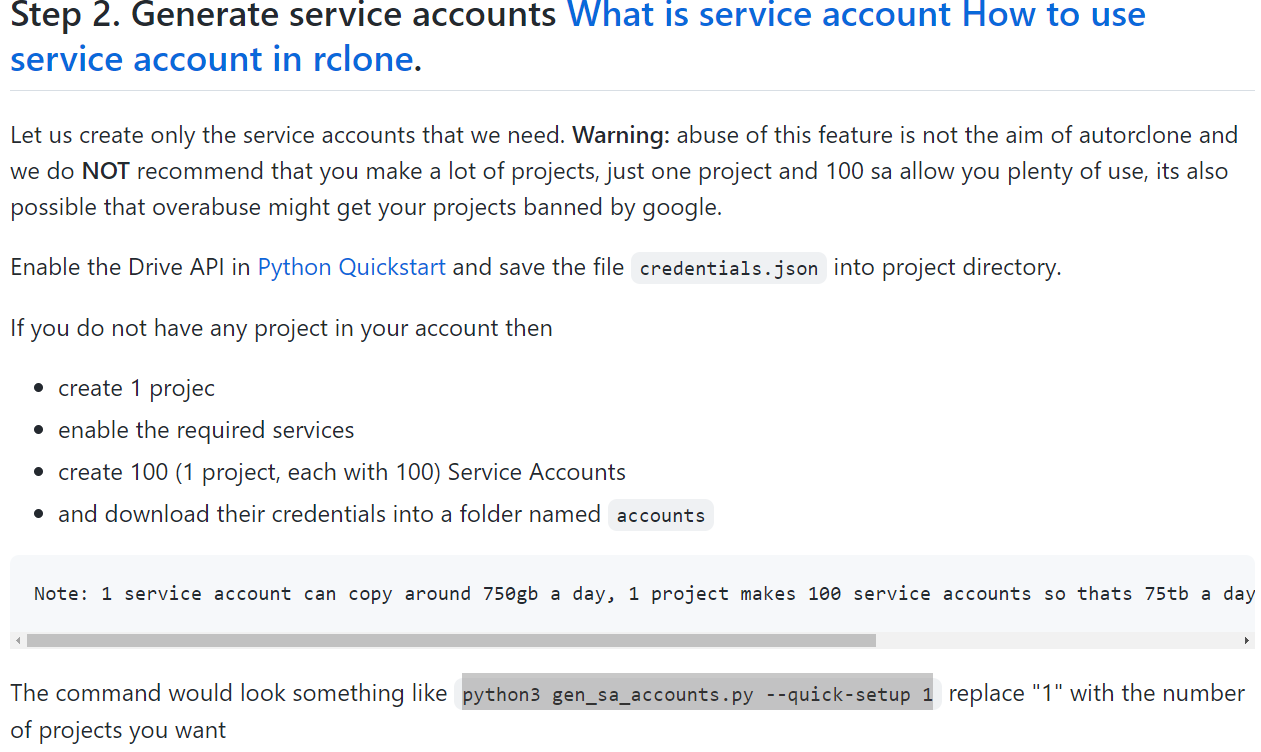

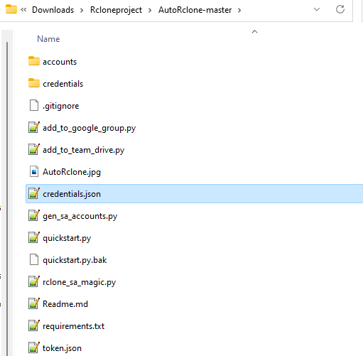

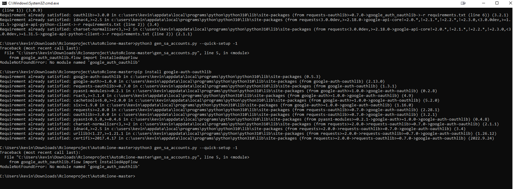

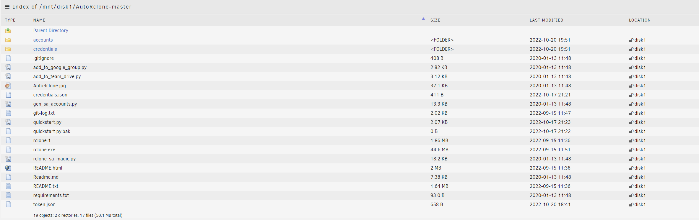

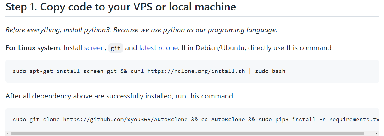

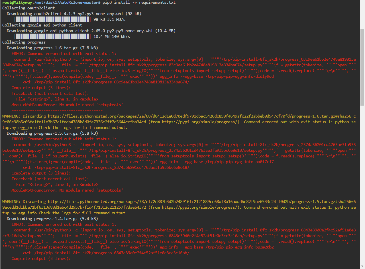

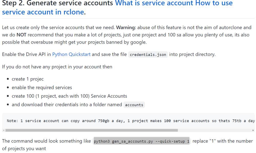

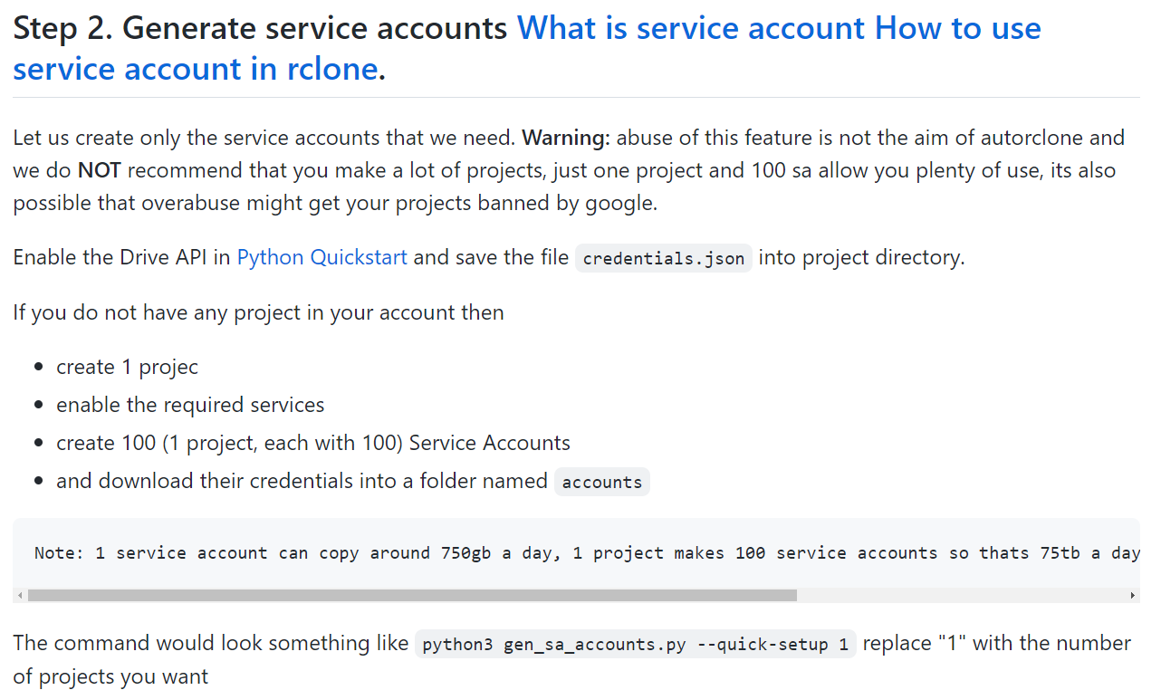

I made a post before, but deleted that since I managed to get a bit further. It has taken me a lot of stress, but have managed to do the first few steps.

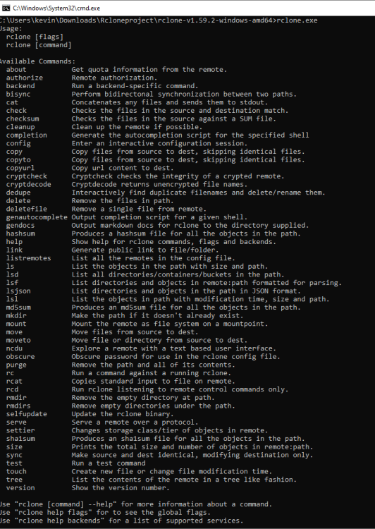

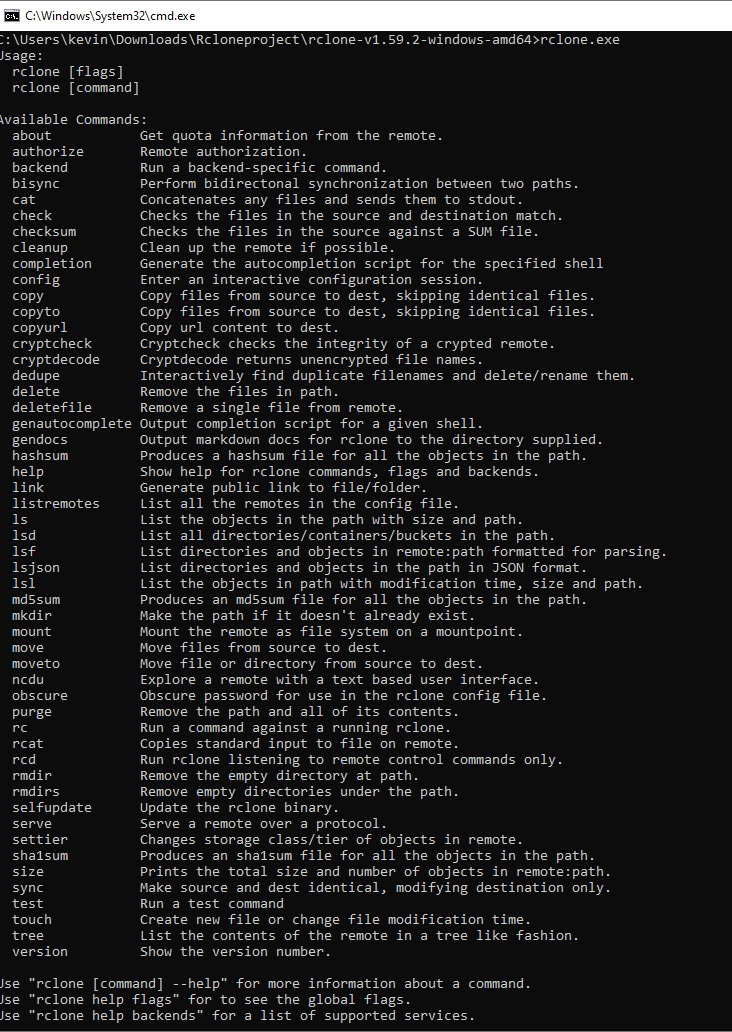

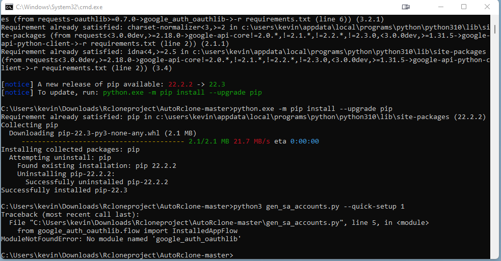

I now want to run the command to actually make the service accounts. I mean this step:

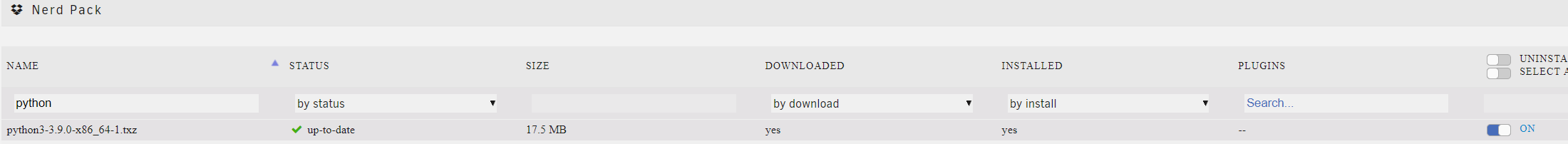

But for some reason, the cmd screen says that Python is not installed. I then installed it again from the Microsoft store (even though it was already installed) but now it gives me this error: image.png.66540e965fb8e906016b27efcebd8567.png
I do not understand what goes wrong here, since I did run this image.png.573e2ab3f32d3ba120a9b2eb9d2916e3.png command multiple times. Do you know what is going wrong here?
EDIT: I have given up. I just need something simple and I think this might be to much for me at the moment. I will just deal with the 750GB limt.

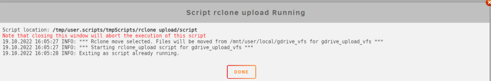

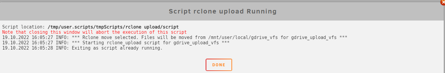

I have a problem with the upload script. It no longer seems to do anything.
This is the script:

No matter what I try, it doesn't want to start. It keeps saying that it is already running, but there are no logs showing that it is running.
I tried removing all rclone scripts and copying new ones from the Github page, but even after a reboot, I keep getting the message that it is already running, even though it hasn't been started before.
Go to your mnt/appdata/other/rclone/remotes/XXyour-remote-nameXX/ folder and you should see a daily_upload_running file there. Delete it and start the script again. It's a checker file like mountcheck, but doesn't get deleted on shutdowns and such. So the script will think it's already running, but with a manual delete it will run again.

There is an unmount script that cleans everything up that most people run at array start.
The unmount script tidies this all up at array start

I have given up trying to get the 100 Service Accounts to work, but is it possible to manually create 2 or 3? My whole problem is that I have no idea how to use Python and it keeps giving me weird error, but if I can manually make a few accounts, then I would be happy.
If this is possible, how do I do this? Just add a few of my other Google accounts to the shared drive? Then create the accounts file myself that Python would normally do for me? How would that file look like?
3 hours ago, workermaster said:
Quick question.

I followed this link to try and add Python to the Windows path. My system looks a little different since I am using Windows 11, but I think that I managed to do what they asked.
https://phoenixnap.com/kb/how-to-install-python-3-windows
Do I even need to use the Python console? It seems that every command can be ran from the CMD.
I then went back to the 4 steps to create service accounts. I am at step 2:
But when I run that command, I still get this error:
I have no idea how to troubleshoot this. Do you, or anyone else, know how to fix this, or help me with creating the file manually?
EDIT: Could it be that you need to install rclone for creating the service accounts? One of the first steps mentions that you need to install it, but I skipped that since I have rclone running on Unraid and thought that was enough. Is it needed to install rclone on Windows in order to create the service accounts?

I have no programming knowledge, so to me, the missing module error I get in the post above, looks like it has someting to do with the script I am trying to execute, and not with the Python installation. That makes it impossible for me to Google what is going wrong, and since I can't read code, I am stuck.
Try installing google-auth-oauthlib:
pip install google-auth-oauthlib
I tried that, but it made no difference. It seems to be installed, but for some reason, is not usable.
It literally says in step 1 that you need to install rclone..... And did you activate the Drive API and get your credentials.json?
I downloaded rclone, but it seems to not be a program that is installed. I see no installer, but only a .exe that tells me to access it from a cmd screen.
Starting it from a cmd screen also does not give me the option to install it:
Do I have the wrong rclone here?

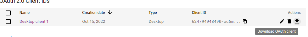

I do have a credentials file. Got it from here after enabling the api:
Then renamed that file and it is in the project folder:
Edited by workermaster
In the meantime, I have tried to copy all rclone files into the project folder and run the python3 gen_sa_accounts.py --quick-setup -1 command. It did not work and gave me the same module error.
I then tried moving all files in the project folder into the Python installation folder, to rule out any problems with the Windows path. Still the same error.
Then I tried to run step 1 and 2 again from github: https://github.com/xyou365/AutoRclone to make sure that I did everything right. I could not find a mistake anywhere. When I run the last confirmation step for the api, it doesn't ask me to login, but shows me a long string of letters and numbers in de console, but the website mentions that you only have to login the first time. As far as I can tell, everything should be setup correctly.
This leaves me with the idea that the problem is with the rclone install, since the rclone I have, seems to be a portible one and not one that you need to install. But I did get it from the link in the manual (https://rclone.org/downloads/), so that should be the correct one.

Why don't you just do this from your Unraid box and use the terminal? Windows complicates stuff. You can get python 3 from the community store. Then just get a folder where you dump all the files in and use "cd /path/to/folder" to get to that folder and execute from there.
I didn't know I could do that. I am going to try that in a moment.
EDIT:
Trying to run this now. I couldn't find a Python download in the community apps, but then remembered that the nerdpack could have it. I enabled and installed it there:image.thumb.png.2737f91242ceca034aadbd5559ad95bd.png
I also moved the project from my windows PC to Disk 1 on the server.
But I have no idea how to run the code image.png.422ce8883056e5fc93d3afa7f8279c1d.png
(I know the directory is not correct in the above screenshot, but it doesn't even find the Python commands)
I have never ran anything like this on the Unraid console before, so sorry if I make obvious mistakes.
Should the above be enough to work, or should I run these commands in Unraid:
EDIT2:
I have figured out that I can do this;
to start Python. I am now in the project folder, but can't run the needed commands:
I now have to figure out how to get pip working
Right. I got pip working (just had to install it in the nerdpack)
I am now getting a lot of errors while running the image.png.3ff3ec3590914813665733a28cecda8b.png command. I didn't get these before on Windows. What could be wrong here?
