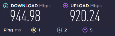

On 12/16/2022 at 8:22 PM, hohoho said:
Hi
I´m having problem with my plex(rclone) server.
All my local files run without a problem and I can keep over 10 concurrent streams.
I am using sharepoint(OneDrive?) to stream media from(rclone).
Everything runs smoothly and I can stream movies when im using Plex.
I want family and friends to be able to use my server.
My problem is that when I open more streams (because i´m testing) then it starts buffering(and basicly freezing) if I try to stream more than one movie at a time(possibly two).
This is my current mount settings:
mount Crypt: R: --volname \rclone\crypt --use-mmap --cache-dir "E:\rclonecach" --vfs-cache-max-size 200G --dir-cache-time 1000h --vfs-cache-mode full --tpslimit 10 --rc --rc-web-gui --rc-user=XXX --rc-pass=XXXX --rc-serve --log-level INFO --log-file=mylogfile.txt
Can you imagine what I am doing wrong and why this keeps happening ?
I have 1gig upload and downoload

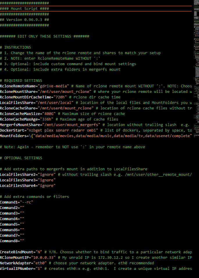

Hello Everyone,
I can sure use a bit of help. I am new to unraid just installed it last night, still learning it.
I am trying to to get my gdrive mounted but I am failing miserably at it. I follwed the direction on the main page but I still can't seem to get it to mount.
I also don't get a log file in /tmp/user.scripts/tmpScripts/rclone_mount. Also when I try to go to my gdrive mount directory I get an error: /mnt/user/mount_rclone# cd gdrive-media bash: cd: gdrive-media: Transport endpoint is not connected
gdrive-media is my remote name I don't use crypt. Any help would be appreciated
Thank you!
