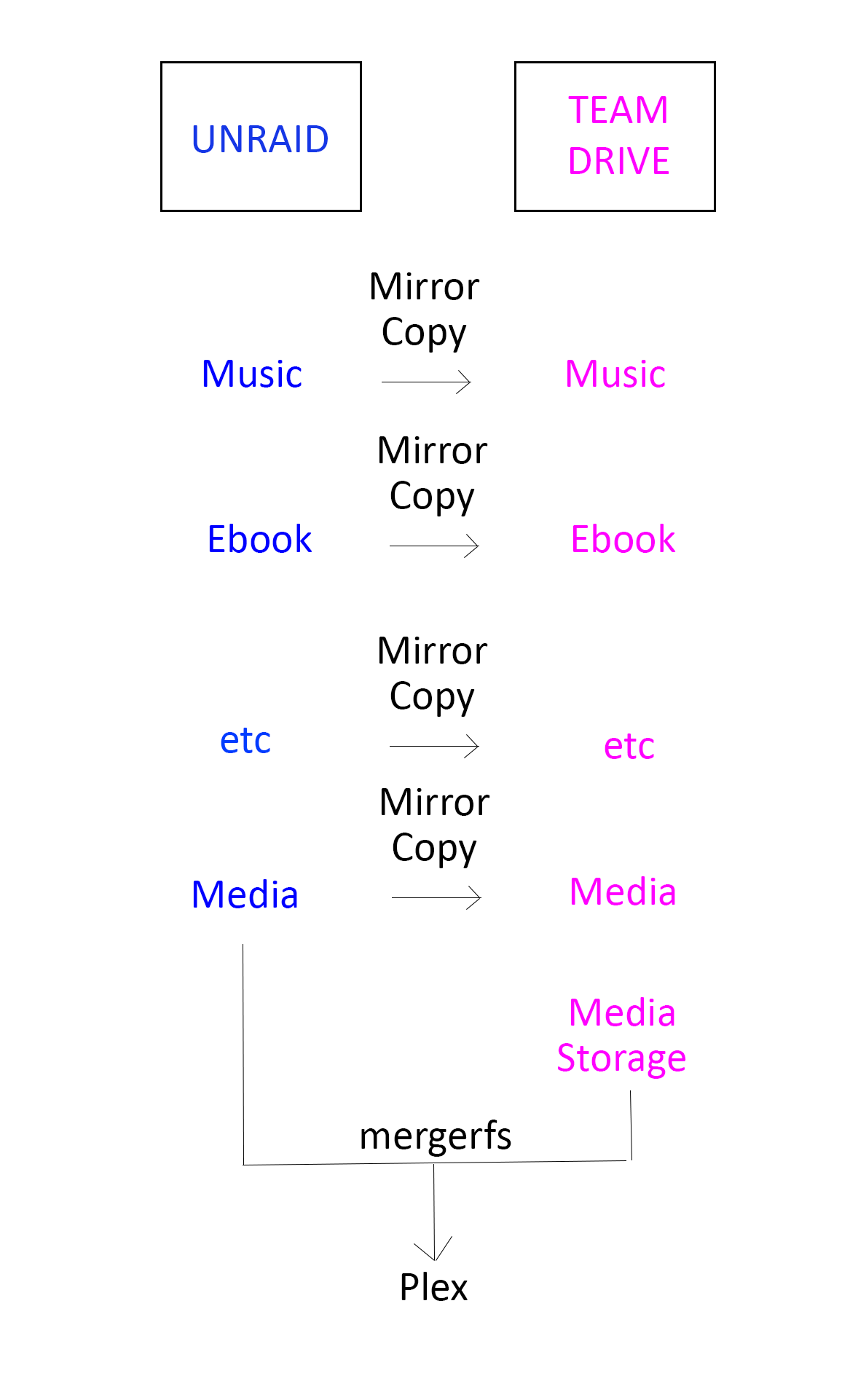

Hi, first of all I wanted to thank you for your work. I'm a newbie to unraid, scripts, etc .. but I would like to try using your script to mount my team share drives.
I'll explain what I would like to do:
On Google drive I have different team shares.
Of these only the "media_storage" drive is the one I would like to use on Plex with mergefs for the stream, joined to my local library.
Also on this drive I would like to periodically upload the files present in a folder and remove them after uploading.
The other drives, on the other hand, must not be used on Plex, so I don't need mergerfs but only mounts and mirror synchronization with the source.
1) How should I set up the script? Do I have to create one for each team share?
2) in the Mount script what is meant by LocalFilesShare? is the folder of local files that will be merged into the share?
3) in the upload script for a mirror copy I have to select sync right?
sorry for the stupid questions

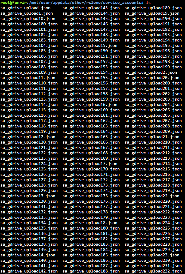

@DZMMHi
Im hitting a snag when i try to mount my gdrive:
Failed to create file system for "gdrive:": drive: failed when making oauth client: error opening service account credentials file: open /mnt/user/appdata/other/rclone/service_accounts/sa_gdrive.json: no such file or directory
but i do have my service accounts in the path:
am i missing something here, i had it working, did a restart and now this.
