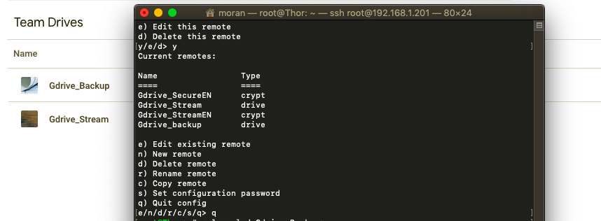

This is where I am at so far. Ready to make the Mount/unmount    each Team drive has a folder in it called Secure where I want the files to go, I specified that when I made the Encrypt path
Gdrive_Backup & Gdrive_SecureEN (Encrypted folder)  is one Team drive
Gdrive_Stream & Gdrive_StreamEN (Encrypted Folder is other Team Drive

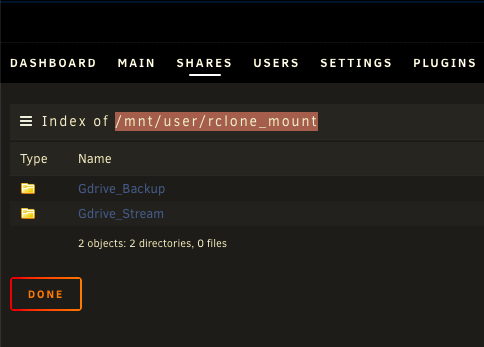

here is the share I made

Please post your rclone config here. Make sure you delete any info like client id
[Gdrive_Backup]
type = drive
scope = drive
token = (removed)
team_drive = (removed)
[Gdrive_SecureEN]
type = crypt
remote = Gdrive_Backup:Secure
filename_encryption = standard
directory_name_encryption = true
password = (removed)
password2 = (removed)
[Gdrive_Stream]
type = drive
scope = drive
token = (removed)
[Gdrive_StreamEN]
type = crypt
remote = Gdrive_StreamEN:Secure
this is what was built from putting the info in through SSH
