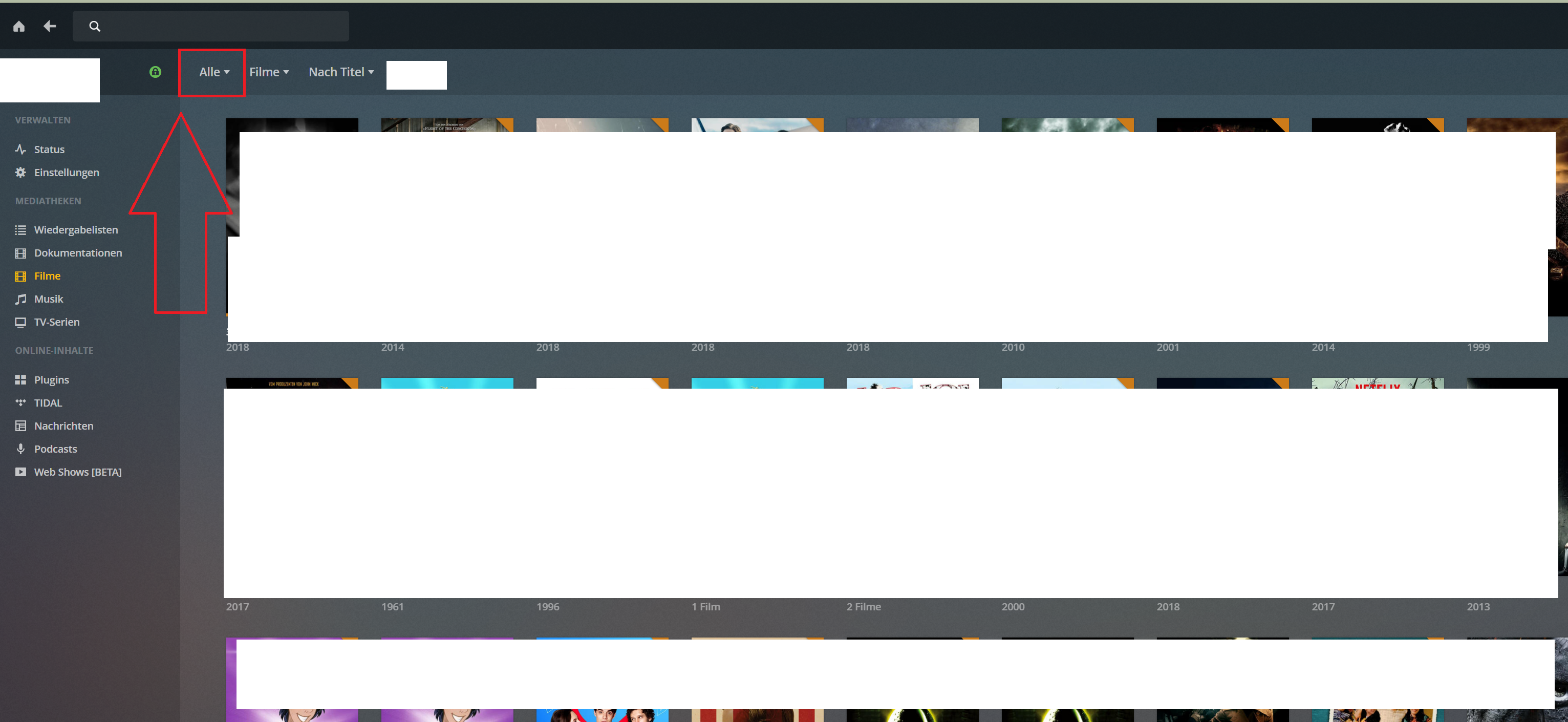

If all your paths are correct... and if u can see it in krusader, then plex also must see it. Did you click on something here, you need to select all.

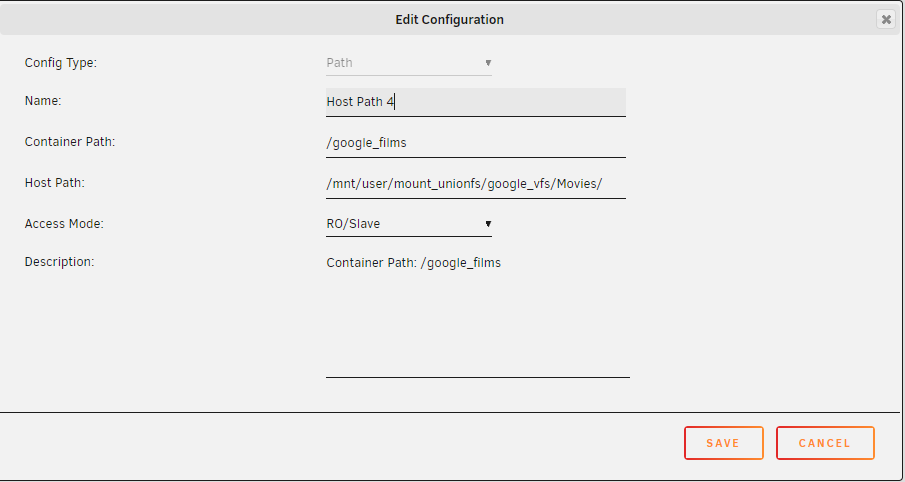

can you tell me if its correct ?
Captokure.PNG.7559d40cdb7ecd7506e371d3097147f2.PNGCapture.PNG.00369ad9b19bf0fc998ad9b3a8d57922.PNG
You only need to add mount_unionfs/google_vfs to your docker template. I add mount_unionfs/ as R/W slave myself so it has access to all my folders. Then in Plex you create a library based on mount_unionfs/google_vfs/Movies.

I did what you told me and plex seem to like that.
plex has scan 2100 movies so its good and it continues
thx for help
