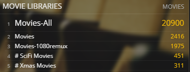

Yes, near instant. But quick enough. How big is big?
lol that's insane.  I might have to share servers with you to get some inspiration to beef up my library 🙂
