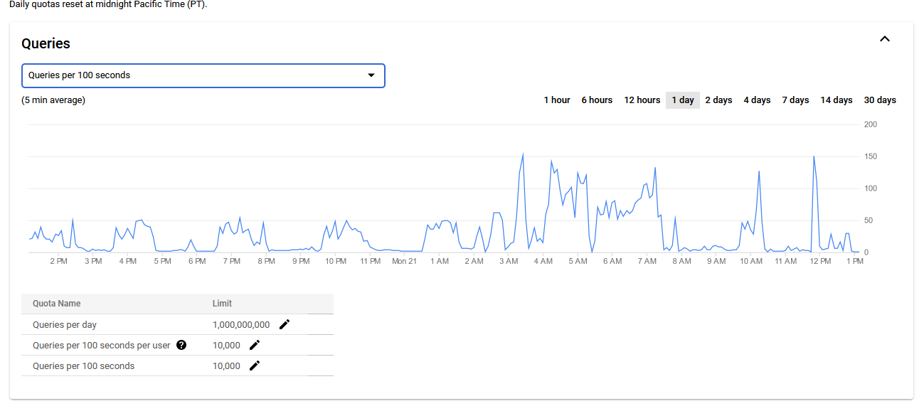

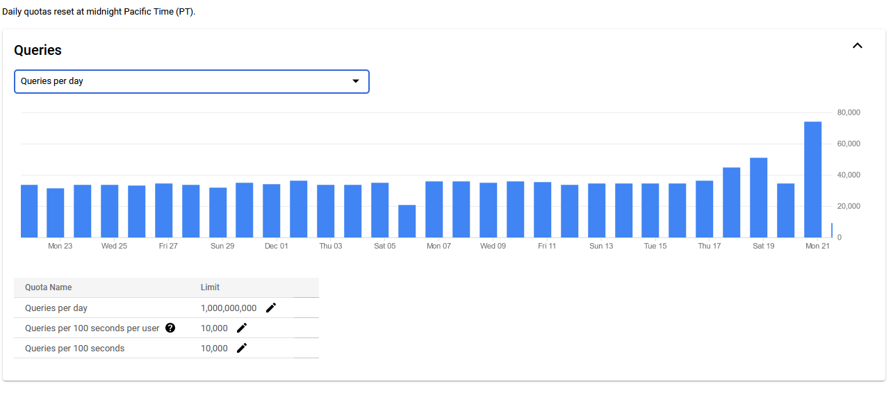

So it seems I've bit hit with a ban - "Error 403: The download quota for this file has been exceeded., downloadQuotaExceeded" when trying to acess my files although I can't figure out why exactly.
Looking at the Quota stats on https://console.developers.google.com/apis/api/drive.googleapis.com/quotas I don't see me even getting close to the quota. I've also tried creating a new client id/secret to by-pass this, but I'm still getting the same error back.
I also have a completely different Team Drive using different credentials, and that seems to have been hit with a ban as well.
Any ideas?
Edited by teh0wner
