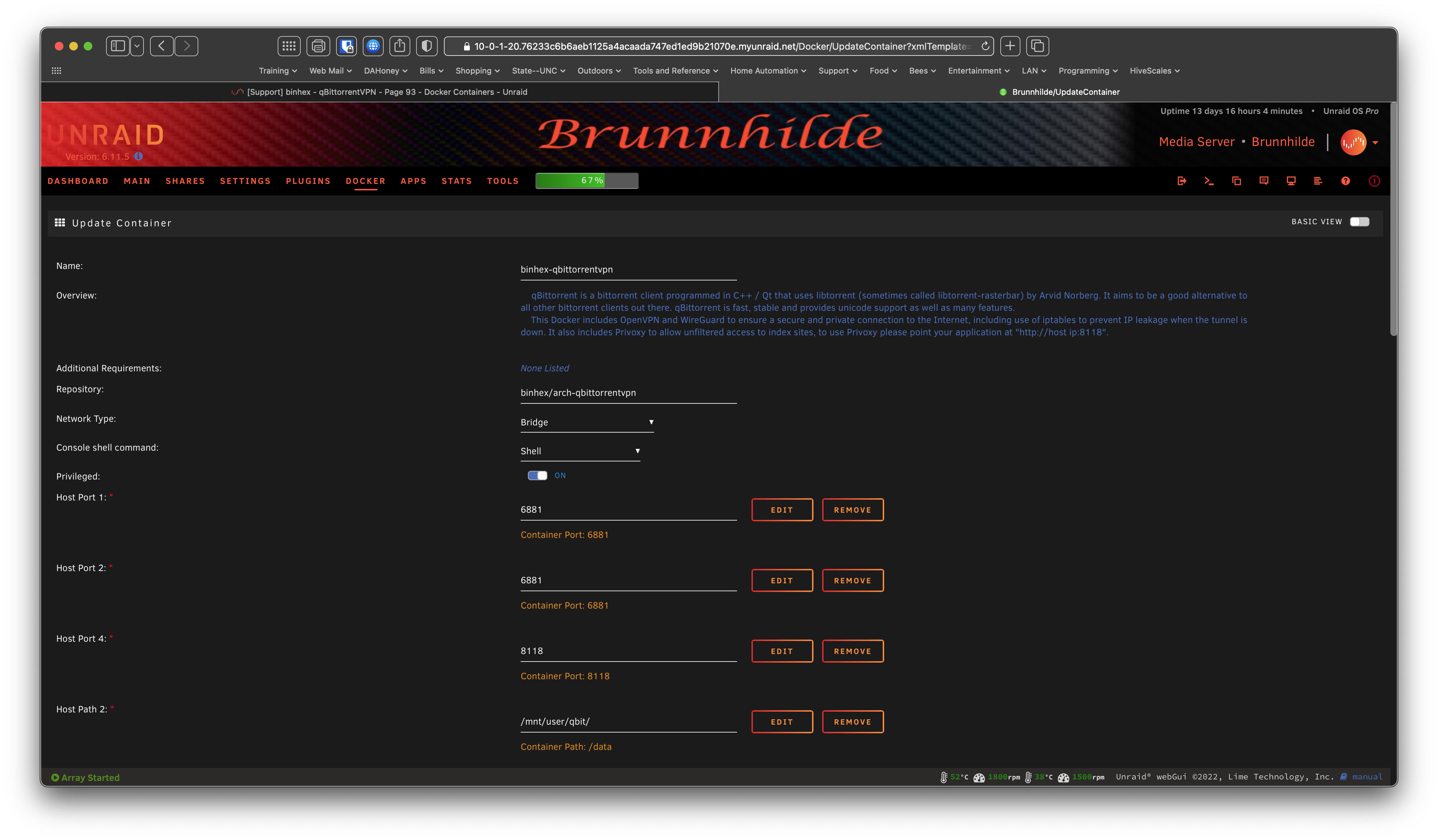

Can anyone tell me why I can't access webui?  Everything seems to be loading fine, log attached.

I too have trouble accessing the GUI.
The VPN worked, but it stopped in the meantime.
Here is the config for the container:
docker run
  -d
  --name='binhex-qbittorrentvpn'
  --net='swagproxy'
  --ip='172.18.0.55'
  --privileged=true
  -e TZ="Europe/Budapest"

8 hours ago, Forty Two said:
If anybody has ideas, let me know.
You have the webUI set to 8116 but host port 8116 set to container port 8080. It needs to be set to 8116:8116.
-p '8116:8080/tcp'
Thanks!
I don't have that option in the gui? How would I go about changing that setting?
6 minutes ago, Forty Two said:
Thanks!
Assuming you are running this docker on unraid, go to the docker tab and click the name of this docker to view/edit the configuration.
14265538_Screenshot2023-01-02at11_33_50AM.thumb.png.b69b789f4b735a2ac69a8b77271ec7f6.png
Find the entry for that port (on mine it’s host port 3) and delete it.
Select add a new path at the bottom of the page. Set config type to port. Name can be whatever you want. Host Port and Container Port should both match webui port (8116). Description and Default value are optional. Connection type will be TCP.
Click “Save” and then “Apply”.
