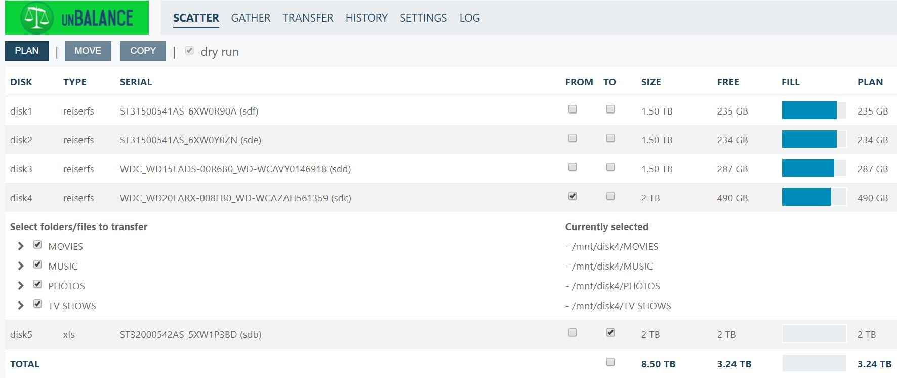

One more question though: how do I copy from 1 disk to another one? Is it done thru the GUI? Do i need a specific plugin?
Either command line rsync at the local console or ssh /telnet with screen, or the unbalance plugin. There are more ways to accomplish it, but those are probably the most efficient.
OK, I will have to look at how the unBALANCE plugin works exactly....
Thanks for all your support
OK, so do I just select "from" (D4-2TB and select all the shares) and then select "to" (D5-2TB), then click on Plan?
And if there is no issue detected, I can unselect "dry run" and click on "Move"?
Edited by French-Guy
You can move if you wish, but I prefer copy as it's much faster, and you are going to be totally erasing the source drive by formatting it anyway. Just make sure there are no docker or network writes to the drives you are operating on. Reads are fine, but will slow the process a little.
ok, so let's go with a "copy" then.....I'll keep you posted

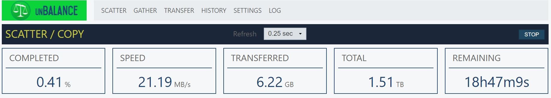

Ouch....................it says ~19 hrs
Speed is ~20 MB/s !
Is the array available anyway for streaming?

Good morning.............................5 hours before completion 😕
You said "Copy" was much faster? I can't imagine if I had selected "Move"
Unless I have a problem somewhere???

Not obviously a problem, but no way to know without diagnostics.
i see both data drives are blinking, but also the parity drive
Does the parity drive need to be involved during the copy, or could it be "deactivated" to do the copy faster?
Unraid parity is realtime and all write operations (write, delete, format are all write operations) update parity simultaneously. This is why Unraid writes slower than the speed of a simple disk write.
It would be possible to remove parity and then rebuild parity afterwards, but that isn't really going to buy you much because then you have to wait for parity to completely rebuild.
Large volumes of data just take a while even if things are working correctly. And as mentioned, without diagnostics, we can't say for sure if things are working correctly.
