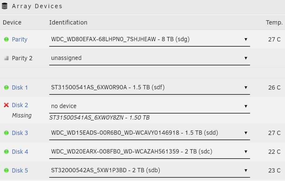

Server was ON, and array stopped - Status is as shown on the picture, with Disk 2 being unassigned368504342_Capture1.JPG.af11090afbb23cd87de5ac373c7e7e97.JPG
Should I just re-assign it and start the array?

Looks like the array was never started with disk2 unassigned? I'm not sure what the OP was trying to do preclearing an assigned disk.
I was trying to preclear Disk2 after I copied it into Disk4 and formatted it as xfs .....Like I said, I wanted to see what the preclear would report in terms of error
So I stopped the array, unassigned Disk2 and selected the Preclear plugin, and realized the issue 2TB vs 1.5TB.......and this is when I started to bother all of you with my questions 🙄🙄🙄
And it's very possible I never tried to re-start the array with Disk 2 un-assigned
So should I just re-assign it and start the array?
I want to make a copy of my pictures on an external USB drive asap, and after that  keep bothering you with other questions about replacing  Disk 2 and 3 when I will have my 4TB drive
And again, thank you very much for your help....
You can't preclear an array drive, even if temporarily unassigned or you will invalidate parity, just re-assign the disk and start the array.
ok, Disk2 was reassigned and array is started now......Will make a backup of all my pictures !

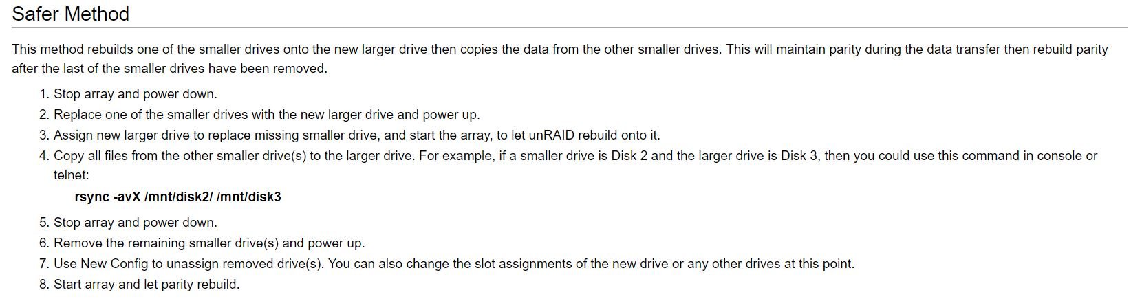

So as soon as I get my 4TB drive, what is my best option to replace Disk2 and Disk3?
I googled it and found this, but i'ts from 2016:
Is there any other (more recent?) way to do it?
For step 4, can I use unBALANCE plugin rather than rsync command?
Thanks
49 minutes ago, French-Guy said:
I "naively" thought once data from Disk2 were copied onto Disk4, it was ok to unassign and eventually remove Disk2........😮😮😮Looks like my brain is not 100% unRaid oriented yet ....
Thanks
That method is OK and you can use unbalance.
