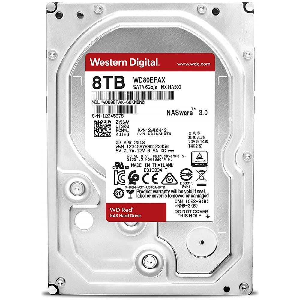

I didn't know that but I suppose it was inevitable as Toshiba and Seagate make air-filled 8 TB NAS drives. I found a photo.

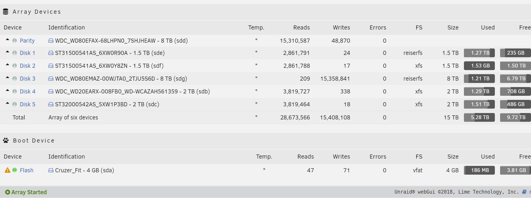

Looks like everything went well:
I will shut down the server for now, and look at it again tonight for the next step (New Config without Disk 2, or replace and rebuild Disk2)

In your screenshot I just noticed a yellow triangle next to your flash. What is that warning about?

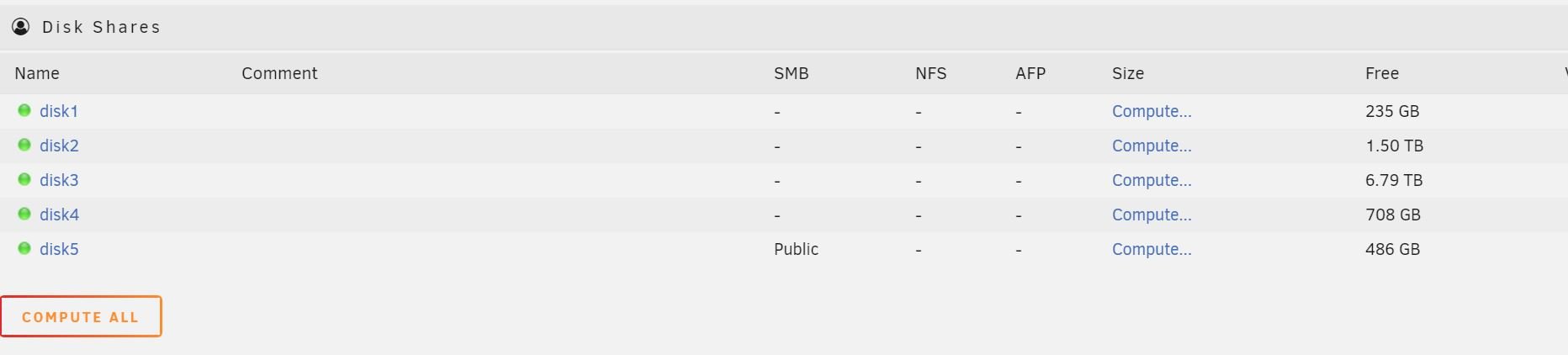

I think it's because it's "Public".............I need to change this. I see it (as well as Disk 5 by the way) on top of my Shares from my WD TV Live
Yes I just tried that with my flash and I get a warning too. I set mine to Export: Yes (Hidden) and the warning goes away. Hidden means you can't see it on the network but you can still access it by specifying its path.
Why are you sharing Disk 5? I recommend not sharing any disks and only have your user shares available on the network.
I didn't do anything specific about Disk 5. Looks like it set up like that when I installed it
I will have to fix this as well. But even if I see it with my shares, I know I don't want to access it anyway...

But in Shares, I see this......!

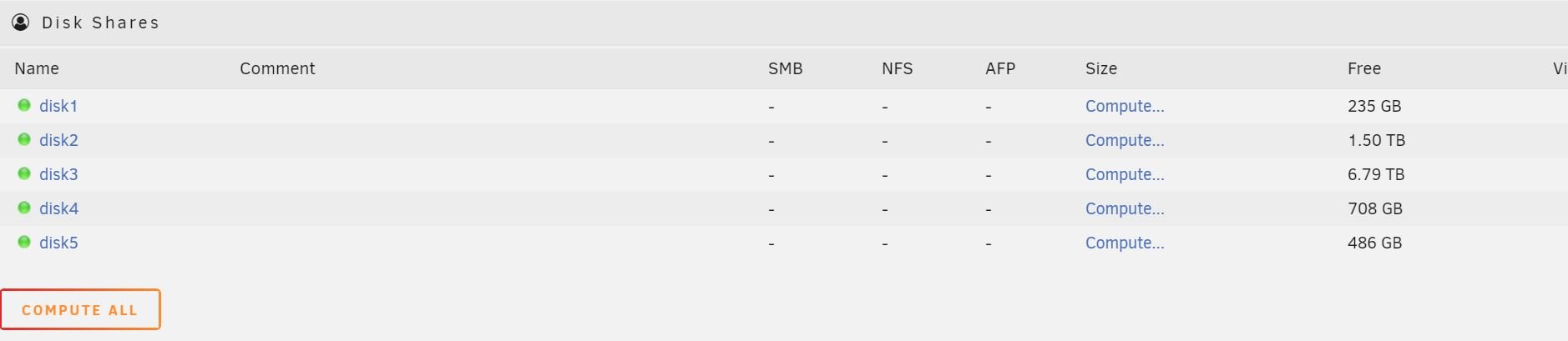

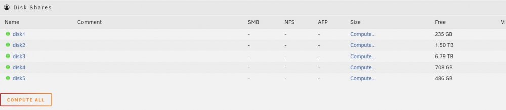

So I looked at the other Disks, and applied the same settings for Disk 5
I have this now:
So I assume I won't see it anymore on my WD TV Live......😊

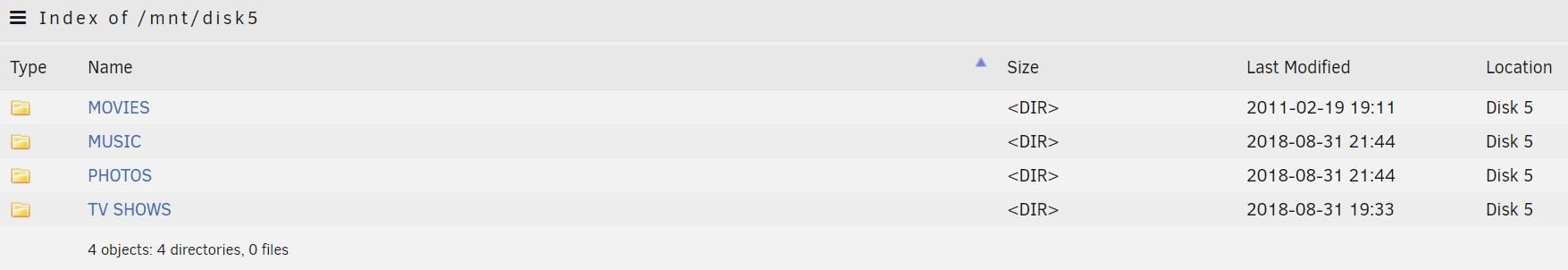

Does Disk5 actually have any folders on it? Top level folders on any disk is automatically a user share. I am just wondering if Disk5 was made shareable because it didn't have any folders (user shares) yet.

I've attached a screenshot showing folders on Disk5:
