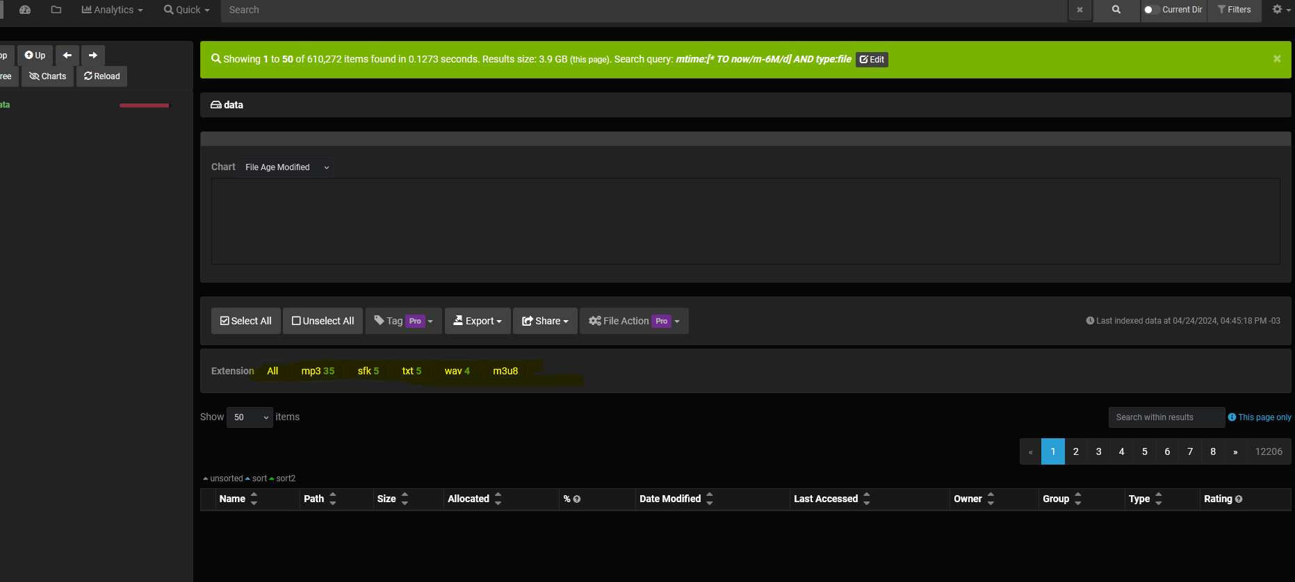

Hello guys!
I finally get the Diskover running on my unraid, i used to index my /music share.
Its working, but when i try to type anything on diskover search bar the result screen shows like this:
the files are there but not displayed, its a bug? or may be i did something wrong?
I am using the docker images from the APPs of Unraid.
All latest version.
When i search from the status page, the results appears but, if i click to browse the results, nothing happens like the above image...
Any help or tip are welcome!
Thanks in advance!
