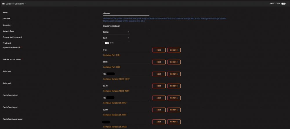

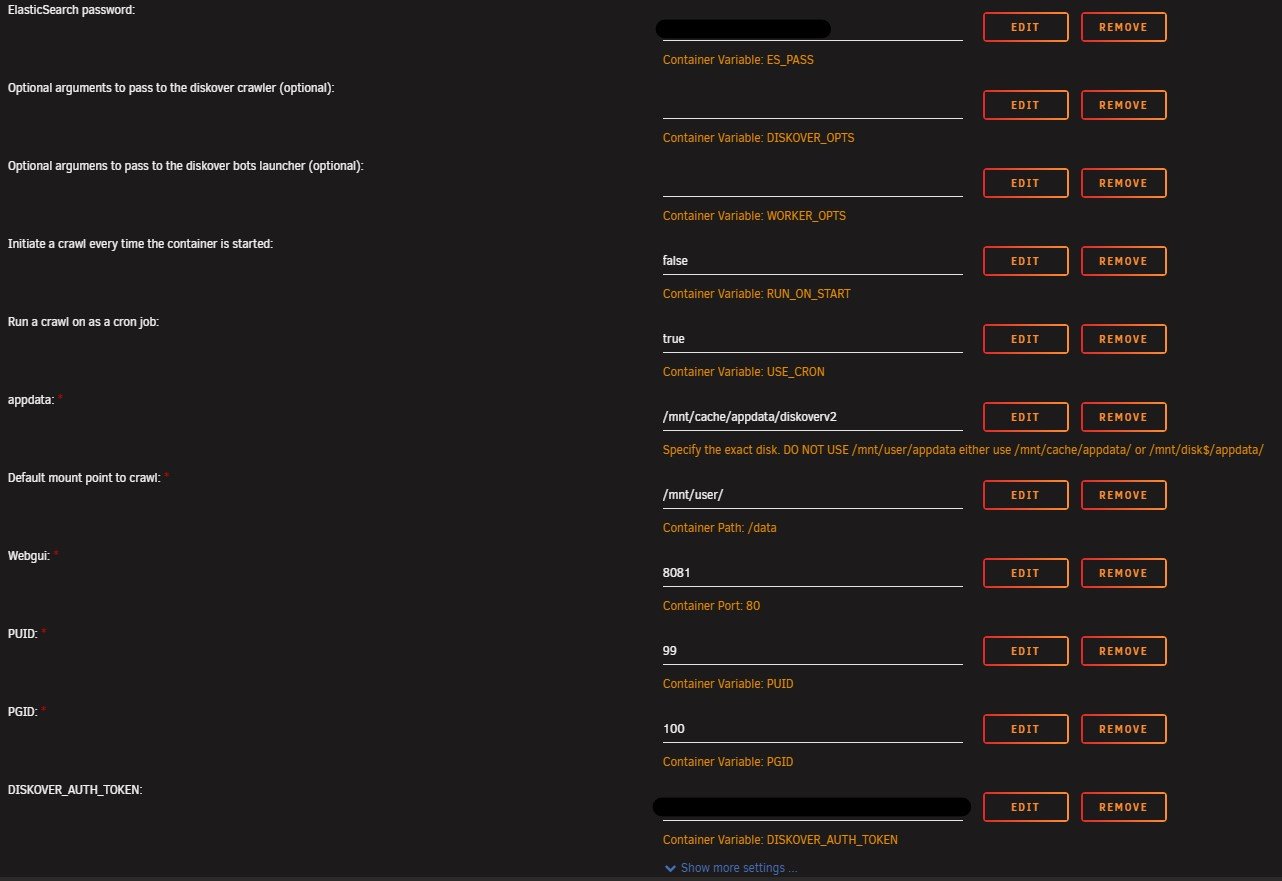

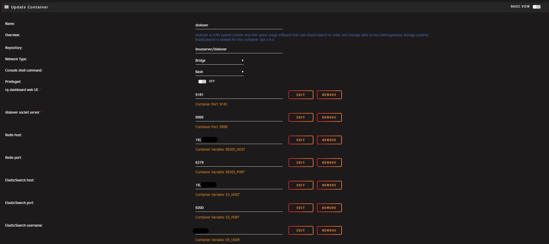

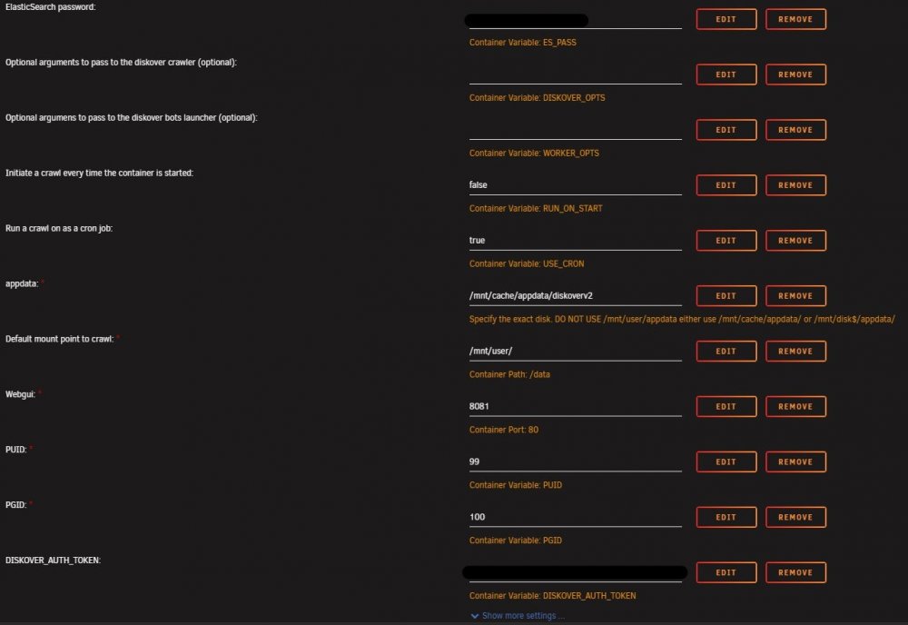

Here's my template for v1.x
I might need some help getting v2.x set up. I'd like to give it a go.
