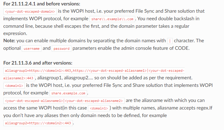

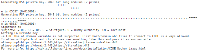

April 11, 20224 yr collabora/nextcloud office docs was working, after update log shows ERR: Use of domain variable is not supported. First host/domain who tries to connect to COOL is always allowed. To allow multiple host and its aliases use something like this and pass it as env variable: aliasgroup1=https://domain1:443,https://its-alias|its-second-alias:443 aliasgroup2=https://domain2:443,https://its-alias:443 https://sdk.collaboraonline.com/docs/installation/CODE_Docker_image.html looks like some changes on last update that affect the allowed domains/alliasnames -going back to previous version gets you back online (w/nextcloud no longer connecting to collabora server) -staying in latest and leaving "Container Variable: domain" empty starts the container (w/nextcloud 'Could not establish connection to the Collabora Online server.') anyone figured out the new required variable syntax, to get Collabora back up and running w/nextcloud? Edited April 11, 20224 yr by Tolete
April 11, 20224 yr 6 hours ago, Tolete said: collabora/nextcloud office docs was working, after update log shows ERR: Use of domain variable is not supported. First host/domain who tries to connect to COOL is always allowed. To allow multiple host and its aliases use something like this and pass it as env variable: aliasgroup1=https://domain1:443,https://its-alias|its-second-alias:443 aliasgroup2=https://domain2:443,https://its-alias:443 https://sdk.collaboraonline.com/docs/installation/CODE_Docker_image.html looks like some changes on last update that affect the allowed domains/alliasnames -going back to previous version gets you back online (w/nextcloud no longer connecting to collabora server) -staying in latest and leaving "Container Variable: domain" empty starts the container (w/nextcloud 'Could not establish connection to the Collabora Online server.') anyone figured out the new required variable syntax, to get Collabora back up and running w/nextcloud? I have the same problem. It's taken down my nextcloud instance as well! I would have expected Nextcloud to still function is Collabora cannot start. Any ideas?

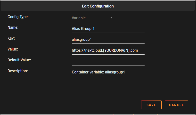

September 29, 20224 yr On 9/26/2022 at 9:13 PM, lilfade said: Had the issue of not being able to open anything and the web ui not working. Made the associated changes for the nginx in my swag container, deleted collabora container and image, reinstalled from the app store (no domain needed as it's now setup as "first come, first serve" and bam... documents are opening again. did you configure the aliasgroup1 variable?
October 7, 20224 yr On 9/29/2022 at 2:53 PM, UnKwicks said: did you configure the aliasgroup1 variable? no, i left em all off as the *new updated* container recommends. As far as i can tell, you only need the alias if your working with multiple domains, if you only have one domain dont add alias or domains, just remove them and it should work as it should.

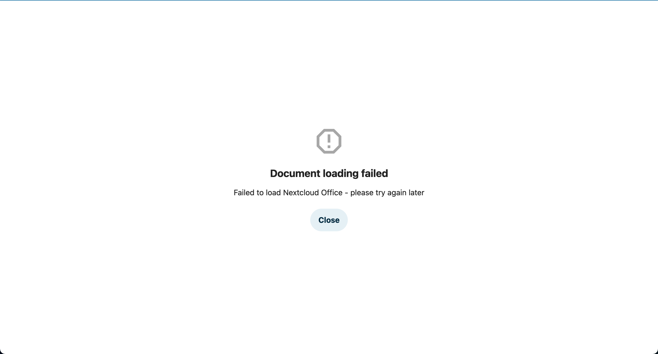

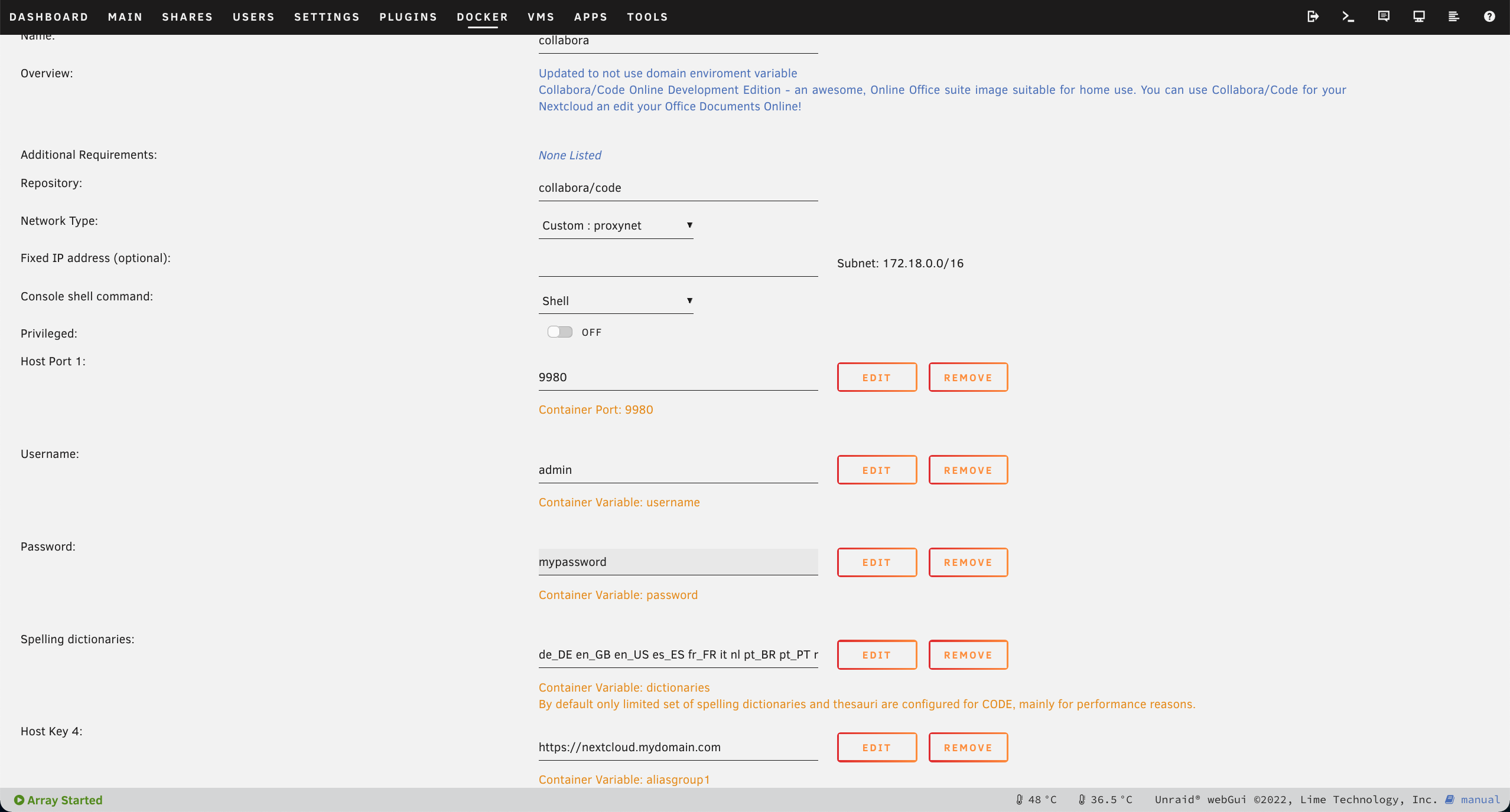

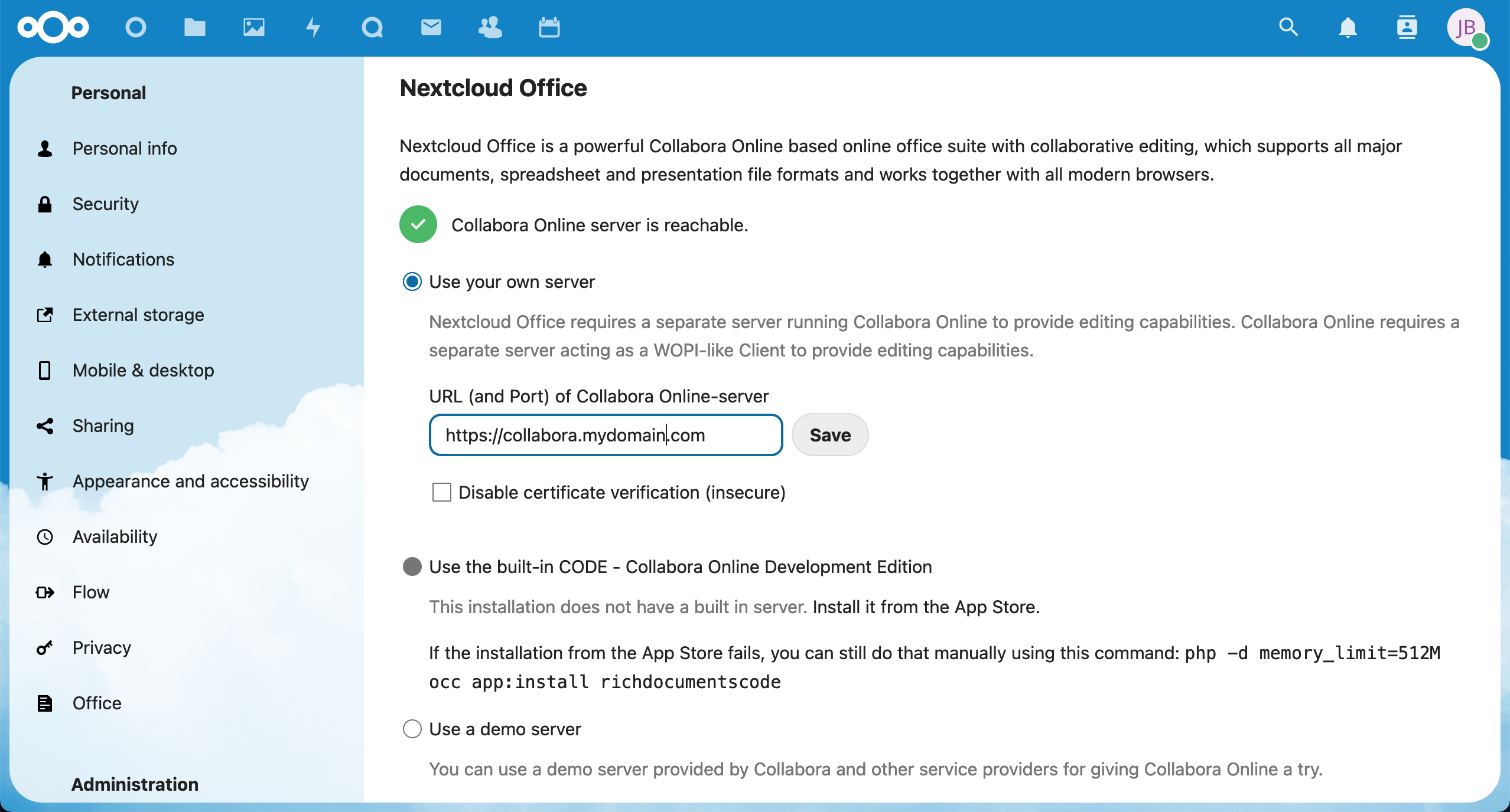

July 5, 20233 yr @ramair02 I wonder how you got this working. I added the aliasgroup1 variable like you recommended. I am on unraid 6.11.5 currently, running SWAG, nextcloud, and mariaDB setup and of course trying to use the collabora app with nextcloud now for online document editing and just having no luck. I will attach my collabora.subdomain.conf file, and screenshots of my setup. I get a green checkmark in nextcloud, but when I load documents it fails every time. Here also is the collabora logs with errors. I have tried to follow multiple guides with no luck. I can provide any more info on my setup as needed. wsd-00001-00001 2023-07-05 14:12:00.194834 -0700 [ coolwsd ] INF WSD initialization complete: setting log-level to [warning] as configured.| wsd/COOLWSD.cpp:5700 Ready to accept connections on port 9980. wsd-00001-00042 2023-07-05 14:12:11.870016 -0700 [ websrv_poll ] WRN convert-to: Requesting address is denied: [my public IP]| wsd/COOLWSD.cpp:3793 wsd-00001-00042 2023-07-05 14:12:20.640023 -0700 [ websrv_poll ] ERR unknown UI default's component UITheme| wsd/FileServerUtil.cpp:99 collabora.subdomain.conf
