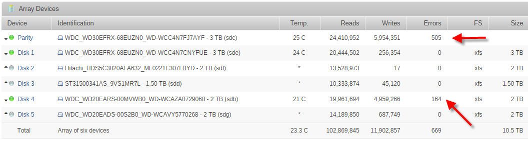

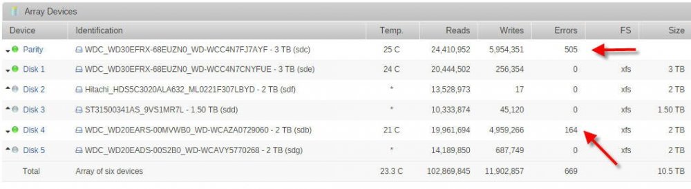

Drive failed again but now with party drive errors

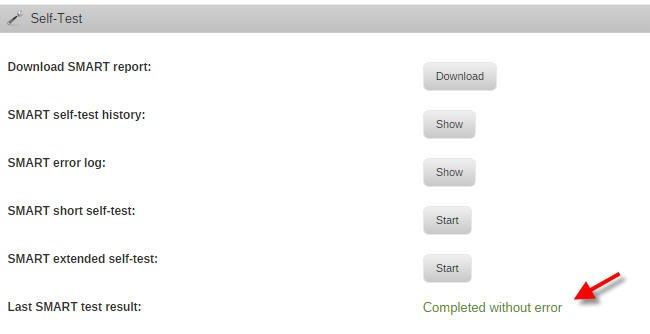

)I posted for support help a while back for one drive (drive 4) and the solution was to swap cables. That seemed to help but now i am getting errors on same drive and now on parity drive after i run parity check. I swapped cables to both drives but it did not seem to help. I run SMARTs test but it seem to complete without errors
(Last SMART test result: Completed without error)
Was it an Extended test you ran?

"Are these parity sync errors reported at the end of parity check? Or are you talking about numbers in the Errors column on Main?"
Yes i see errors on Main screen after i run by weekly Parity Check
"Was it an Extended test you ran?"
Yes i run extended but both showing completed without errors. a bit confusing as in logs i see read errors.

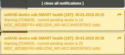

started preclear and right of the start i see the following in the logs and SMART 197?
Does these error means drive is bad?

Pending sectors is a case where I think preclear is useful. You need to try to get the pending reallocated. You can either try preclearing the disk until the pending sectors go to zero or just RMA the disk.

That disk needs to be replaced:
ID# ATTRIBUTE_NAME          FLAG     VALUE WORST THRESH TYPE      UPDATED  WHEN_FAILED RAW_VALUE
  1 Raw_Read_Error_Rate     0x002f   129   001   051    Pre-fail  Always   In_the_past 845
197 Current_Pending_Sector  0x0032   200   200   000    Old_age   Always       -       47
That's not a cable related problem, it also wasn't the board, it's likely just a bad disk, though in some rare cases a bad PSU can damage disks.
