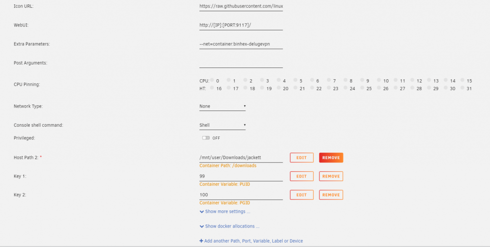

Just tried with Jackett and still the same problem, I am obviously missing something but have watched the video 3 times and tried various dockers but always the same?

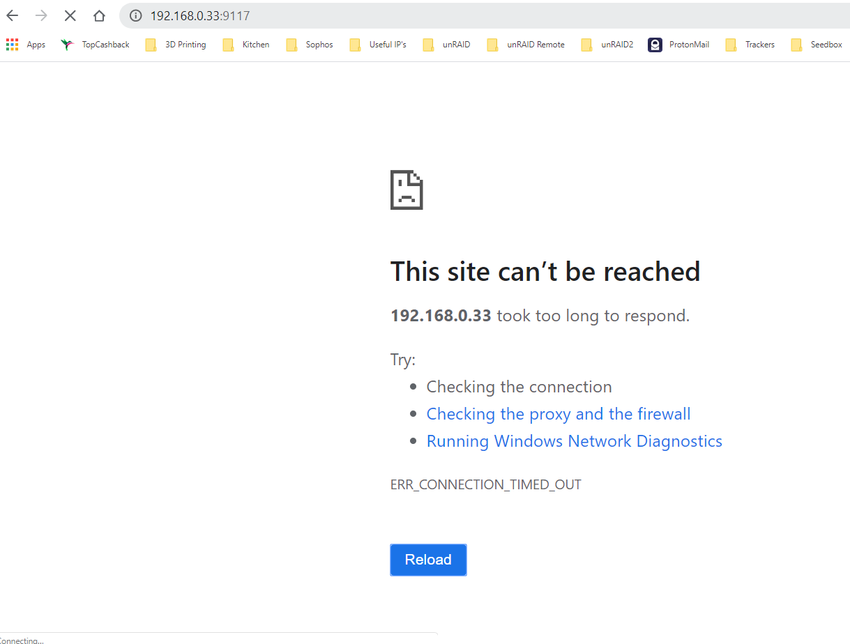

I can confirm (like others that cannot get this working) that each docker I try is using the vpn tunnel but I just cannot access the webui of each docker
Edited by mbc0
And just to confirm, your unRAID IP is 192.168.0.33 and you are using v6.8.3?

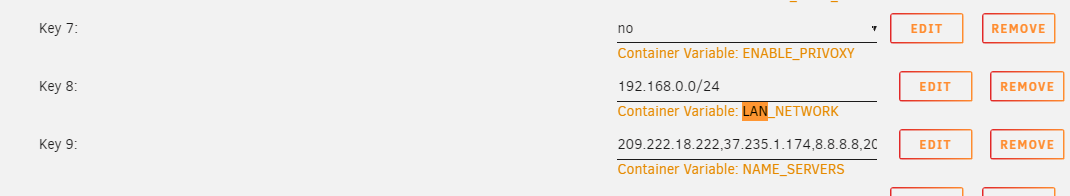

What is lan_network set to, if this isn't defined correctly then it will block.

Hey,
yes, unraid IP is 192.168.0.33
yes, V6.8.3
no ad blockers of any kind, tried accessing from 3 machines, as soon as I change back to bridge network, remove the extra params and the port entry in binhex-delugevpn I can access the webui again..
Sent from my CLT-L09 using Tapatalk
I have this set in your deluge docker

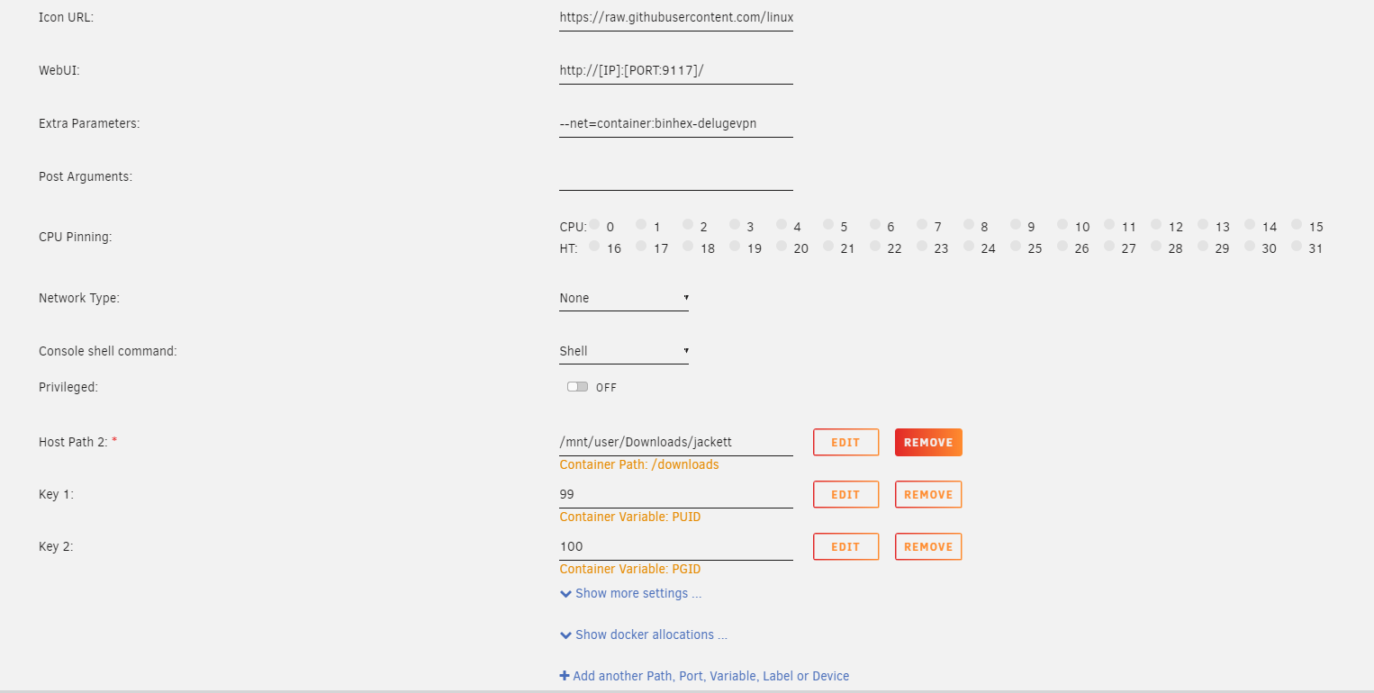

If you are on 6.8.x the "Extra Parameters" method of Docker networking won't work anymore. You need to create a customer Docker network from the UnRAID command line that is named the same as your VPN container, then remove the extra parameters from your Jackett etc. containers and set the network type to Custom: container:name-of-your-custom-network. Unless you intentionally changed the version of Docker you are using in the Docker settings, the default for UnRAID 8.6.3 should be Docker 19.03.05.
@SpaceInvaderOne says 6.8.3 or above? I am on 6.8.3

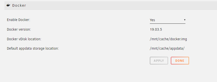

Can you also check your Docker settings? The Docker version changed at 6.8, your screenshots look like you might still be running an older version of Docker, which can be changed in the settings. Under Settings -> Docker it will show you the version you are using, which can only be changed when Docker is disabled.
Having the same problem accessing web UI, I am using the manually created "docker network create container:vpn" and not "--net=container:vpn" extra parameter on unRAID 6.8.3 with Docker version 19.03.5.
Have you tried @SpaceInvaderOne latest video method? I was under the impression that the "extra parameters" method didn't work beyond 6.7.x but he appears to be making it work on 6.9.0b1. Otherwise it appears like your setup is the same as mine and I don't see anything obvious that would be causing yours to not work. What I would check next I guess is the logs for the Jackett container to make sure it is actually starting up properly. If it isn't for some reason you will fail to reach it like what is happening.
Hi, all the dockers are starting, I can use the console to check the IP address and can confirm all working just no webui
am on 19.03.5 docker version as well

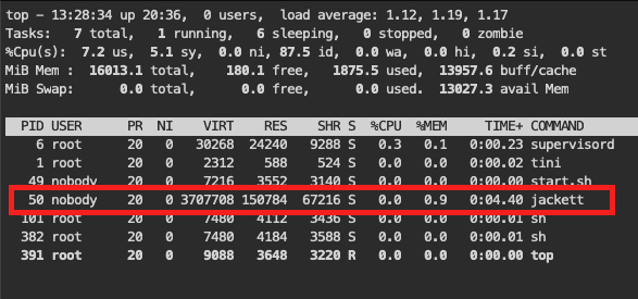

And what does the Jackett logs say, like IceNine451 suggested? It's possible for the container to start and use the delugevpn network, but the Jackett application itself might be having problems.
This is what my logs look like on a successful start:
2020-04-13 13:19:55,749 DEBG 'jackett' stdout output:
04-13 13:19:55 Info Jackett startup finished in 2.927 s
Hosting environment: Production
Content root path: /usr/lib/jackett/Content
Now listening on: http://[::]:9117
Application started. Press Ctrl+C to shut down.
And if you run top from the docker console, you should see jackett listed as a process

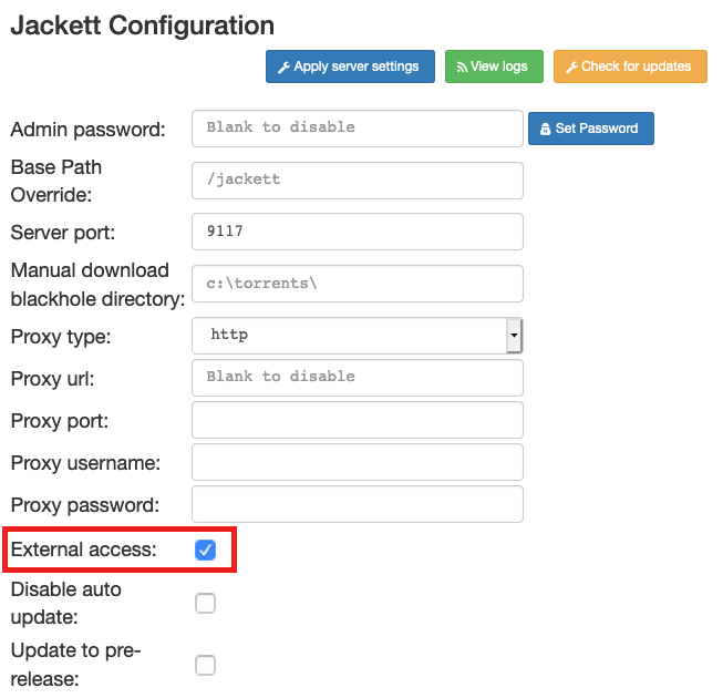

@mbc0 Jackett has a setting for allowing "External access". Not sure exactly what it does, but if I turn it off I can't get to the Web UI either when using the delugevpn network. If I turn it on the Web UI is accessible again.
If you can't get to the UI to change it, you can edit the config file directly in config/ServerConfig.json and restart the container.

ive figured it out, privoxy requires additional relaxed iptables in order to operate due to the proxying nature, thus if you do not have enable_privoxy set to yes then you wont be able to use delugevpn's network for other container, if you set privoxy to yes then this permits any LAN device access to the delugevpn network, thats why it works for SIO, as he must have enable_privoxy set to yes, and that is why it works with privoxyvpn (obviously privoxy enabled) :-).
so thats far from ideal, as you may not want or need privoxy but still want to route containers through the network, the better way to achieve this is to use the 'addtional_ports' env var mechanism that i have in place for sabnzbdvpn, and then you simply specify the ports you want to allow using this env var.
