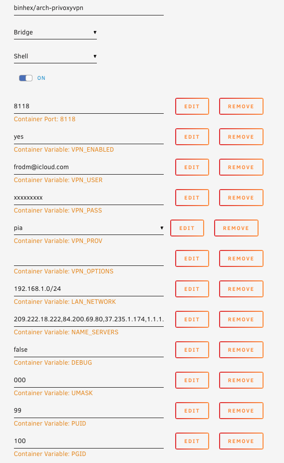

I am troubling getting the docker up and running. I have copied the crt and ovpn files from Vypr to the openvpn folder.
Happy for any ideas?
Cheers,
Frode
vpn.rtf

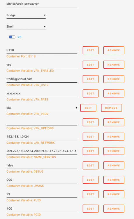

Cheers,
Frode
Up,,,,,,

I am sorry for asking but wondering if someone can help me out please?
I have the docker installed and it is running using my pia login.  I have made no other changes to the settings other than changing the port from 8118 to 8119 due to binhex-delugevpn
my end goal is to have my xteve iptv docker hidden through pia but I cannot find any instructions on how to do this? can anyone please point me in the right direction?
Thank you
Does xteve support http and/or socks proxy configuration? If it does then configure it to use privoxy or socks5 proxy

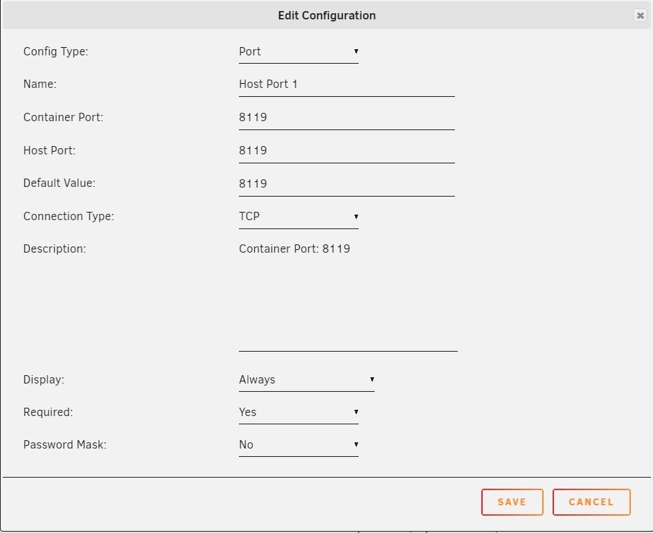

as I use your delugevpn docker, 8118 is already used, I have changed everything to 8119 but the log still shows 8118 being used (and obviously not working)
is there somewhere else I need to change to 8119?

do not change the container port this will always be 8118 and should not be changed and you will always see it in the log as 818 this is perfectly normal. The only port you should be changing is the host port and this can be changed safely
