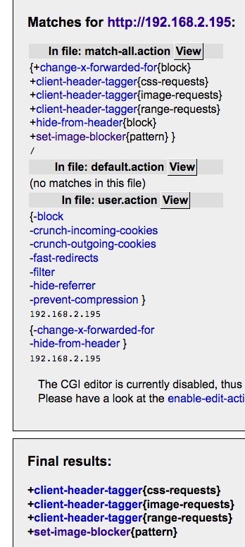

I`m having a problem getting the Privoxy to start correct. I think the log file says what`s wrong, but have to fix it?
2020-04-15 05:18:48,381 DEBG 'start-script' stdout output:
[info] Application does not require external IP address, skipping external IP address detection
Checking the ip thru Console with "curl ifconfig.io" showing vpn-ip.
Happy for any help.
/frode
Starting the GUI:
17553315_Screenshot2020-04-15at05_35_21.thumb.png.1a4a581a62cd1778ff13200e67cb1d91.png
no thats not a error, its simply stating that privoxy does not require detection of the external ip, which is true, unlike apps such as torrent clients which do.
the log above shows a successful start, can you attach the privoxy config file located at /config/privoxy/config
Thanks for clarifying.

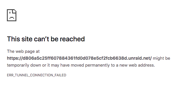

So normally when I access my unraid webUI 192.168.2.195 it just redirects to to the https://xxxx.unraid.net address as https is enabled on unraid - no issues.
However, when i set my devices to go through privoxyvpn, I can no longer access my Unraid Ui 192.168.2.195
does that make sense?

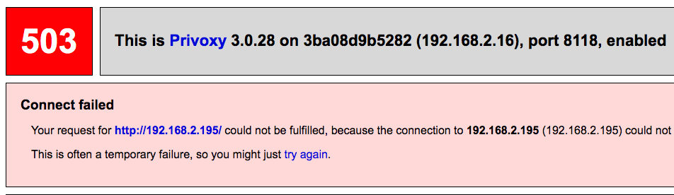

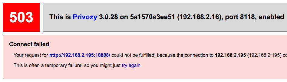

Well after hours of trying to solve this, I haven't had any success.
I have enabled logging, but only to show me failures and blocks etc.
When trying to access my UnRAID 192.168.2.195, the privoxy log shows this:
2020-04-25 15:43:30.225 7f3711fdb700 Actions: +client-header-tagger{css-requests} +client-header-tagger{image-requests} +client-header-tagger{range-requests} +set-image-blocker{pattern}
2020-04-25 15:43:33.326 7f3711fdb700 Actions: +client-header-tagger{css-requests} +client-header-tagger{image-requests} +client-header-tagger{range-requests} +set-image-blocker{pattern}
2020-04-25 15:43:33.326 7f3711fdb700 Crunch: Connection failure: http://192.168.2.195/
2020-04-25 15:43:33.516 7f3711fdb700 Actions: +change-x-forwarded-for{block} +client-header-tagger{css-requests} +client-header-tagger{image-requests} +client-header-tagger{range-requests} +hide-from-header{block} +set-image-blocker{pattern}
2020-04-25 15:43:33.516 7f3711fdb700 Crunch: CGI Call: config.privoxy.org:443

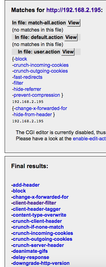

So from what I have been able to teach myself, this indicates the blocks should be coming from +change-x-forwarded-for{block} and +hide-from-header{block}
So I added the following to my user.actions file:
-change-x-forwarded-for{block} \
-hide-from-header{block} \
192.168.2.195
.unraid.net
Still no good.
Privoxy shows:
This would lead me to believe there should be no blocks happening - but still doesn't work.
So then I tried using the { fragile } action, which is meant to basically prevent any actions that would cause a site not to load, and I get.
Still can't load the site.

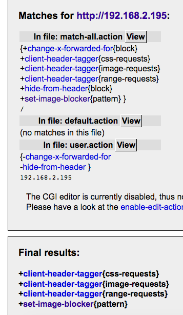

So then I went to the match-all.actions and basically disabled all the default actions.
When I do this, my log shows:
2020-04-25 15:53:44.245 7f3829ffb700 Actions:
2020-04-25 15:53:47.341 7f3829ffb700 Actions:
2020-04-25 15:53:47.341 7f3829ffb700 Crunch: Connection failure: http://192.168.2.195/
2020-04-25 15:53:47.507 7f3829ffb700 Actions:
So I am really at a loss now, no idea what to do from here.
Any thoughts?
