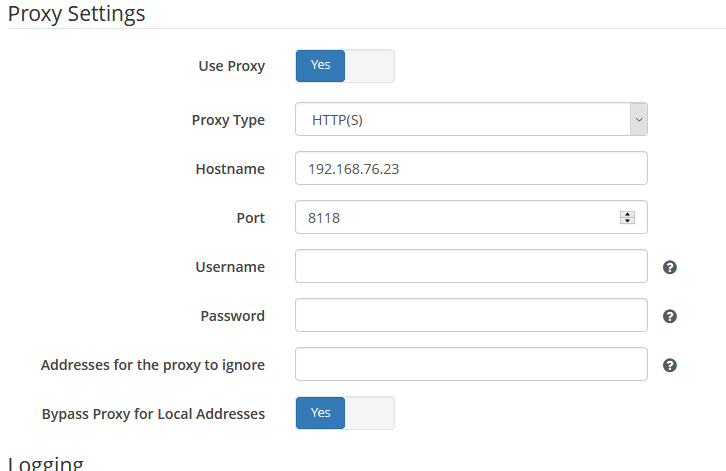

Can anyone help with why my Sonarr, Jackett and Radarr dockers don't seem to be passing traffic through PrivoxyVPN?
I have binhex-privoxyvpn configured to use PIA (Frankfurt) and it seems to be configured OK as when I use 'curl https://ipinfo.io' in its console it tells me that the IP is in Germany, which is what I expected...
My dockers are set to proxy via the local server IP and port 8118 (and they have been restarted since configuring)...
But when I try the same check from the Sonarr/Radarr/Jackett consoles it gives me my genuine static IP address...
However, when I proxy one of my Windows 10 VMs, to use privoxyvpn, it correctly identifies, in a web browser, that the endpoint is Germany, i.e. routing through PIA...
But when I visit https://www.privoxy.org/config/ it says that Privoxy is NOT being used (I have cleared cache)...
Am I missing something, there seems to be lots of conflicting information... are the dockers correctly routing through pivoxyvpn and mis-reporting their endpoints? If so, is there another way to prove all is working well?
Thanks in advance
im going to add this to the faq as its been asked a few times (in other vpn support threads), in short:-
QX. When i set my application (suchas Sonarr, Radarr, etc) to use Privoxy and do a curl/wget from within the container i see that my IP address is my ISP's assigned IP address and NOT the expected VPN provider IP address for the endpoint im connected to in Privoxy, why is this, is the VPN not working correctly?.
AX. A proxy server works at a application level NOT a system level, therefore when using command line tools like curl or wget these applications would need to be configured to use the proxy in order to correctly route through and show the VPN provider allocated IP address.
Whereas a VPN client works at the system level, thus all traffic is routed over the VPN tunnel, so using command line utilities such as curl or wget inside the VPN docker container (e.g. DelugeVPN, PrivoxyVPN, etc) WOULD correctly show the VPN allocated IP address.
Thanks in advance
The underlying OS of the dockers aren’t routing through privoxy, but the application itself is. So sonarr will go through the VPN, but the curl command from the OS level won’t.
Same in your VM. The browser is using privoxy as a proxy, but not windows itself.
You CAN configure both the VM and the dockers to use privoxy for all network traffic, but it’s not needed for the docker apps you mention as they have built-in proxy support.
Edit: Binhex explained it better :)
Many thanks Binhex - that makes a lot more sense... previously I was using DelugeVPN and within that docker's console curl https://ipconfig.co did show the VPN endpoint IP - now I am using Privoxyvpn on my local UnRaid machine as I have rTorrent on a seedbox... so thats why DelugeVPN showed the VPN endpoint... becuase the VPN docker was integrated. Thanks 🙂

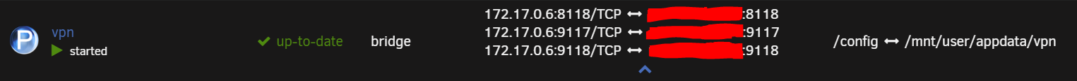

Thank you for these very clear instructions! I was just looking for something like this after hitting my VPN device license limit, and SpaceInvader One released this timely video. Like a lot of you guys I wanted to use a dedicated container instead of binhex-delugevpn, and this binhex-privoxyvpn is perfect for the job.
However, I'm unable to access the client container web UI. I've now tested with linuxserver/lazylibrarian (to hide libgen direct downloads) and linuxserver/jackett (migrating from dyonr/jackettvpn, but also tried with clean image). I'm on unRAID 6.8.3 and I've tried both "docker create network container:vpn" and "--net=container:vpn" extra parameters. (also, for the record, "docker run" complains when you set a custom network:container in the dropdown and also have translated ports, so be sure to remove ports at the same time you change the network). I've added the ports for the client containers (in my two test containers those 5299 and 9117 respectively) to the binhex-privoxyvpn container named vpn, restarted vpn, and rebuilt & restarted the client containers. Still can't reach container web UI on [host IP]:5299 or [host IP]:9117.
In the client containers, I can curl ifconfig.io and I receive my VPN IP, so the container networking seems to work fine. The client web UI seems to be the only issue. I've seen a couple people in the comments on SpaceInvader One's video report the same issue.
Has anyone else experienced this or fixed it? Would love to have this setup work out!

I feel like I ran into this same issue when I first was getting this running, but I can't remember for sure. First note, the "--net=container=vpn" definitely doesn't work on 6.8.3.
It does sound like you have the custom network set up properly if you can curl the VPN IP on the console for your client containers, one thing I wanted to make sure was that the VPN container was still set to Bridge for the networking mode, not the custom network you created. Only the "client" containers need to be set to the custom VPN network. On the main Docker tab for UnRAID the client containers should have nothing show up in the Port Mappings column.
Here is a screenshot of my setup with the Binhex VPN container and three client containers, yours should look similar if you are set up correctly. Hopefully this helps!

Thank you for the quick response! My setup looks essentially the same as yours, with the VPN container named simply vpn, and unfortunately I still cannot access the web UI, just a 404. One thing I tried changing was that I changed the network from a custom public Docker network I have (to isolate from non-public-facing containers) to simply the bridge network like yours. Client container still receives the VPN IP, but I still can't access the web UI. I tried disabling my adblocker even though it should have no effect, and it in fact does not.
The container is named jackettvpn because I modified my existing container, but that container's VPN is disabled.

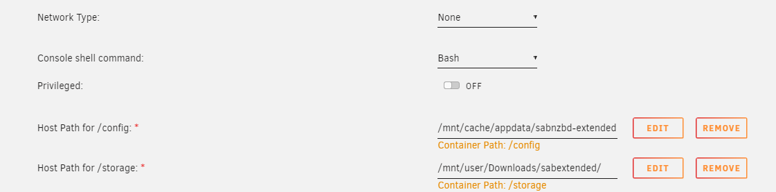

@binhex Hi mate, it is because of the video that I found I cannot access the webui of all dockers routed through 😄
tried 4 dockers now, all exactly the same, they are connected through the vpn on your docker but cannot access webui on any of them
I know @SpaceInvaderOne says you must be on 6.8.3 for this to work but he is using 6.9 so maybe that is the issue?

I'm assuming you did the step of adding in the web UI port to the VPN container as per the video correct?

Hi, yes, I did, I posted a step by step with screenshots on Spaceinvaderone's post here
Try removing all port configuration from sabznb as I see you still have port 8080 defined

Removed Port config although it still shows in docker overview? but still not working..
For what it’s worth, I just set up binhex jackett using the network of binhex delugevpn following spaceinvader’s video. Can access jacket UI without problems and have confirmed it is using the VPN tunnel.
And I left the port mappings in place for jackett.
