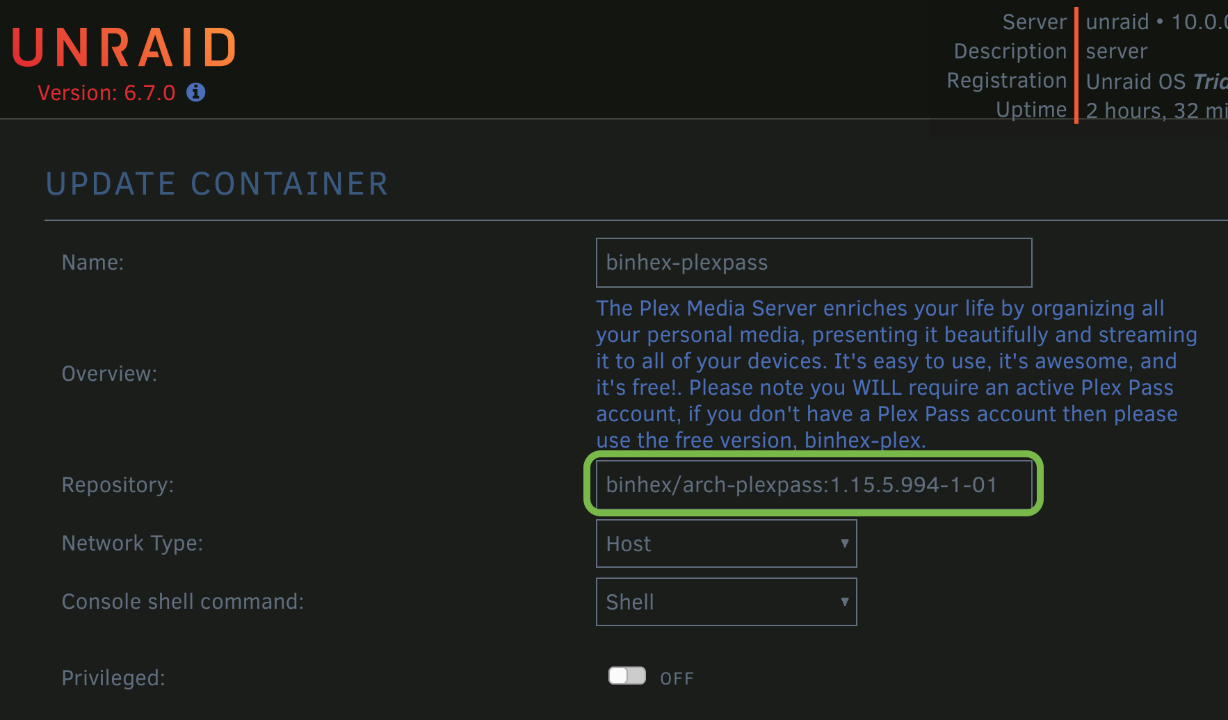

I discovered multiple recent discussions on the plex.tv forums about database corruption after a recent update.
The user "mongo75" in this thread says after downgrading one release he has been 6 days corruption free. So I that is the avenue I am going to pursue.
Since I am currently using the binhex/arch-plexpass template, I checked the tags on his docker hub page. Since the most recent release was from 11 days ago, I see the previous release is tagged "1.15.5.994-1-01". So I downgraded by editing the "Repository" field in the docker template to read "binhex/arch-plexpass:1.15.5.994-1-01" (a colon is required to separate the version tag from the repo name).
2072430027_ScreenShot2019-05-28at12_59_50PM.thumb.png.c35122d9c1133118c5352b0534860696.png
Edited by Brian H.
I made an incorrect assumption. + Deleting associated image.
