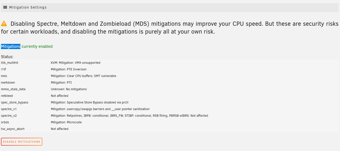

Bumping this thread because latest Unraid 6.11 uses Linux kernal 5.19.x, which has mitigations for Retbleed. It appears this plugin sets the global mitigations to disabled, so it should disable Rebleed mitigations, but wanted to see if anyone has verified that is actually the case.
All you have to do is go to the settings of the plugin to confirm
Sure, but I haven't upgraded to 6.11 yet.  Thanks for confirming.
