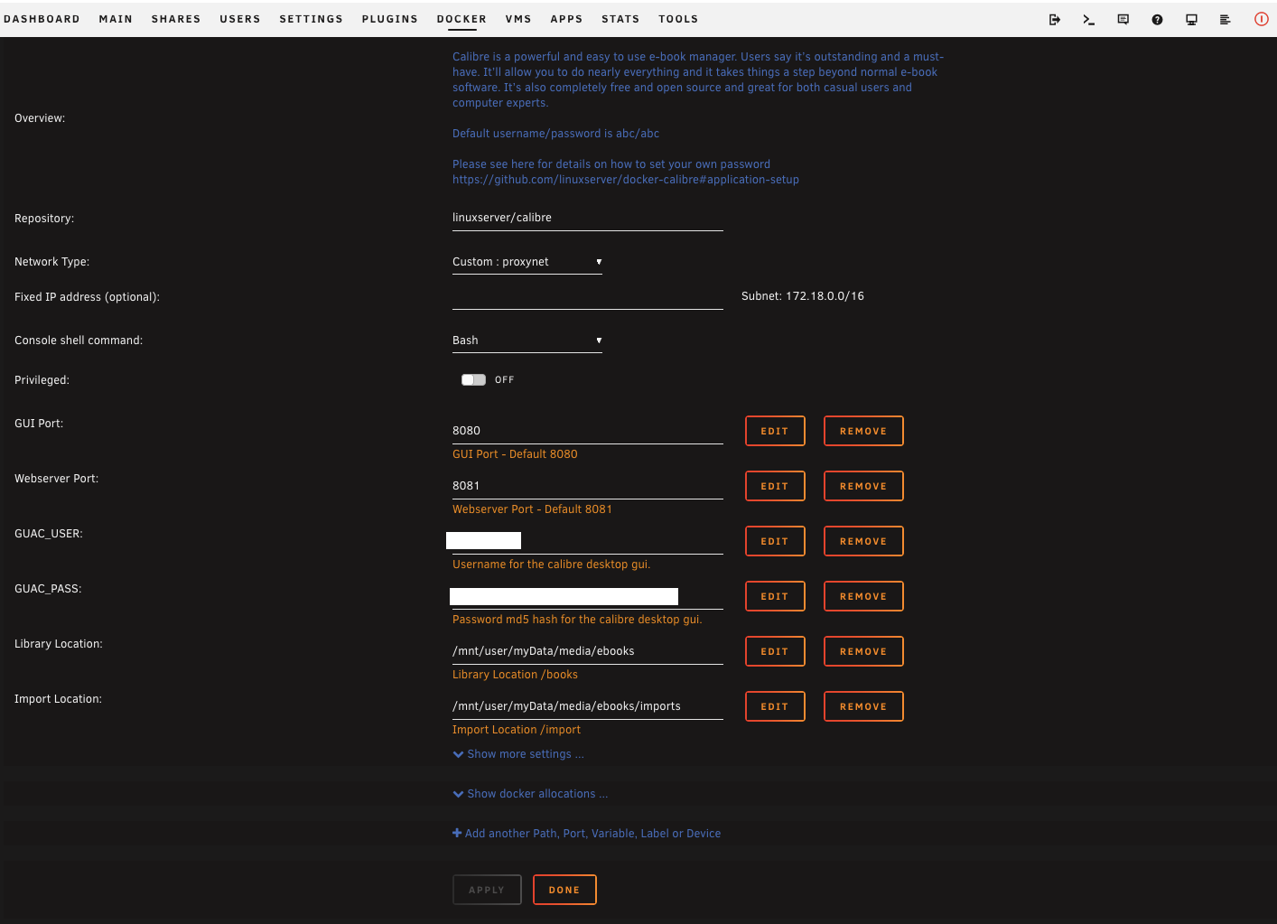

 However, when I update the container, the docker run command is using Los Angeles TZ:
 /usr/local/emhttp/plugins/dynamix.docker.manager/scripts/docker run -d --name='calibre' --net='proxynet' --log-opt max-size='50m' --log-opt max-file='1' -e TZ="America/Los_Angeles" -e HOST_OS="Unraid" -e 'GUAC_USER'='xxx' -e 'GUAC_PASS'='xxx' -e 'PUID'='99' -e 'PGID'='100' -p '8080:8080/tcp' -p '8081:8081/tcp' -v '/mnt/user/myData/media/ebooks':'/books':'rw' -v '/mnt/user/myData/media/ebooks/imports':'/import':'rw' -v '/mnt/user/appdata/calibre':'/config':'rw' --log-opt max-size=50m --log-opt max-file=1 'linuxserver/calibre'
I didn't add an extra TZ parameter so I don't know where it is getting it from. See Template view below:

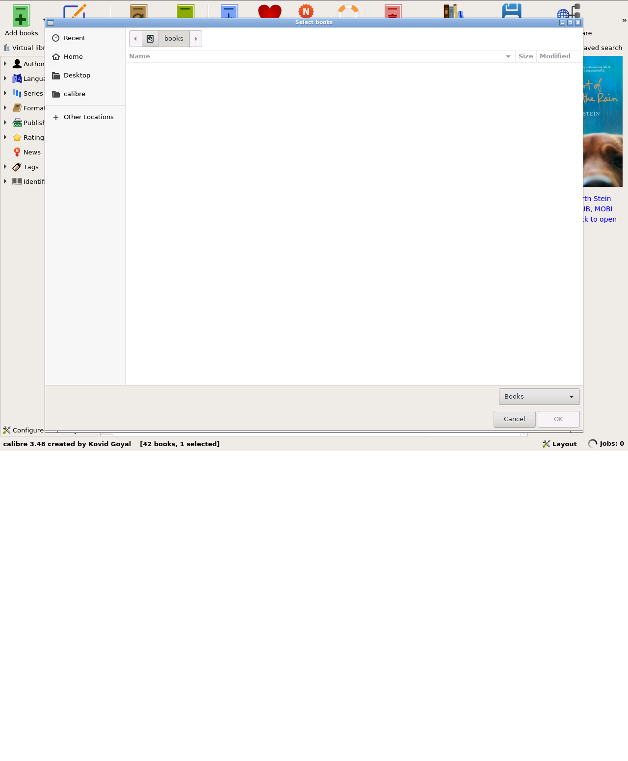

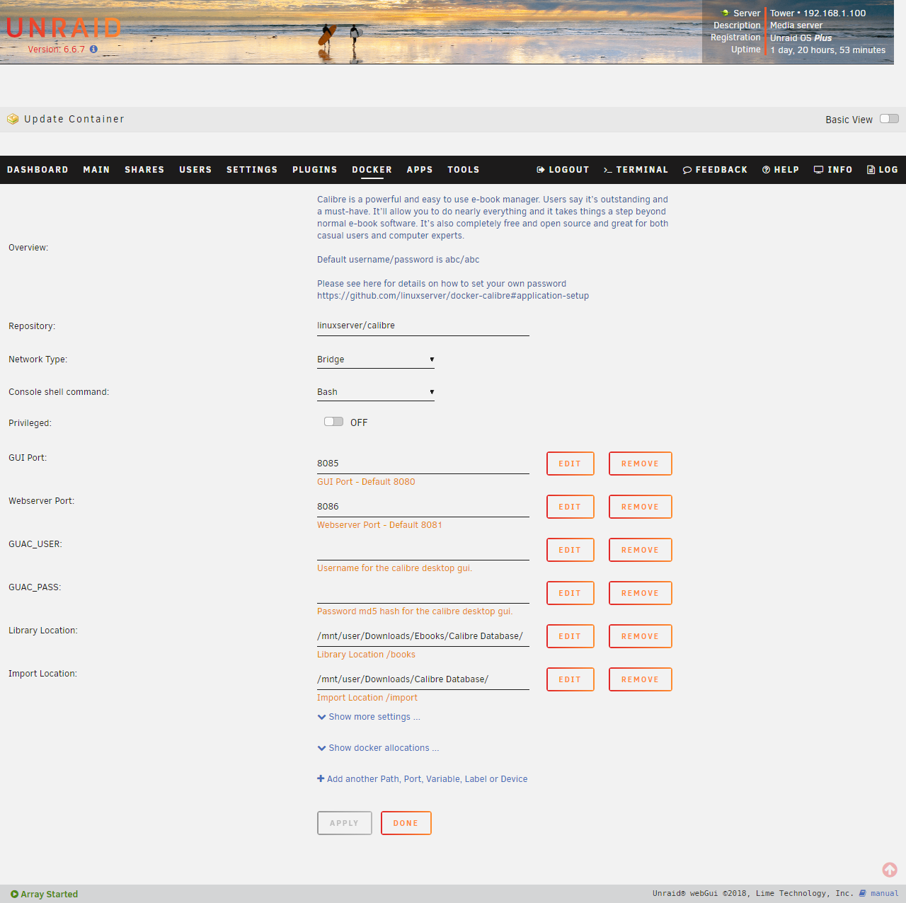

I would like to import my calibre database from another computer.  I have exported it and copied it to a folder on my unraid computer.  However, I can't seem to get to the folder in Calibre.  I copied the exported file to /mnt/user/Downloads/calibre database but when I select "Other folders" and then mnt in Calibre import there isn't anything there.  I am not very good with linux so I might just be looking in the wrong place.  Can anybody direct me as to where I will find my file?
Calibre can only see the host folder that you mapped in the docker template using the "Library Location" parameter. Open your docker template page for Calibre and change the Library Location to /mnt/user/Downloads/calibre and restart the container. Calibre should then be able to access this folder via its /books folder.
I did have it setup this way when I did the install.  However, when I click on books, there isn't anything there.  I had to move the exported file into the appdata\calibre folder for it to be able to see it to import.  This isn't ideal though and I would like to have it in the folder that I set it up with.  See pictures.

You posted a screenshot in a previous post showing TZ set to New York in the template.  You are now saying you didn't add it to the template? I'm confused.
Please post a screenshot of the date and time setting in unraid.

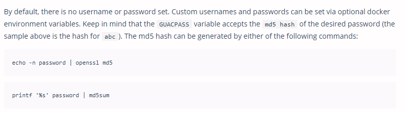

@rwarren873
This tripped me up too.
The password field in the docker template is actually an md5 hash of your password. To get that, run this on any Linux terminal:
echo -n mysupersecretpassword | openssl md5
(stdin)= 117a520adbd19eff51100215aa7a7fbf
That value (117a520adbd19eff51100215aa7a7fbf) is your password hash. Put that in the password field of your docker template, and use the actual password (mysupersecretpassword)  when you login to Guacamole.
I found this information  on the docker info page in dockerhub: https://hub.docker.com/r/linuxserver/calibre
