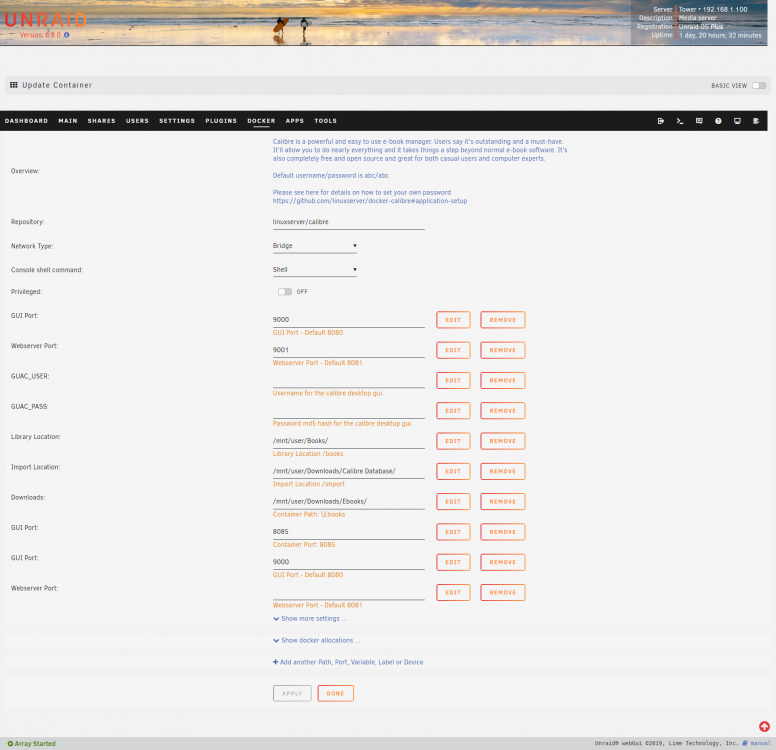

I just installed this container and I am unable to get past the apache/guacamole login screen.
I tested this with my own username/password, the basic abc/abc combination as well as just leaving the two fields blank.
I did make sure to input the md5 of the password when using one (please see my Docker run command below using the abc/abc combination).
Only the last option (leaving both fields blank) works and takes me directly to the setup screen. Any thoughts on why I'm unable to use a username/password?
My Docker run command:
docker run -d --name='calibre' --net='bridge' -e TZ="America/New_York" -e HOST_OS="Unraid" -e 'GUAC_USER'='abc' -e 'GUAC_PASS'='900150983cd24fb0d6963f7d28e17f72' -e 'PUID'='99' -e 'PGID'='100' -p '8080:8080/tcp' -p '8081:8081/tcp' -v '/mnt/user/Media/Books/Calibre Library/':'/books':'rw' -v '/mnt/user/Media/Books/Import/':'/import':'rw' -v '/mnt/user/appdata/calibre':'/config':'rw' 'linuxserver/calibre'
Here is the docker log:

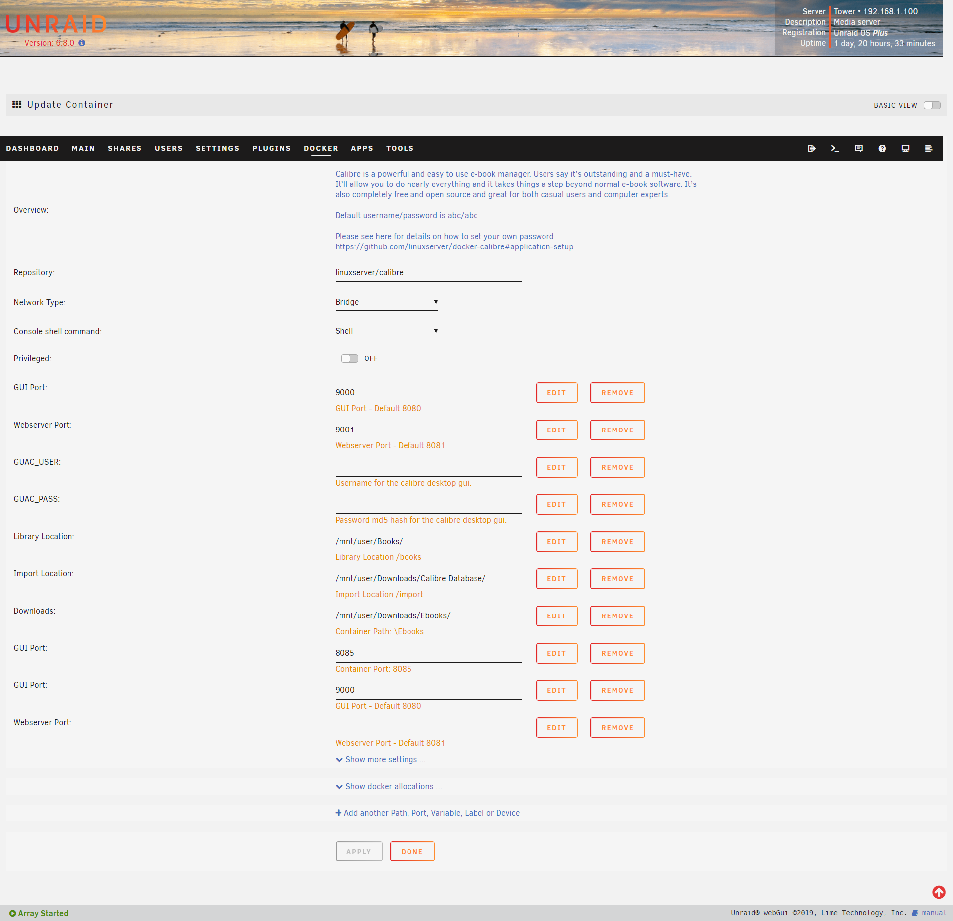

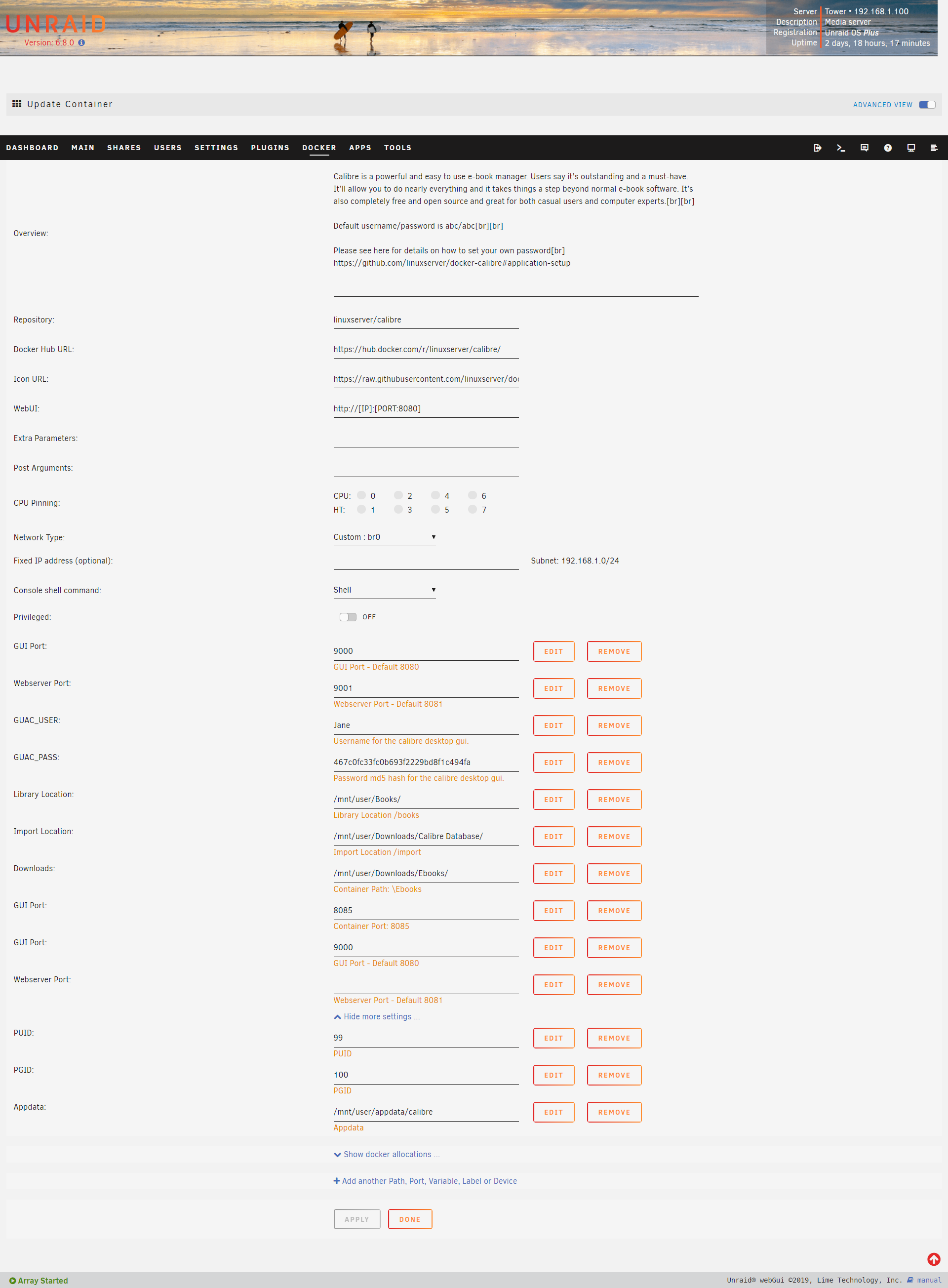

I have a problem with accessing my Calibre GUI.  It keeps taking me to port 8080 which is my SABnzbd.  Even though I have changed the port in the settings it doesn't seem to recognize it.  Here are my settings.  Can anybody help me get this going?
Looks like you have messed up the template as there are double up of some of the settings.
I guess you mean that you use the right click shortcut webui? You can also just type in the IP and port.
Turn on advanced view and post it, as I suspect you might have changed something you shouldn't. And remove those double settings.
Here is the Advanced view.  I don't think I have changed anything but I am trying to get it to use a different port.  However, when I change the network type to Custom br:0, and I  click on WebUii, a Guac login page opens and I can login.  When I first did this, the page didn't come up right away...gave me an error page but then a few seconds later the login page came up.  This seems to be the only way to get this to work for me.
You still haven't removed the double settings. If this is the first time setting it up, please delete it and add it fresh from CA and don't add anything extra. Just change the host port.
