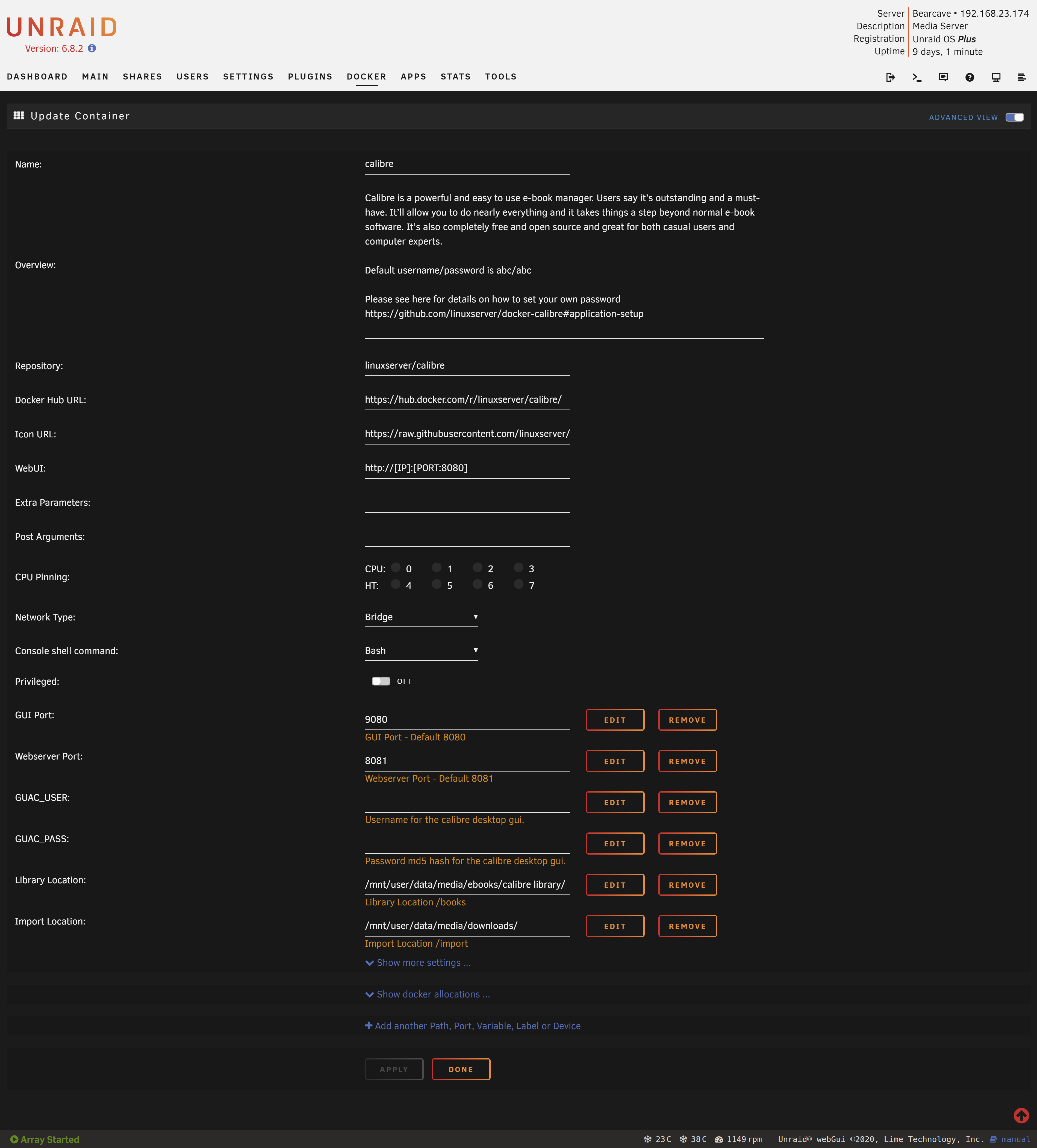

This docker runs good but I am running into one slight issue where the webui cannot be accessed if the docker is left running for a long time. Restarting it fixes it though. Is this a known issue or is there something I can do to fix this?

  • For those trying to figure out how to add this extra variable to the docker template, you need to go to 'advanced' view (slider in the upper-right corner) and then look for the 'Extra parameters' sect
  • PureLoneWolf
    PureLoneWolf
    Edit your docker and change the repository to:   linuxserver/calibre:6.4.0
  • Clifford B Brown
    Clifford B Brown
    They show an option on the Github page for "--security-opt seccomp=unconfined" that fixes this on the docker image. It's mentioned in some issues: https://github.com/linuxserver/docker-calibre/issues/

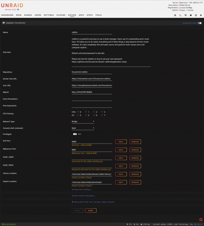

OK, I am trying to install this from a fresh install and I am wondering how to change the host port?  Do I change the GUI port?  Or do I change the Webserver Port?  Also, should I set it as Bridge or Host?
NVM....I figured it out and it is working now.

On 3/6/2020 at 5:50 PM, Glassed Silver said:
With today's update the user and pass fields got inserted again (naturally) and removing them, the appdata content as mentioned above and re-installing the container, but no, stays broken...
As you noticed, by design the fields will get re-added with any update to the app.
On 3/13/2020 at 4:52 PM, jonathanm said:
It's fine.
Why are you deleting fields?
When I did my test, all I did was pull the container, set the host paths in the template to match my array locations, and on first run changed the data location in calibre itself to /books instead of /config.
I did because that's how I got it to work initially after trying all the other things like setting the md5 hash for an empty password, for an actual password I would use and nothing worked...
As for mappings, I also mapped within the app itself to /books, I did see my test library when it worked for a short while.
