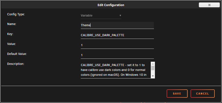

Hello All
If you are like me you like everything to use dark mode/theme.
To enable/force Calibre to use dark mode you need to add a variable to this docker.
Here is the explanation for the variable from Calibre website.
CALIBRE_USE_DARK_PALETTE - set it to 1 to have calibre use dark colors and 0 for normal colors (ignored on macOS). On Windows 10 in the absence of this variable, the Windows system preference for dark colors is used.
See Image for how I defined the variable.

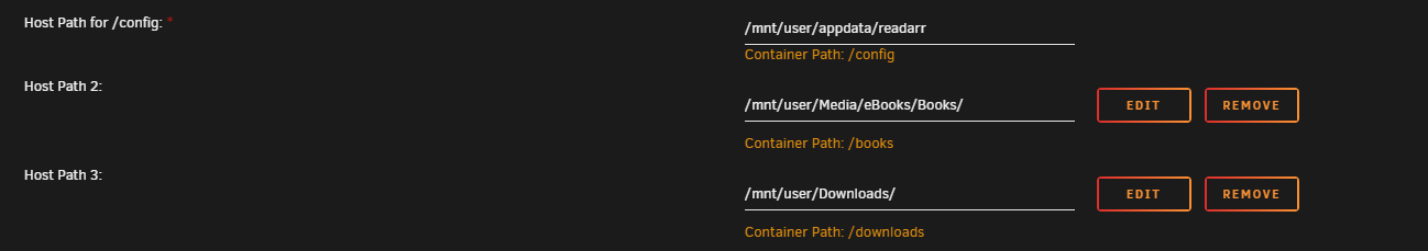

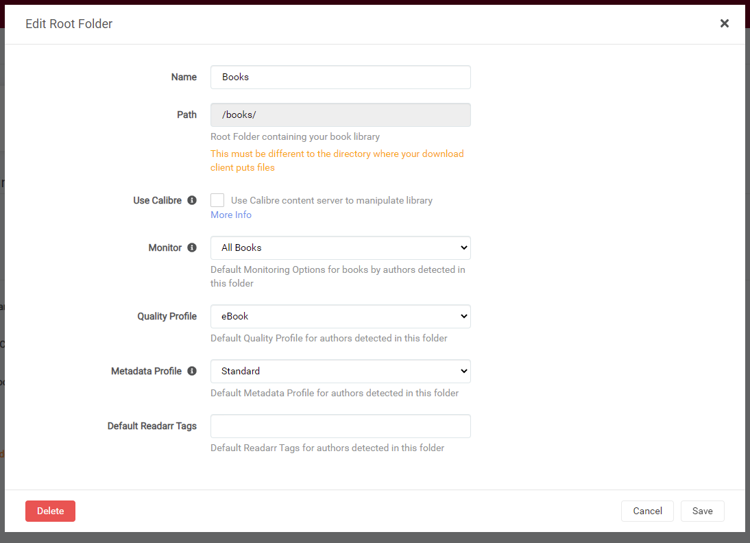

Hey @TechMed
Attached is my setup for "Root Folder" in readarr. It is the location where your books are stored, as you set it in the docker settings when installing. I have attached my settings too.
So you will be looking for the "/books" as your path.
For indexers, and download clients, you can hit the "test" button when adding them, to test the connection works with settings you have installed.
Any problems, feel free to DM me, and I will help with what I can.
