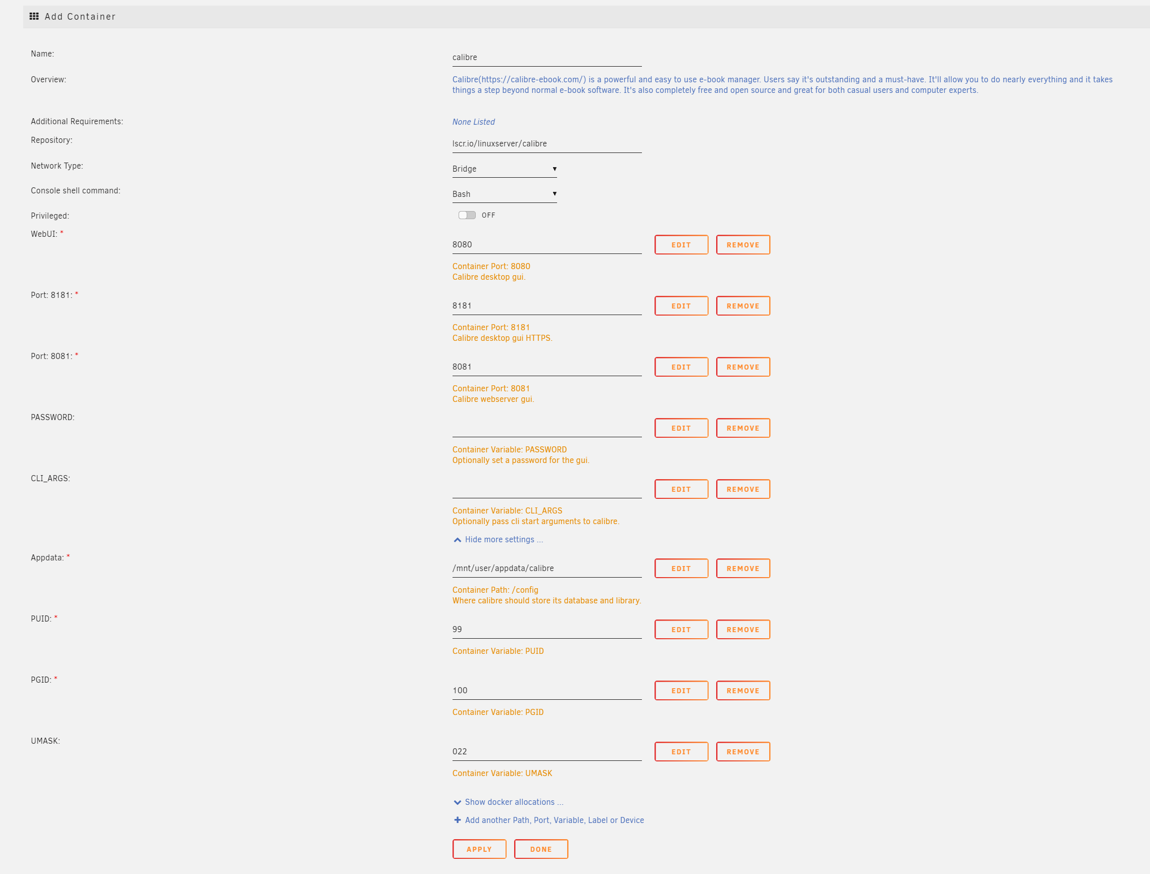

So my docker image filled up to over 50GB.
I think it is because there is only one config mapping for library and files and appdata? I am not sure... but it is definitely something weird.
Did a container size look and this is what I got:
Name                                            Container                Writable                 Log
calibre                                         55.4 GB                  52.5 GB                  13.1 kB
Template is:
Name:
calibre
Overview:
Calibre(https://calibre-ebook.com/) is a powerful and easy to use e-book manager. Users say it’s outstanding and a must-have. It’ll allow you to do nearly everything and it takes things a step beyond normal e-book software. It’s also completely free and open source and great for both casual users and computer experts.
Additional Requirements:
None Listed
Repository:
lscr.io/linuxserver/calibre
Network Type:
    Bridge
Console shell command:
    Bash
Privileged:
Off
WebUI:
8088
Port: 8081:
8089
PASSWORD:
CLI_ARGS:
Appdata:
/mnt/user/media/ebooks/
PUID:
99
PGID:
100
UMASK:
022
I'm running Unraid Pro 6.12.13  and am having the this problem when trying to install the Calibre docker..
Error: failed to register layer: write /usr/libexec/docker/cli-plugins/docker-compose: no space left on device
I don't even have that directory in my Unraid system.  It's as if it's doing a linux system instead of Unraid (yes, I know Unraid is a form or linux).  All modules download to completion and my appdata filesystem is not full.
Repositorylscr.io/linuxserver/calibre
DockerHub Stars:312
Last Update:Oct 17, 2024
I'm pretty sure I had this installed in the past with no issues.  It tells me some of the ports may be used when I click on it to install..   I checked /etc/services and none of the ports are being used.
All versions do this:   latest, v4, etc:       lscr.io/linuxserver/calibre:latest
Pulling image: lscr.io/linuxserver/calibre:latest
IMAGE ID [2000615797]: Pulling from linuxserver/calibre.
IMAGE ID [12f1b475436c]: Pulling fs layer. Downloading 100% of 31 MB. Verifying Checksum. Download complete. Extracting. Pull complete.
IMAGE ID [df25a931801a]: Pulling fs layer. Downloading 100% of 5 KB. Verifying Checksum. Download complete. Extracting. Pull complete.
IMAGE ID [add85d5219c0]: Pulling fs layer. Download complete. Extracting. Pull complete.
IMAGE ID [b7801973f8b8]: Pulling fs layer. Downloading 100% of 701 B. Download complete. Extracting. Pull complete.
IMAGE ID [c28aacdf535f]: Pulling fs layer. Downloading 100% of 273 B. Verifying Checksum. Download complete. Extracting. Pull complete.
IMAGE ID [de7c49a5f876]: Pulling fs layer. Downloading 100% of 14 MB. Verifying Checksum. Download complete. Extracting. Pull complete.
IMAGE ID [fe70bea4c853]: Pulling fs layer. Downloading 100% of 4 KB. Verifying Checksum. Download complete. Extracting. Pull complete.
IMAGE ID [e1cc6fae13bc]: Pulling fs layer. Downloading 100% of 2 MB. Download complete. Extracting. Pull complete.
IMAGE ID [9b5e84e5043a]: Pulling fs layer. Downloading 100% of 21 MB. Verifying Checksum. Download complete. Extracting. Pull complete.
IMAGE ID [851f36536fa4]: Pulling fs layer. Downloading 100% of 705 MB. Verifying Checksum. Download complete. Extracting.
IMAGE ID [b8d9013b2cc2]: Pulling fs layer. Downloading 100% of 14 KB. Verifying Checksum. Download complete.
IMAGE ID [8318fd1c401e]: Pulling fs layer. Downloading 100% of 307 MB. Verifying Checksum. Download complete.
IMAGE ID [109b88dcd169]: Pulling fs layer. Downloading 100% of 963 B. Verifying Checksum. Download complete.
TOTAL DATA PULLED: 1 GB
Any ideas on why this is occurring?  My Google searches haven't found much.
I got it figured out...   While I thought I had plenty of space... I did not.  I doubled my docker image and it installed.   Pilot error.

I do not use a VPN or have an external presence at this time. But I did try it and connection was refused.
1 hour ago, RaidPC said:
I have Calibre working on my Unraid system. But I have on issue. When I attempt to use "Sharing on the Net" to work in connection with Moon+ Reader, it advertises an IP address of 172.21.0.8 and port 8086. But that is not working. I've read docker containers are separate from the host, so I am not sure this can even work? I know my Windows PC works with the Sharing on the Net feature.
Any ideas on a solution or work-around?
If your Calibre container "web server" port is 8086 and you map port, say, 8088 to container port 8086, "Sharing on the Net", in Calibre GUI, has to be with container port 8086; but in your MoonReader app, you have to specify "your unraid server local IP:8088/opds". So if your Unraid server local IP is 192.168.2.99, put 192.168.99:8088/opds in MoonReader app. This setting will work, if your device is connected to your local network. If you are outside and VPN to your local network, it still works.
If you are outside and you don't VPN to your local network, you have to have a public domain name that points to your home public IP. There are extra steps to set it up.
Thank you, it worked! Made the changes you mentioned, pointed to my Unraid server IP in the MooReader app and bingo!
Calibre on my Unraid is working great with one observed small issue. When I right-click on a book, any book, and select "Open Book Folder" nothing happens.
Since I have the docker being able to find the books when started, and can edit them, I would think it would not be a path variable issue.
Is there some configuration I need to do? I have my Calibre Library set to /mnt/user/Media/Books. Everything else seems to work perfectly.
One other quick question / observation.
I noticed of my five dockers, only Calibre creates a folder on my cache drive just starting up. I ran the Mover option in Unraid thinking there was some data, but the folder was still there as well as a type of database file after the move was complete. I assume that is normal, but observed none of my other dockers have that behaviour.
Ok, after last update "Error: This application requires a secure connection (HTTPS). Please check the URL."
Tryed to change webui to 8181 but Unraid tells it is in use? (does not accept it and start calibre with that?)
So? How to fix?? AND WHY? If I have local calibre in my home network WHY are we forced to use HTTPS?
