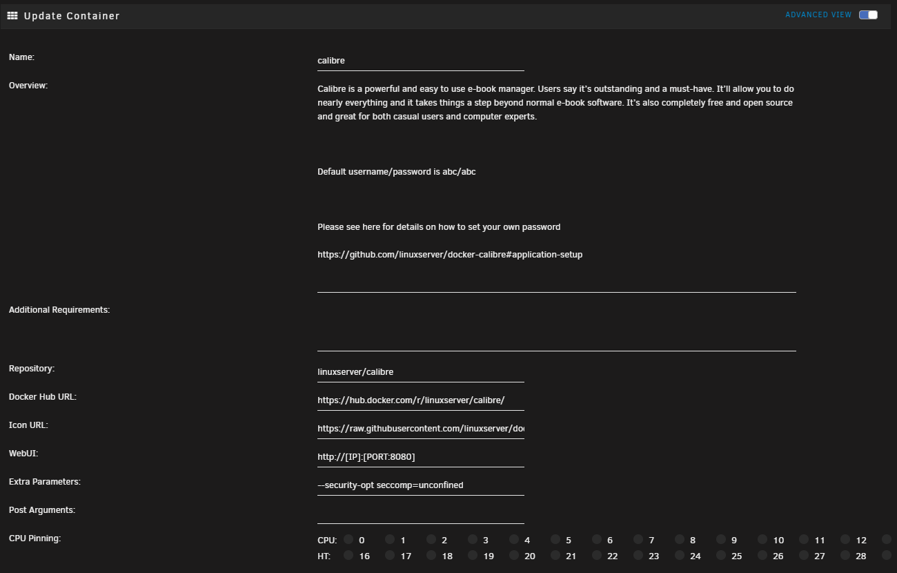

  • For those trying to figure out how to add this extra variable to the docker template, you need to go to 'advanced' view (slider in the upper-right corner) and then look for the 'Extra parameters' sect

    They show an option on the Github page for "--security-opt seccomp=unconfined" that fixes this on the docker image. It's mentioned in some issues: https://github.com/linuxserver/docker-calibre/issues/
2 hours ago, Clifford B Brown said:
They show an option on the Github page for "--security-opt seccomp=unconfined" that fixes this on the docker image. It's mentioned in some issues: https://github.com/linuxserver/docker-calibre/issues/97 and https://github.com/linuxserver/docker-calibre/issues/102.
This fixes it for me on Unraid.
For those trying to figure out how to add this extra variable to the docker template, you need to go to 'advanced' view (slider in the upper-right corner) and then look for the 'Extra parameters' section and enter this in the field:

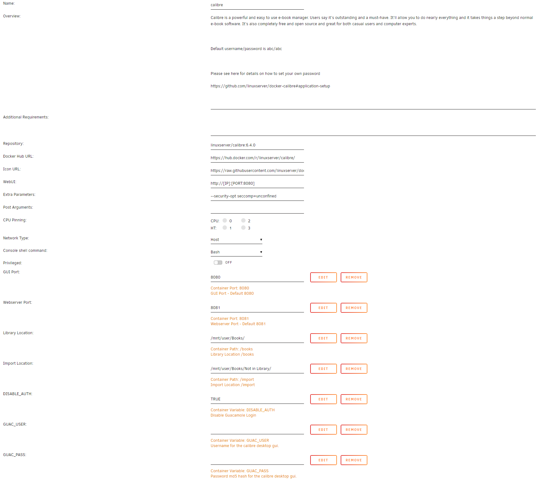

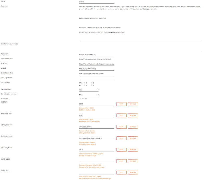

Just to re-visit this one as I saw a new update pushed to docker hub, which just immediately gave me a "Refused to connect" once applied.
I have attached my docker config, just for a sanity check against others that got it working.
For interest, I added the "--security-opt" parameter to my working 6.4.0 install and it still works perfectly.   However, when I go to the latest version, I just get a "Refused to connect error".

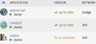

Ok doing the extra setting worked, should just update the docker to include it i suppose.
Also I am getting an error on the version update:
