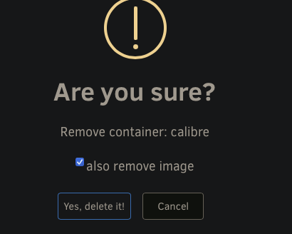

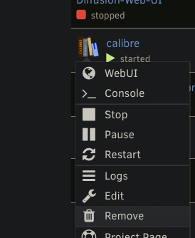

Ok step by step how I got it working after struggling 2 hours...
1: Uninstalled old calibre (it did NOT update so new required settings are there as I did NOT have https configured to be used.. the pem file was in folder but it did not use it or it was not working or something. So complete removal of old version) -edit- and of course if you are smarter than I was.. take screenshot first from all path settings you have to let calibre access your storage and make it for new setup exactly same way (that way when you replace old settings to new one it should straight away work just as before without fixing paths first as I did not remember mount points I had put paths on olden so made new ones and they were not same as old so calibre first wanted to get paths to books and had to fix also path to auto import...)
btw: if any admin for docker devs read this: there is kinda of really stupid "feature" in the setting the paths. When it starts to reconfigure it will USE faulty path, die, and whole calibre docker disappear to orphans... just forgot to put / to first which of course is error but hey, maybe when applying it should refuse and tell there is error and not kill itself completely... one extra install again there for me when figuring this out without any decent instructions how to fix this mess and apologies maybe a bit angry comments before, I was rally pissed of and frustrated with this approach "let's kill this for everyone who do not understand everything under the hood completely" which is really a common sin for open source devs and how they approach things.. seems for you too.. and seriously main reason WHY these kind of systems never hit main stream.. because devs do not care to think how to make things simple and easy without understanding everything there).

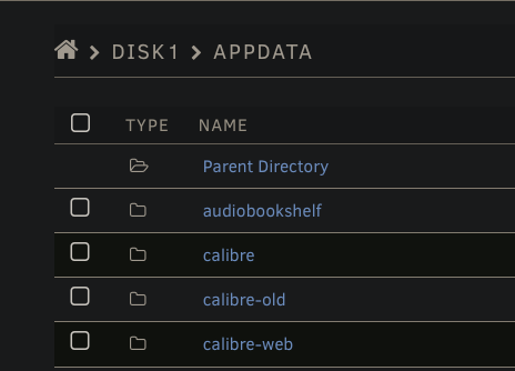

Näyttökuva 2025-08-06 kello 11.58.55.pngNäyttökuva 2025-08-06 kello 11.59.03.png
added with take out settings folder in app share (advice: rename old calibre folder to calibre-old) so it installs completely clean new one (if you have settings there it does not add required fields to settings, you probably could(?) add them manually and it would work(?) to existing one but at least for me, if I tried to replace app folder with old one after install, calibre just crash on start with error, thus something on old folders is conflicting with new version... HOWEVER in config folder there I replaced calibre folder with old config calibre folder and all my settings were saved, so at end did not loose all the fine-tuning done for my calibre setup)

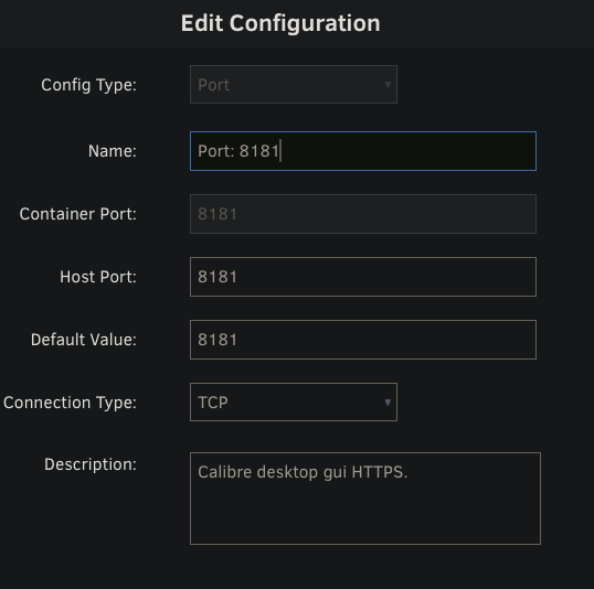

These are default settings for clean setup (I did NOT have without clean setup that last https port setting in settings at all.. thus.. update did NOT add that even when it is now required.. you probably can add that manually(?) did not try that
One problem I had is that Unraid IS media server for me, so there is bunch of media related dockers. And Tautulli is conflicting with that port 8181. After tinkering figured out how to get it working (no I am not in-depth linux native understanding dockers etc. One reason why I have Unraid and ready made dockers in there.. I don't have to be... in these forums I find it sometimes very annoying when all instructions are on the level "hey do just this and this" with expectation everyone is just as natively swimming on linux console and understanding completely how docker works etc...)
So Tautulli settings for avoiding conflict if you use Tautulli (with advanced view of course again). Now my Tautulli opens with port 8182 and is not conflicting with calibre...

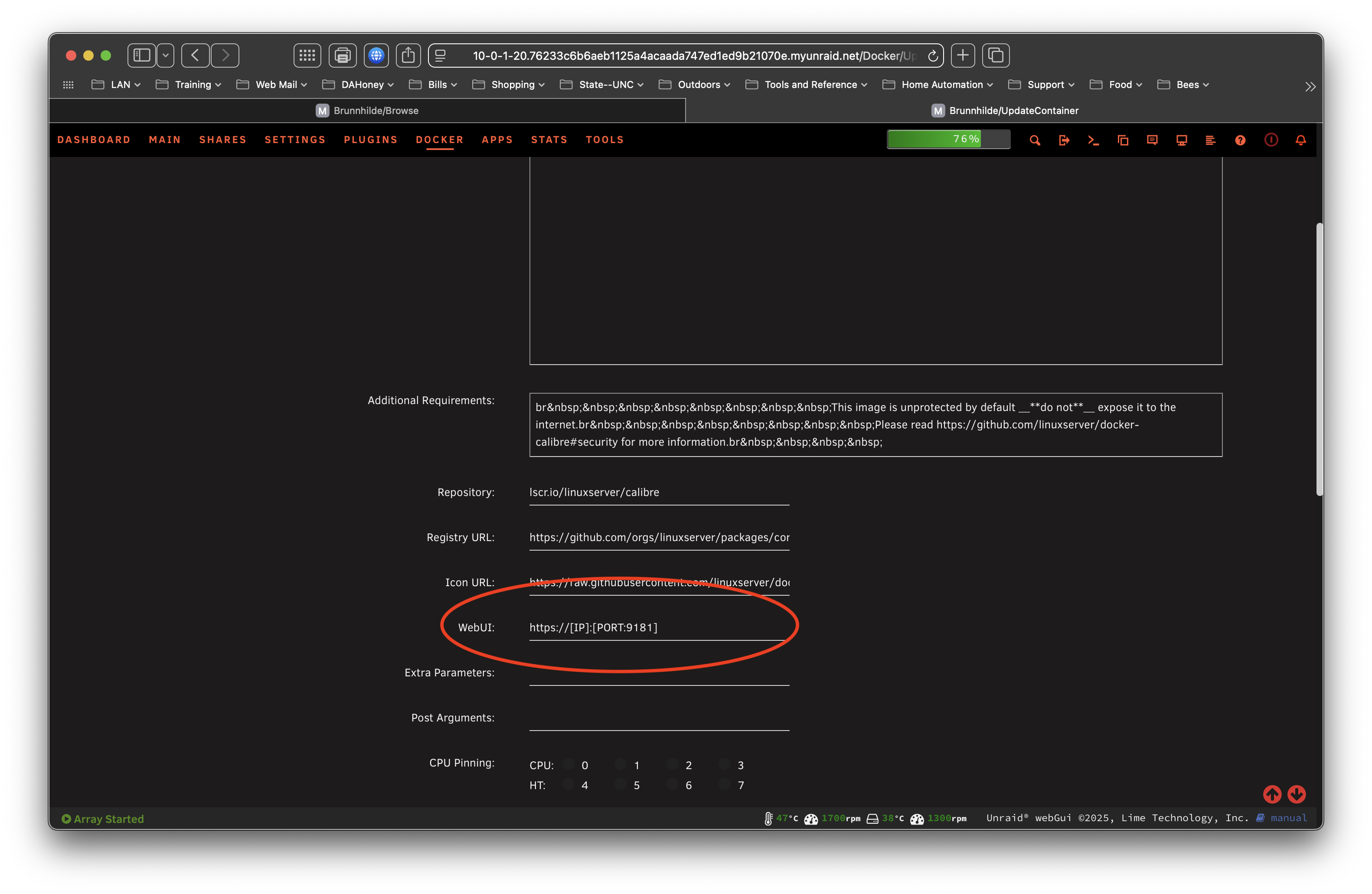

I actually found that if I just put in https://your ip address:8181 into your browser, your calibre should open. The issue is that you can't use the WebUI from the docker because it is set to use the http://ip address:8080. You need to type in the correct address into the web browser yourself.
I do have another issue though. When I am in the WebUI in chrome and I try to click on a URL link such as a "plugin homepage" link in a plugin, nothing happens. It doesn't go anywhere. I tried adjusting the tweak "change the programs that are run when opeing files/URLs" but it isn't working when I set it like this openers_by_scheme = {'http*': 'Google Chrome.lnk %u'}. I am assuming that it is because this is running through a docker on unraid. How do I get these links to open a web browser page?
You can change the port used in the webui link.
Be sure view is set to advanced.
Nope. I tried manually typing it in the browser, but it didn't work for me. Neither on Firefox or Chrome.
