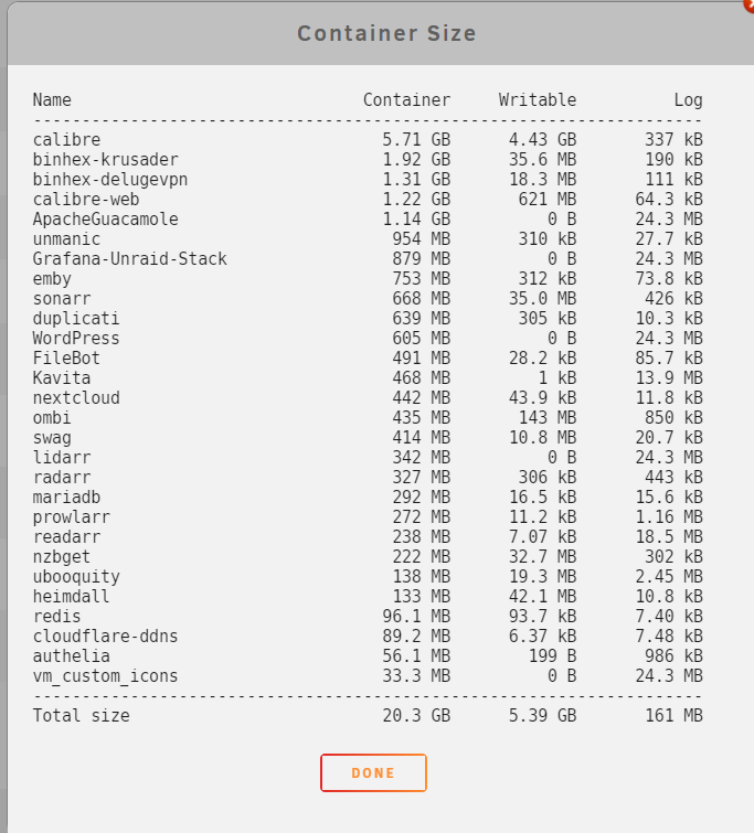

My docker env disk seems to be growing and looking at the docker container sizes the calibre container is 5.71GB with 4.43GB writeable. This is twice as large as any other container and it seems to be far bigger that I thought it should be.
What size should i expect the container to be and what settings should I check to trim it down (if possible)
Thanks
Container size output in spoiler
Spoiler

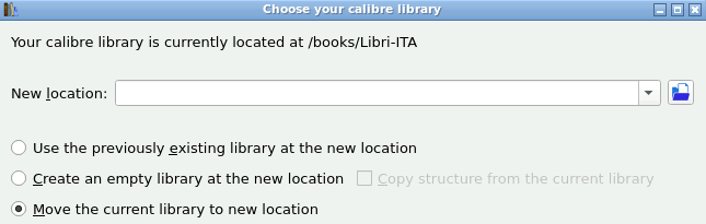

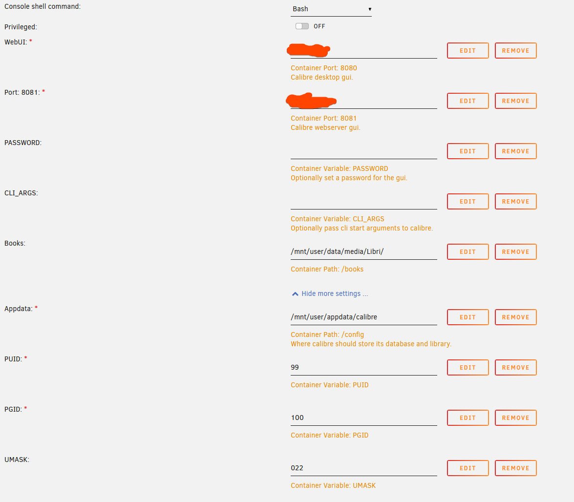

Inside the calibre app settings, not the container config, what path is pointed to your library?
im not entirely sure where to find that setting, the only place i can find is when i check the new library it says the current library is located at /books which is where i have mapped my media/books folder

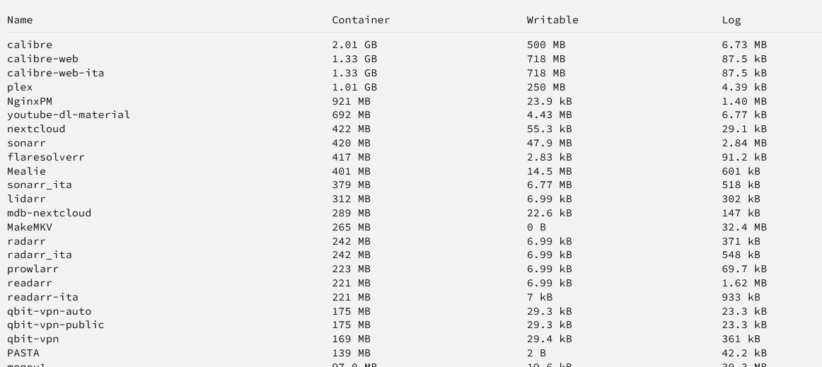

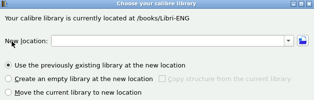

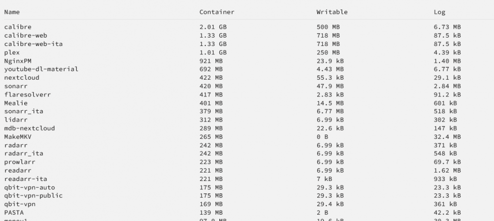

I'm also having the container size a little too big to be normal (the calibre-web too to be honest), I checked the path and library mapping and i don't see anything strange.
Am I doing something wrong?
the /mnt/user/data/media/Libri by itself is 958 MB
Spoiler
