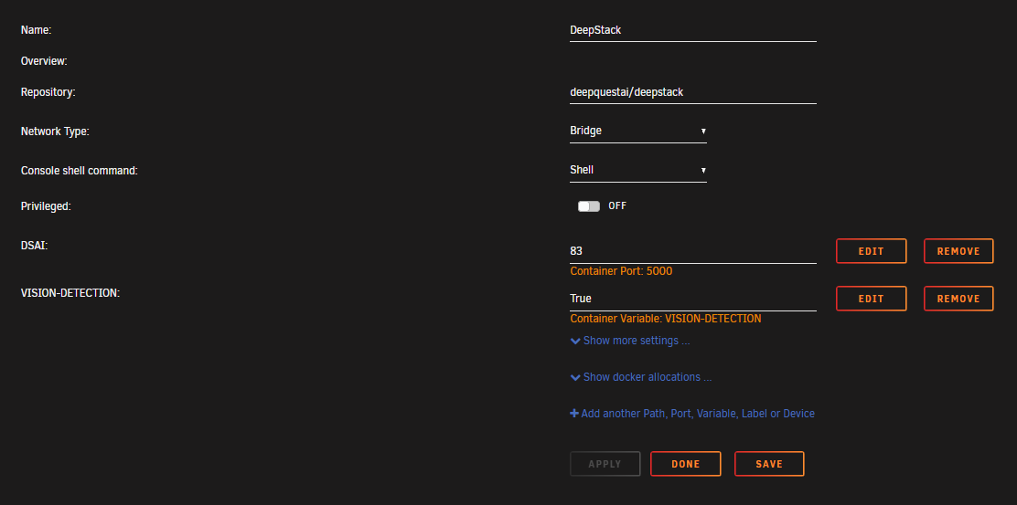

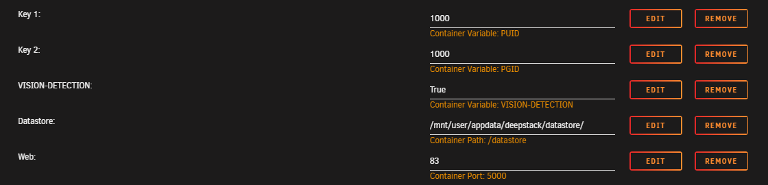

August 17, 20206 yr On 8/9/2020 at 9:51 PM, Boyturtle said: I know this is an old thread, but I am trying to get any version of deepstack docker to install on my unraid, but there does not seems to be any template available. Could anyone help guide me through how to install it? There are some command line on the deepstack AI website, but when i ran them, nothing happened on my unraid and I do not see any new docker created for it. Anyway, hopefully someone can shed some light on this for me, as having to boot into windows 10 and running the exe and turning on the deepstac The CPU version work perfectly. You have to add a container manually. (Docker Tab, at the bottom) Then, fill this information Name: deepstack Repository: deepquestai/deepstack:latest Then add the following using the button "Add another Path, Port, Variable, Label or Device" That's it. It's long to install. Be patient. To try if it work, go to our unraid IP:83 It will show a deepstack web page. (Example: http://192.168.1.10:83) Enjoy. Edited August 17, 20206 yr by speedmax1979

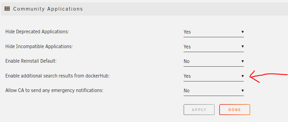

August 18, 20206 yr Thank you speedmax. Think DeepStack is working now. Now have to figure out how to interface it with Blue Iris... FYI, I installed DeepStack through Community Applications, following the newbie docker guide on this forum. So basically you'd check the box in settings that says "Enable additional search results from dockerHub"

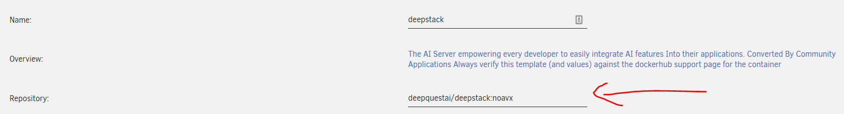

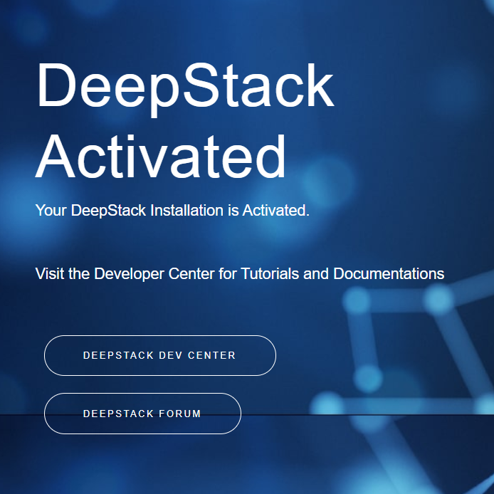

August 18, 20206 yr thx again, I'll try your link with the docker approach. Thought I'd share some issues I encountered so far, and solutions. To install DeepStack, I went through Community Applications, as per my post above. The DeepStack server was running, but encountered errors "Can't reach DeepQuestAI Server" when fed images using the AI Tool (windows based). I also did not need to activate the DeepStack. Did some Googling, and on another forum, people were saying to "pull" the docker from deepquestai/deepstack:noavx. Updated the docker container, see below: Afterwards, DeepStack wanted an activation key, which you get from their website. I can report now that my AI Tool is working, as per TheHookUp guide, and triggers Blue Iris no problems.

November 17, 20206 yr On 11/14/2020 at 12:00 PM, ghzgod said: AWESOME!!! I would have never known. My CPU gets taxed hard for the hundreds of camera triggers on a daily basis. Thank you for providing this!! Trying to install the latest x5 beta as above but can't get the activation prompt to show (shows as already activated). The noavx version works fine? Not sure what I'm doing incorrectly.
