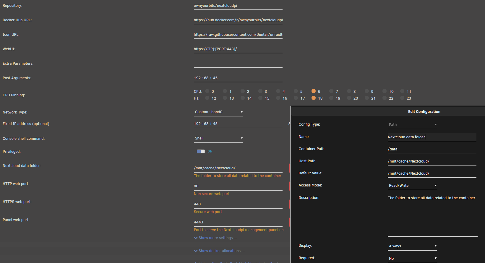

Hi ! :)
I freshly installed NCP (some 2hours ago now), have access to control panel no problem, but NC WebUI loop refresh with "Initializing NextCloudPi for the first time - Please wait..." :/
Can someone help me please ? :)
I'm attaching the config :)
Thank you ^^
And here is the log (edited the docker 2 times to change post argument in hope of..)
NCPLog.txt
Edited by AinzOolGown
Add log

On 5/3/2020 at 9:02 PM, AinzOolGown said:
Hi ! :)
Thank you ^^
This all looks right, did you try wiping the folder and starting it again?

Hi :)
Which one ? ^^
Just stop the Docker, wipe the folder and start the docker again ?
Thanks :)

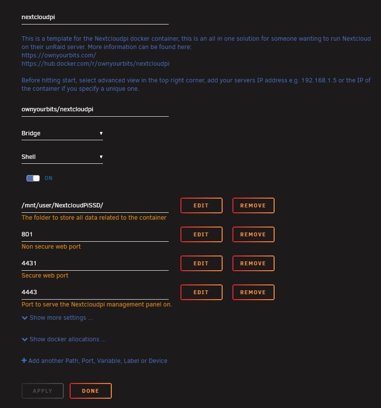

Hi there,  I deploy this docker and it maps the Port 80 and Port 443 but never the 4443 and so I cannot configure it.  What am I missing.... Thanks Paul
On 5/10/2020 at 4:40 PM, AinzOolGown said:
Hi :)
Which one ? ^^
Thanks :)
Hi !
Deleted/reinstalled all the way from scratch, seems to finally works !
Thanks ;)
Tips : on the "Nextcloud data folder" field, i previously used "/mnt/cache/nextcloud", this time i used "/mnt/user/nextcloud"

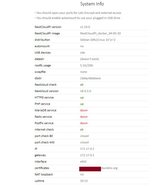

I have "Nextcloudpi" on two unRAID servers, one in beta 19 and one stable 18.x.x. Both went very well according to the instructions here (thanks for that.)
On both unRAID servers I have "Plex Hardware Acceleration using Intel Quick Sync" enabled, as explained in the forum (putty; modprobe i915->cd /dev/dri
ls->chmod -R 777 /dev/dri and finally "nano /boot/config/go" with the entry "modprobe i915
chmod -R 777 /dev/dri")
After a reboot, however, NCP no longer worked on either of the two unRAID servers, but both show the same errors in the :4443 backend (see photo).
Maybe someone can help me to get the container started again with the database, I find it strange that activating the HW acceleration caused such an error.
Thanks a lot.
The config . works quite well so far..
