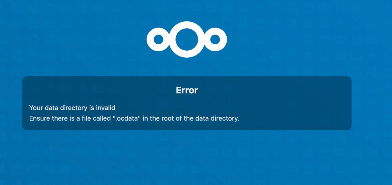

In the last two days, my Nextcloudpi unraid docker installation has become very problematic to the point I can't open any of my saved files and photos.
The problem started a few days ago when I tried to open the Nextcloud web dashboard and I got an error message saying my data directory is invalid and that I need to make sure there is an .ocdata file in the root of the /data directory:
I read a few forum posts referring to this issue, that suggested to manually create a new empty .ocdata file in the root data directory. I did that and I was happy to see I could open the Nextcloud web dashboard again.

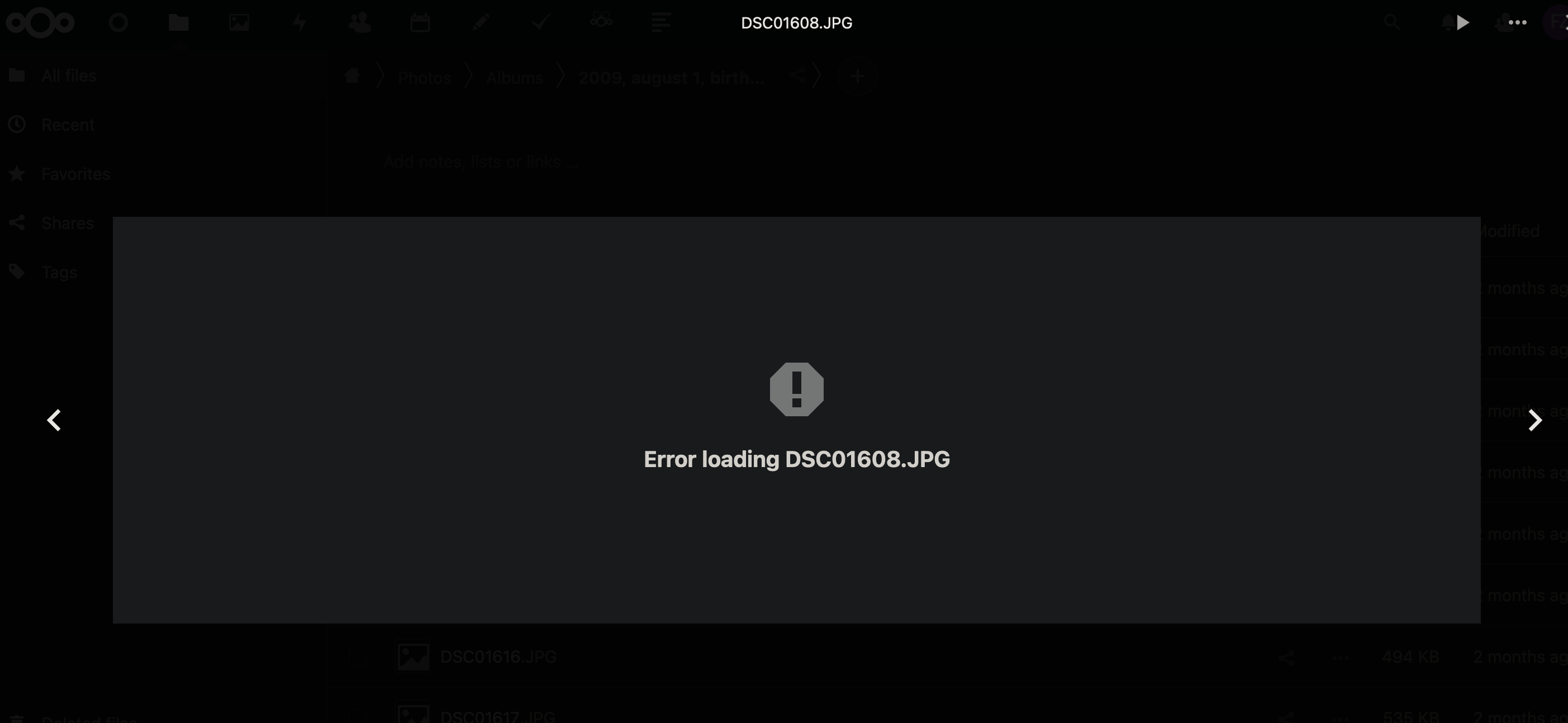

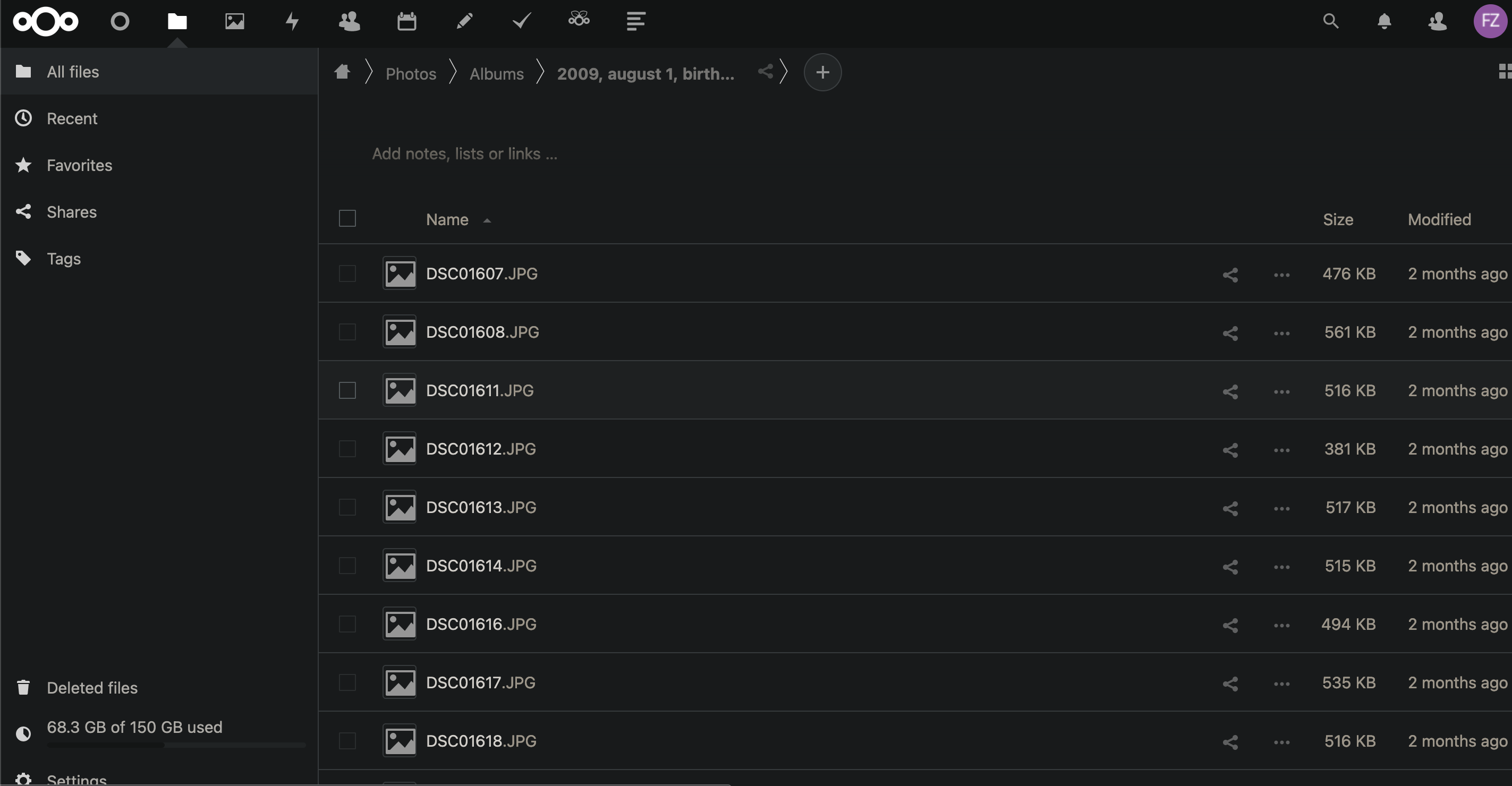

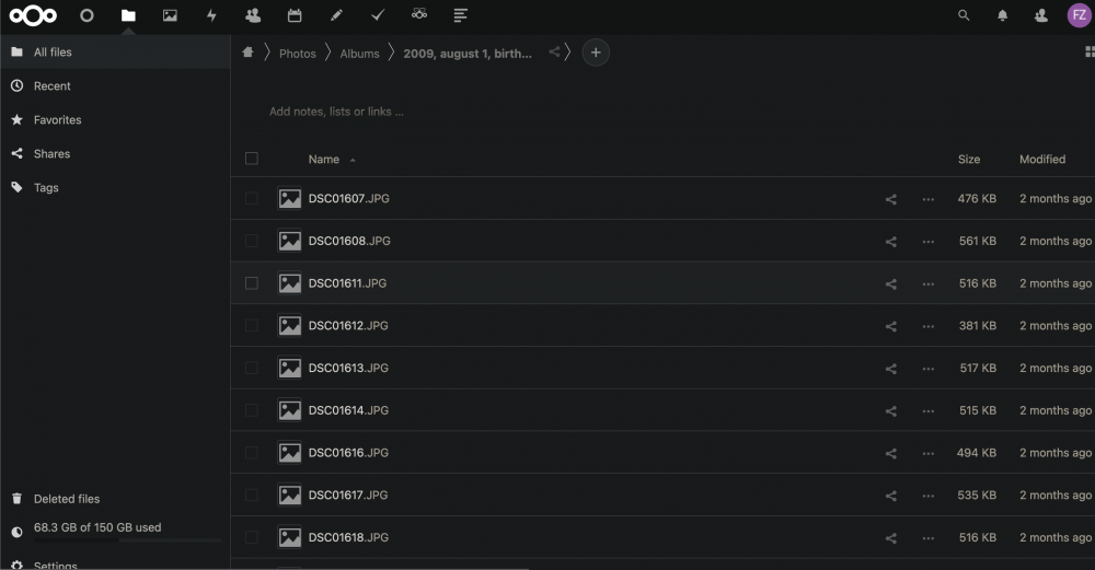

Sadly, however, my problems didn't end there, because now I can't open any of my files.
I can see all my files and folders listed in the Nextcloud web dashboard:
447882791_ScreenShot2022-07-17at23_39_53.thumb.png.5024152f825779b110dd41d0dcb1401a.png
but when ever I try to open a file I just get an error message:
1438224287_ScreenShot2022-07-17at23_40_02.thumb.png.9ccae5d26b5accd6abdc6eef3ac8bf0b.png
Is there anything I can do to fix this issue to restore my files?

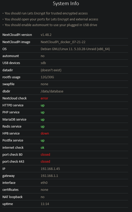

Hi ! :)
Yesterday my NCP made seppuku, that is so strange :/
8AM, i'm heading to work like always
In the middle of my way, i received notif about some connection problems. It happends from time to time if the synchro runs when i have a poor mobile network, so i just discarded it.
It persisted for some hours, so i tried to connect to my Nextcloud instance via the mobile app, and it gave me "No files".
Thought my server just froze so decided to wait 'till i'm home.
7PM, home, server is all good, all service running except Nextcloud and i can't connect to it (but i can connect to NCP's admin)
I don't understand what's going on, i haven't changed anything in config, there was just a parity check running :/
Bellow the logs & informations
- When i click on "WebUI" in Unraid NCP docker's menu, i now have this in place of Nextcloud's login screen :
- There, if i correctly understand, it tells that the last DB operation was 22 Jul at 07:34
- NCP's System Info :
Do someone ever saw this ? O_o
Thank you in advance :)
P.S.: Made this morning the latest NCP docker's update but no change :/
Already rebooted the server and tried to reinstall docker
/data/nextcloud.log is empty
tower-syslog-20220721-1732.zip NCP docker's log.txt NCP -data- tree.txt
Edited by AinzOolGown
SysInfo
