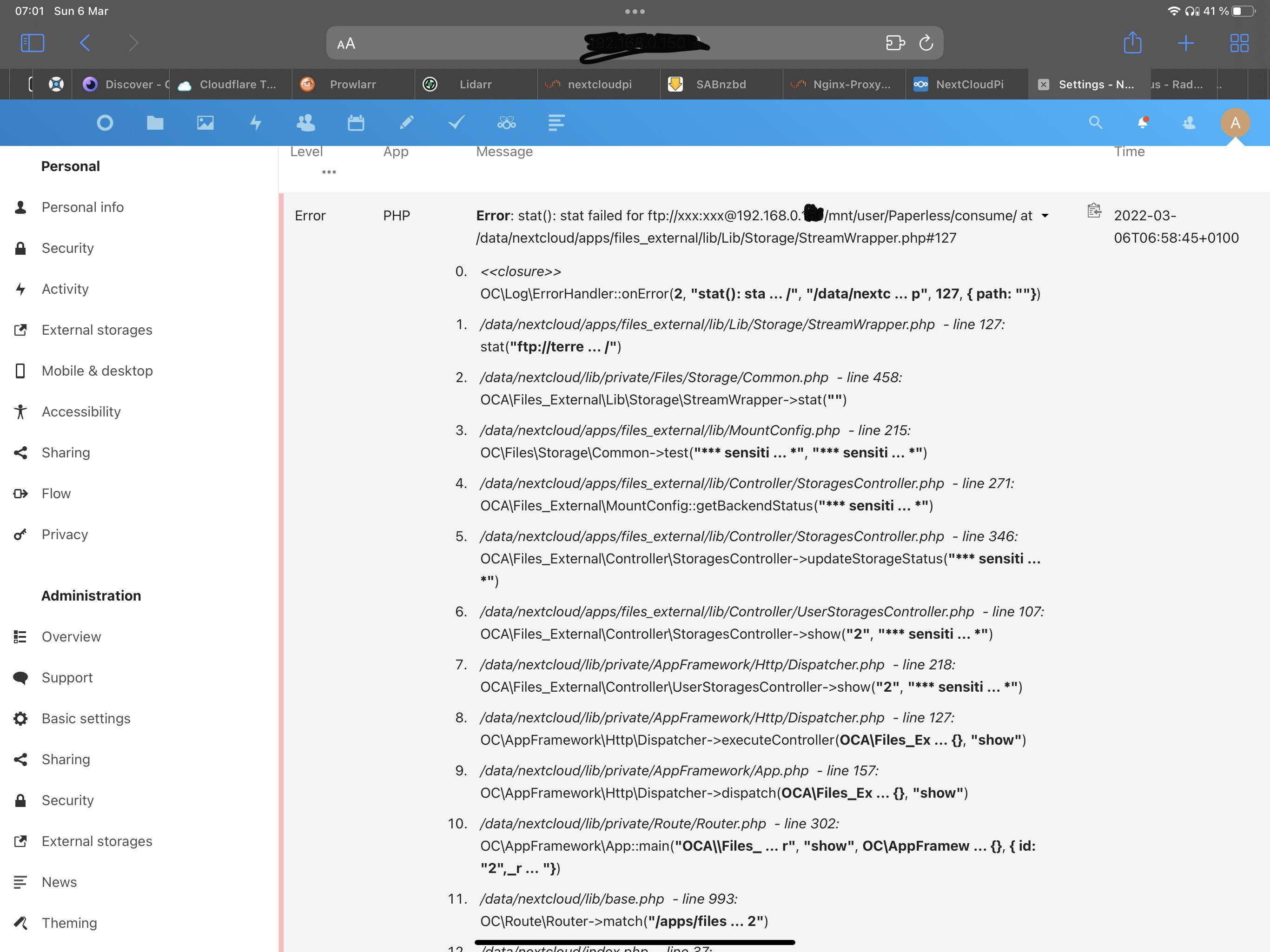

I have setup and external storage so I can scan and upload directly into Paperless-ng.
Had it working perfectly with the standard Nextcloud docker.
Toda I install pi and setup the external storage. All green. BUT I get and error when I try to upload directly to the folder and I get a "internal sever error"  Error  405 - The requested method is not supported.when I ty to upload from the iOS app as well.
Any. ideas? What should I check?
Thanks in advance
Edited by Profezor
  • Replies 139
  • Views 41.9k
  • Just create a new path like this (replacing host path to the path where you want the data to be stored at):     This will overwrite the the real data folder where the user folders
  • Joining the discussion since I had the same issue a few weeks ago after an update. If you look carefully at the "System info" screenshot you provided, you'll notice that nextcloudpi is setting the dat
  • Thanks @potjoe   I’ve had a bit of a search and it seems other people are having the issue too. The forums also appear to be down so will circle back later.
Create external storage using ftp. The consume folder is my Paperless-ng folder. System worked great using Nextcloud. But now switching to Nextcloudpi, it doesn’t. What am I doing wrong?
here is the error log. Thanks.

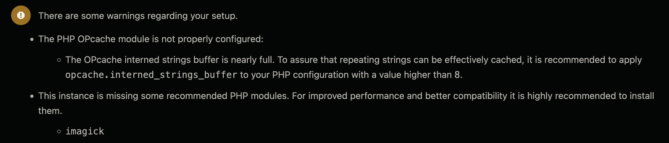

However, I'm seeing two warnings regarding my setup in the settings overview page:
3214741_ScreenShot2022-03-18at11_29_48.thumb.png.1ee69a2104324b9225cdd636c94c7db8.png
Can anyone share the path location of the opcache.ini file in the nextcloudpi container, so I can update the opcache.interned_strings_buffer to a value higher than 8?
Is there a way to add imagick to the container?
Thank you.
Regarding imagick, it has been removed from the container for security reasons. See here https://github.com/nextcloud/nextcloudpi/issues/1159
Regarding OPcache configuration, you can ignore the warning :  https://help.nextcloud.com/t/nextcloud-23-02-opcache-interned-strings-buffer/134007/5

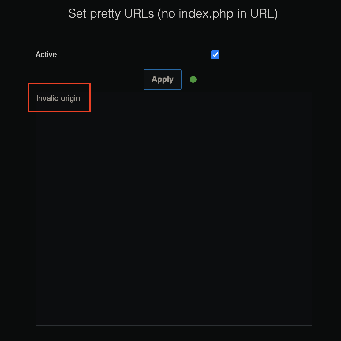

Is anyone else seeing an "invalid origin" message when applying setting changes in the NCP dashboard?
It happens for all settings changes, not just for pretty url's.
167556030_ScreenShot2022-03-19at13_43_24.thumb.png.d13b29af8584e5ca050d8eae73b13c3a.png
@mjeshurun I'm not familiar with the issue, did you had a look on nextcloud help forum or nextcloudpi GitHub? You can still configure nextcloudpi from a terminal. Open Unraid console and enter
docker exec -it nextcloudpi ncp-config
it'll open an editor to configure it the same way you would in the webUI.
