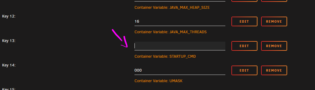

Does anyone know how to pass custom Java launch arguments to the server?
Is this even supported by the container?
For example;
-XX:+DisableExplicitGC -XX:+ParallelRefProcEnabled -XX:+PerfDisableSharedMem -XX:+UnlockExperimentalVMOptions -XX:+UseG1GC -XX:G1HeapRegionSize=8M -XX:G1HeapWastePercent=5 -XX:G1MaxNewSizePercent=40 -XX:G1MixedGCCountTarget=4 -XX:G1MixedGCLiveThresholdPercent=90 -XX:G1NewSizePercent=30 -XX:G1RSetUpdatingPauseTimePercent=5 -XX:G1ReservePercent=20 -XX:InitiatingHeapOccupancyPercent=15 -XX:MaxGCPauseMillis=200 -XX:MaxTenuringThreshold=1 -XX:SurvivorRatio=32
I've tried putting them here but I don't know if that's correct?
Edited by Steven O'Connell
Grammar correction

I can't figure out how to launch the server with the --bonusChest option.  Has anyone managed to get that working for them?
I add the argument to the STARTUP_CMD variable, the server starts but logs show this:
[Server thread/INFO]: Unknown or incomplete command, see below for error
[Server thread/INFO]: --bonusChest<--[HERE]
Have you tried adding the optional
JAVA_CUSTOM_ARGS
key to your container configuration with that
--bonusChest
as the value?

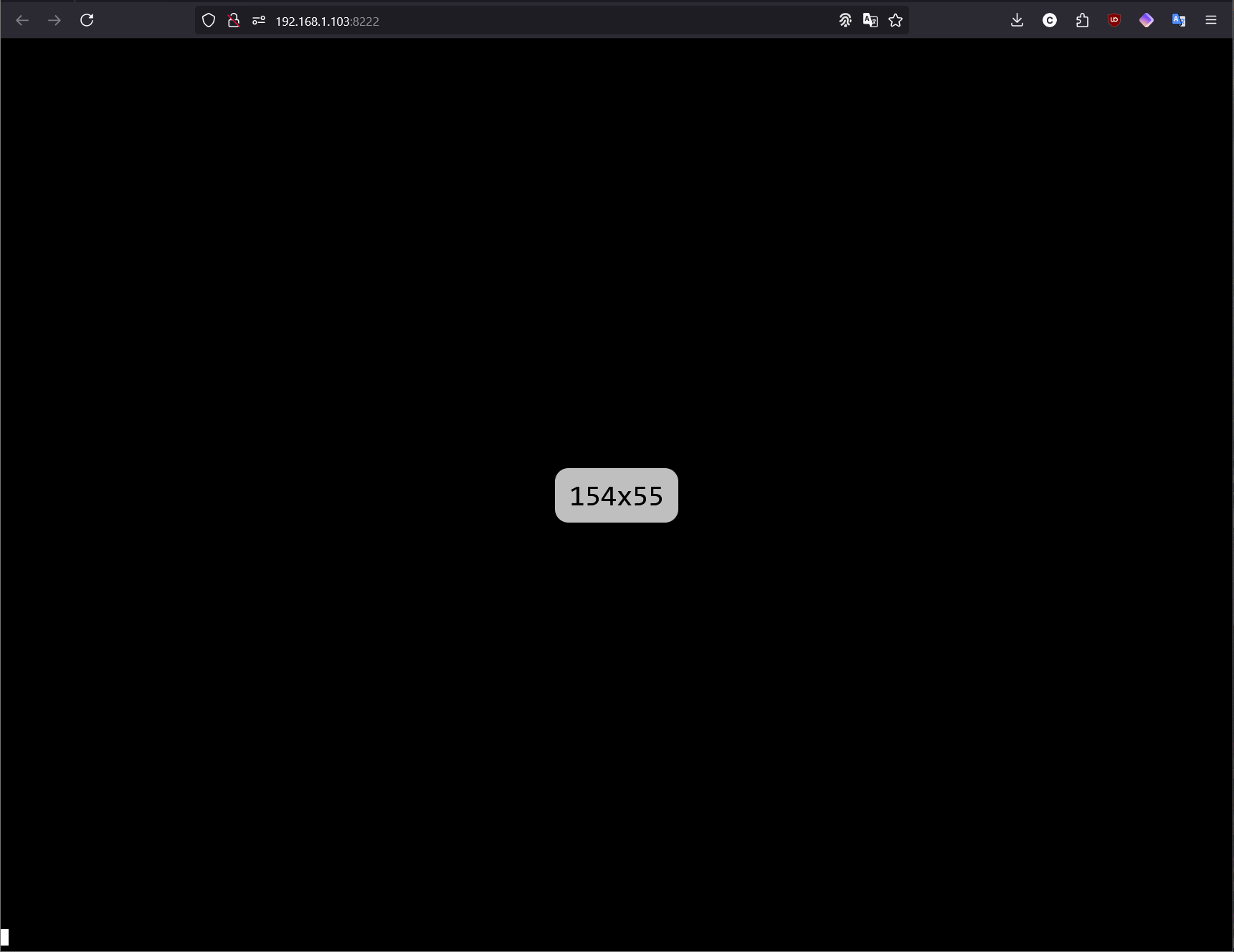

Hello! I've been happily using the binhex-minecraftserver for years at this point, without issues.
Today I noticed that the WebUI is an empty black screen, with only a single text marker at the bottom left. I mainly use Firefox, but switching to Brave resolved the issue. This is strange because I have used this WebUI on Firefox without issue for years, and as far as I can tell nothing has changed - I haven't had a Firefox update in a while. Disabling uBlock Origin, Firefox native security settings, clearing cache, and opening the WebUI in a private tab do not resolve the issue.
Any thoughts? Thanks!
