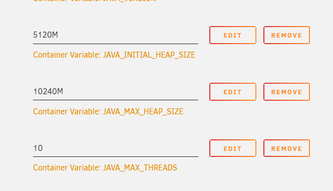

i´m trying to setup a Minecraft server for my son and his friends. Bear with me as i´m not really familiar with Minecraft and it´s terminology...
The docker installed fine and we´re able to connect to the server and start playing. However, my son is reporting that the server is seriously lagging. We did a test with a friend and after a short time (2-3 minutes), the server crashed.
At the server console, i´m getting messages like "can´t keep up. Is server overloaded?".
I did CPU-pinning with 3 CPU cores. CPU is i7-8700 CPU @ 3.20GHz with 32GB RAM. I was thinking that should be enough for 1-2 players...
Any ideas where to look at?
Thanks,
Hocky
18 hours ago, hocky said:

Try increasing JAVA_INITIAL_HEAP_SIZE and JAVA_MAX_HEAP_SIZE values in the template.

Been, there, done that. Didn´t help. Also reduced the view-distance to 6 in the server.properties.
I have set XMX_SIZE to 4G, XMS_SIZE to 2G and XMN_SIZE to 2G and it works relatively well with 3 players. I wouldn't worry about CPU pinning. I let it decide for itself how many cores to use. I have another 10 mods running on my server.

Actually I don't split the cpus pinnings on the server at all, I give everyone the maximum, I don't know if I'm doing it right or not, but I have 51 containers in the docker and 31 of them are running. and 1 VM.. maybe try another minecraft container, i actually have another one... from fithwum but that's also with fabric loader.
Yeah, trying a different container might be worth a try.
Or maybe try another .jar such as https://papermc.io/, I have been running mine with paper since v1.16. With several Spigot plugins + GeyserMC for crossplay between Java  & Bedrock/mobile versions.
