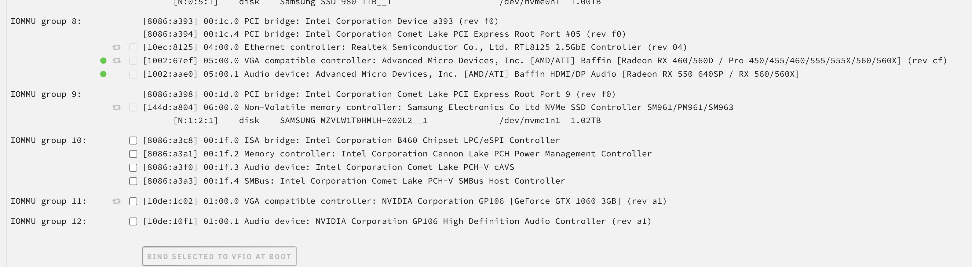

1 hour ago, aikin said:
I have tried swapping the positions of the two graphics cards. then rtx 1063 can't select. It's my motherboard cause ? and is my motherboard not support?
The issue you have is that the 2.5Gb NIC is in the same IOMMU group and all devices in that group would need to be passed through.
Do you have you tired PCIe acs override settings in the VM settings, This may allow the graphics card to show in its own IOMMU Group.

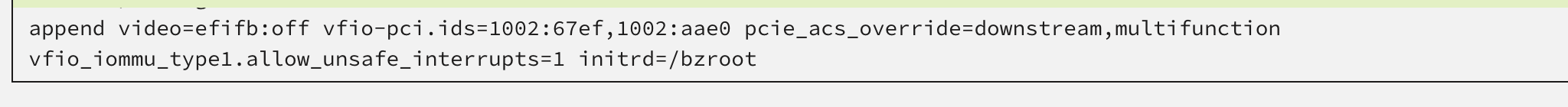

yeah, i have a try, something is going on.
but still can not select... and i have try    vifo-pci.ids=1002:67ef,1002:aae0,10ec:8215 but i lost my network in unraid when i restart the machine.
it looks like the  2.5Gb NIC and rx560 can not separate. so sad. is this mean i can't use this motherboard to do that ? if true, Can you give me some choice of motherboard model to do this?  Thank you very much for your help!
Sorry cannot see this.
I would remove the lines from the append as you can do by ticking the boxes in system devices and this plugin is no longer needed.
But does sound like your motherboard may not be able to separate the NIC and card in that slot.
Did you try both optuins for PCIe ACS Override?

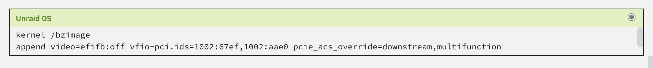

Yeah, I had to select the both option and it will change the unraid os options to here, then  i add vfio-pci.ids options. but still not work.

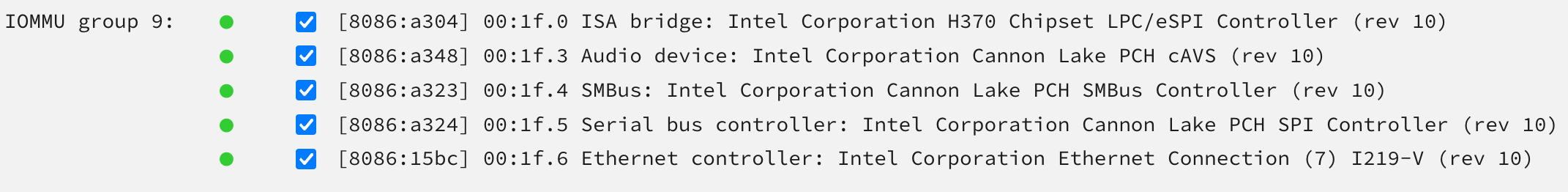

I would like to pass through my motherboard's audio to VM's. However, I'm unable to select the IOMMU group that has the audio device in it. I've tried setting my PCIe ACS Override setting to all 4 options (Disabled, Downstream Multi-function Both). Rebooting after each change. None of the settings changes the IOMMU groups. I have an ASUSTeK COMPUTER INC. PRIME B560M-A motherboard with an 11th gen i5-11600K CPU. I'm also on UnRaid v6.11.1.
Any assistance would be greatly appreciated.
On 11/5/2022 at 12:14 AM, Jeff Trusty said:
I'm new to Linux / UnRaid.

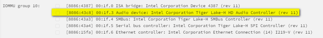

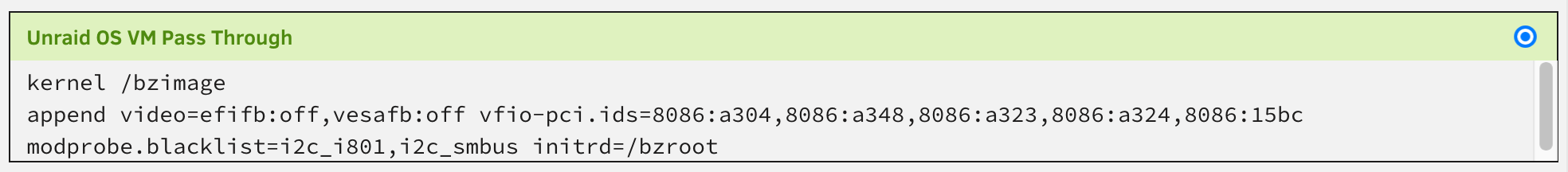

I had the exactly same issue and solved a few days ago.  All the devices in IOMMU group 10 should  be listed in syslinux configuration such as
vfio-pci.ids=8086:4387,8086:43c8,8086:43a3,8086:43a4,8086:15fa
Here is mine:
Once rebooting, the check box from System Devices will be enabled and you can select

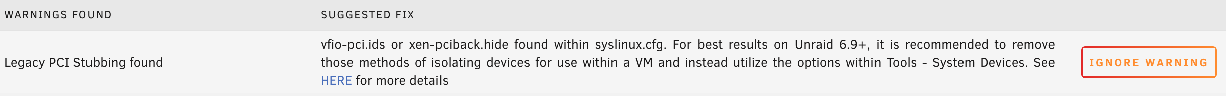

Though Fix Common Problems plugin reports it as a warning, I think it is OK to ignore for now.image.thumb.png.aa053606e4e036eb2744efa60ea96729.png
I think there must be an elegant way to do it without warning, but I cannot come up with a solution now.
Edited by Half Broken Robot

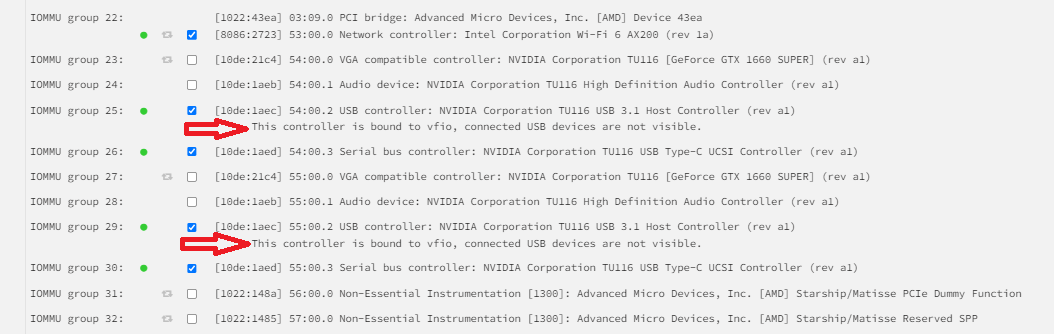

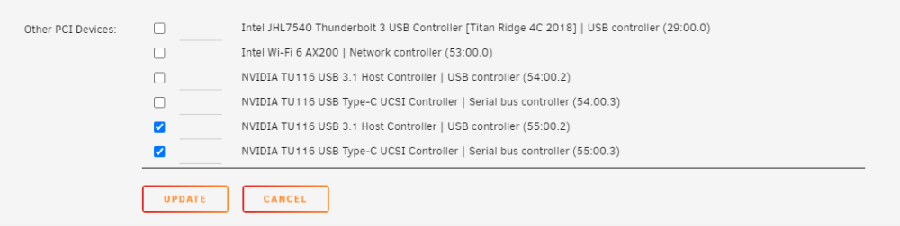

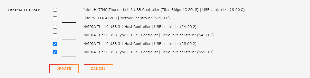

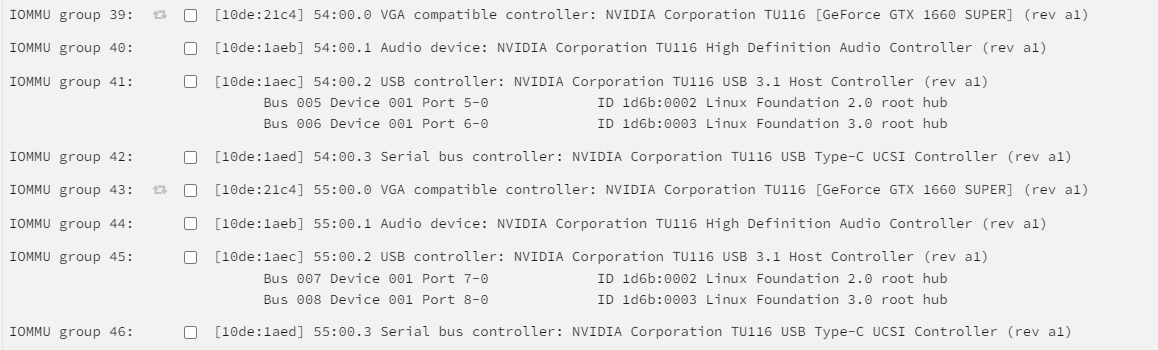

On 1/15/2020 at 11:22 PM, Skitals said:
It now shows USB devices attached to each controller. If a USB controller is bound to vfio, the USB devices will not be visible.

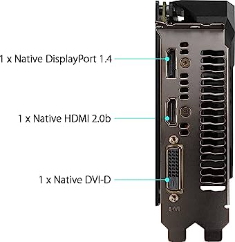

Hello, I would like to understand what this means in other words? I don't know if you can help me with my case.

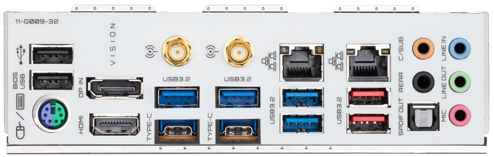

I have two GPUs (TUF-GTX1660S), and in SysDevs this appears, my Motherboard is b550 Vision D
My GPU does not have any USB c or USB 3.1 port
My Motherboard does have a usb c port and usb 3.1 ports
The first question is because this text appears "This controller is linked to vfio, the connected USB devices are not seen", this means that if I managed to connect a usb, and if I have made a passthrough from the GPU to the VM, the usb will it connect directly to the VM and not be seen on the Unraid server?
The second question is, because my GPU indicates that it has a USB 3.1 and USB c controller, if it does not have any physical port, is there an adapter to convert HDMI to USB?
https://www.amazon.com/Adapter-Converter-Thunderbolt-MacBook-Microsoft/dp/B08VDT3YGK
https://www.amazon.com/ELUTENG-Thunderbolt-Compatible-Converter-Connector/dp/B07Z4G911X
Yes, your gpu has a usb controller but no port. Some gpus have usb-c for vr and other uses. There is no adapter that will give you access to it. And yes, any devices connected to the controller would only be visible/usable inside a VM if the controller is bound to vfio-pci.
So unfortunately no way to make use of it. Best practice is still to passthrough all sub-devices together with multifunction on (54:00.0, 54:00.1, 54:00.2, 54:00.3 on the same bus, etc). Typically they would be in the same iommu group, what do your groups look like with acs overrides disabled?

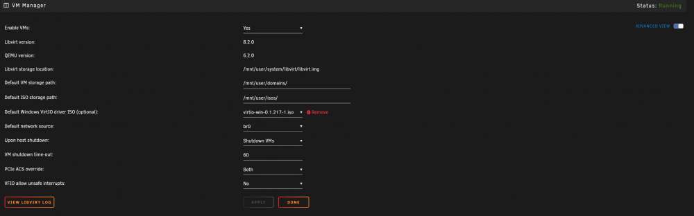

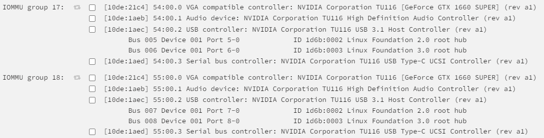

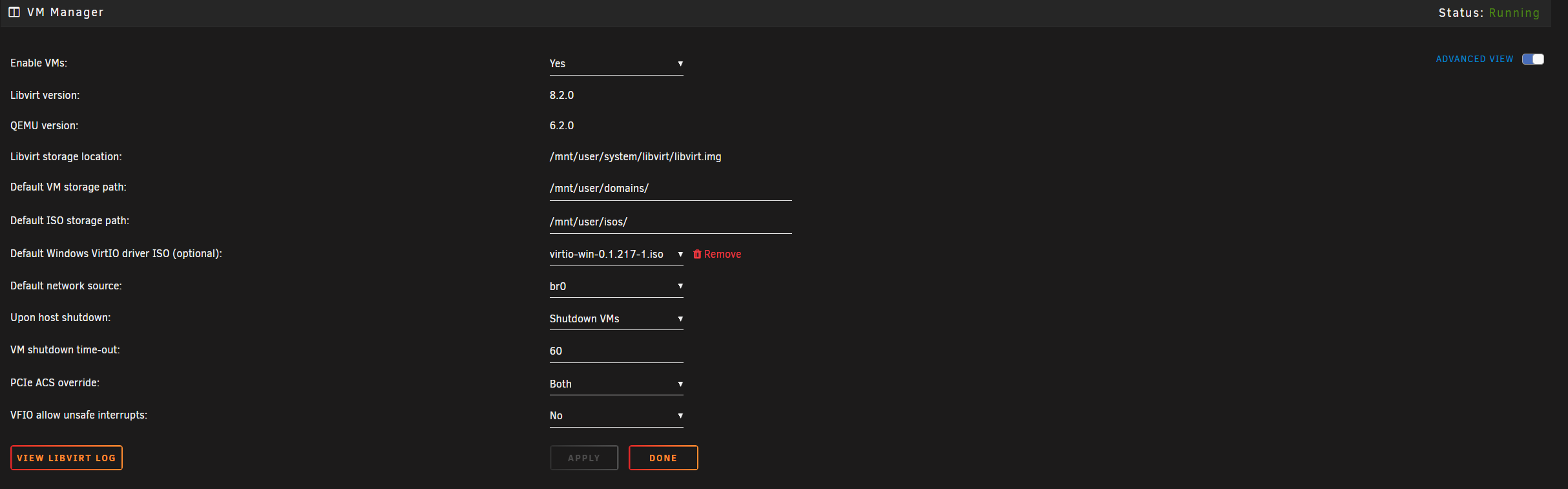

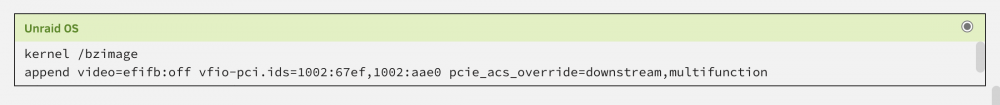

Hi this looks like this
It also changed the PCIe ACS override to "Both" and generated this
Can you think of any way that when connecting a usb device, it connects to the GPUs? in order to achieve the passthrough
