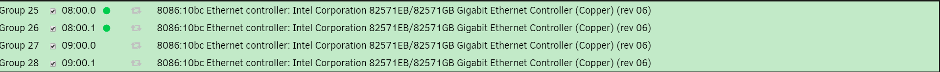

I used the vfio-config plugin to get a 4 port NIC to pass through.
I had to enable acs override to get the IOMMU groups to break up first.  Then I used the plugin to create the cfg file.
These are the for ports I am trying to pass through
IOMMU group 25:	[8086:10bc] 08:00.0 Ethernet controller: Intel Corporation 82571EB/82571GB Gigabit Ethernet Controller (Copper) (rev 06)
IOMMU group 26:	[8086:10bc] 08:00.1 Ethernet controller: Intel Corporation 82571EB/82571GB Gigabit Ethernet Controller (Copper) (rev 06)
IOMMU group 27:	[8086:10bc] 09:00.0 Ethernet controller: Intel Corporation 82571EB/82571GB Gigabit Ethernet Controller (Copper) (rev 06)
IOMMU group 28:	[8086:10bc] 09:00.1 Ethernet controller: Intel Corporation 82571EB/82571GB Gigabit Ethernet Controller (Copper) (rev 06)
The config file adds all 4 of them
BIND=08:00.0 08:00.1 09:00.0 09:00.1
But I only get 2 ports to show in my VM
When I look in the plugin I only have a green orb next to the ones that are being passed through.
Any idea how I can get all 4 ports to pass through?
Is there any specific thing to look for to see why a device chosen in the plugin doesn't bind to vfio, and as such, is not available to be selected in a VM?  So far, I have not been able to pass through anything other than my video card (and it's associated sound).  After trying differnet ACS settings, the card I'm wanting to pass through is grouped with just a PCI bridge (guessing the one it is routed through), so when they are all checked, they still don't bind.
I don't know what would cause vfio-pci to skip devices, but as part of migrating this functionality to Unraid 6.9, everything vfio-pci does during bootup is now logged.  More info here:
  https://forums.unraid.net/topic/93781-guide-bind-devices-to-vfio-pci-for-easy-passthrough-to-vms/
Check it out when 6.9 is released, or try a beta if you are feeling adventurous:
  https://forums.unraid.net/bug-reports/prereleases/
