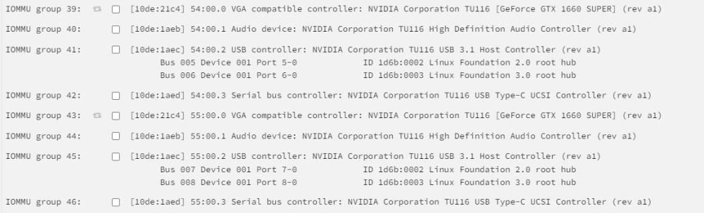

seems like i have a quite similar problem
I am trying to passthrough an pcie-usb controller. It works in unraid, i can bind it with the vfio plugin, and it finally shows up under other pci cards in the vm template.
however, when i add it and start the vm, first the vm gets paused, then the vm tab gets unresponsive and finally the whole server goes dead.
gpu passthrough and everything works, i just need the usb controller to work aswell, so i can make use of my audio interface in macos (but the same problem occurs for win vm)
tried reading and trying all sort of things, but either the pci card doesn't show at all as a passthrough card (connected devices are recognized though, so unraid clearly can work with this card) or the pci card is selectable (obviously the devices do not show, when the pci card is bound) but the vms crash.
I also tried spaceinvaders way with the vfio-pci-ids= add in syslinux line, but didn't really work somehow since the connected devices were still available in unraid, so not sure what went wrong there.
any advice or waypoints i should check out?

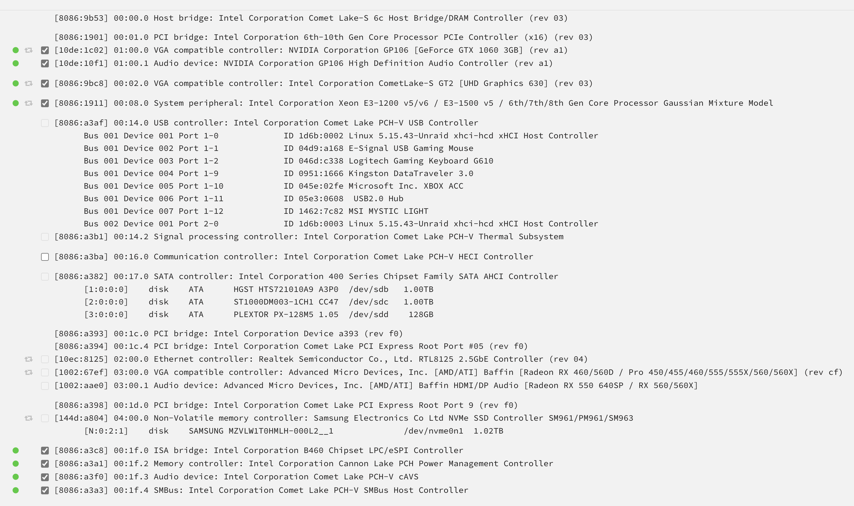

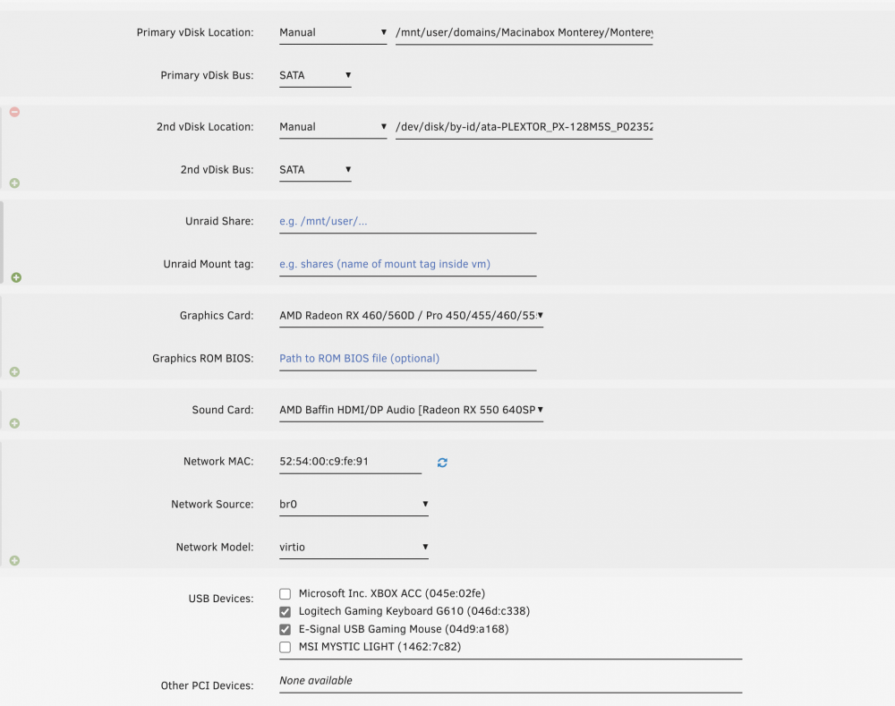

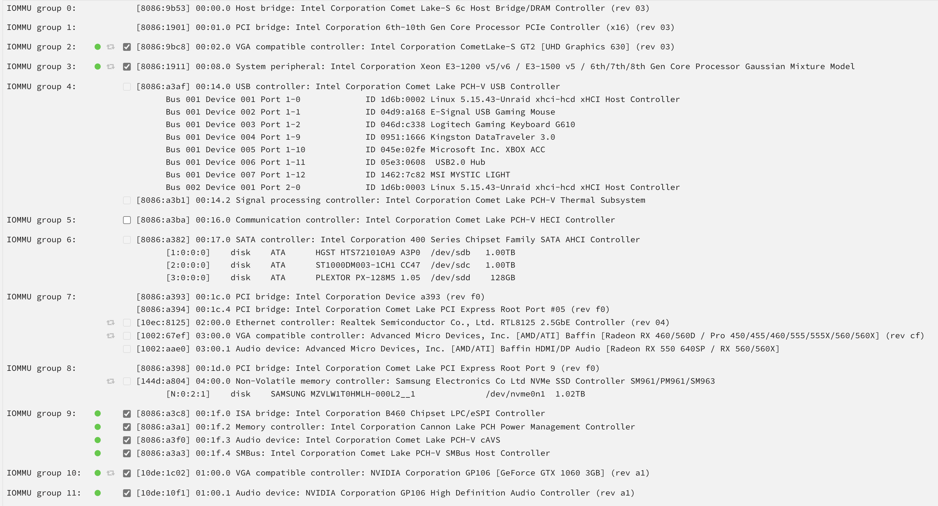

Hi
I have two gpu cards, rx560 and rtx 1063
motherboard:  msi b460m mortar
unraid: 6.10.2

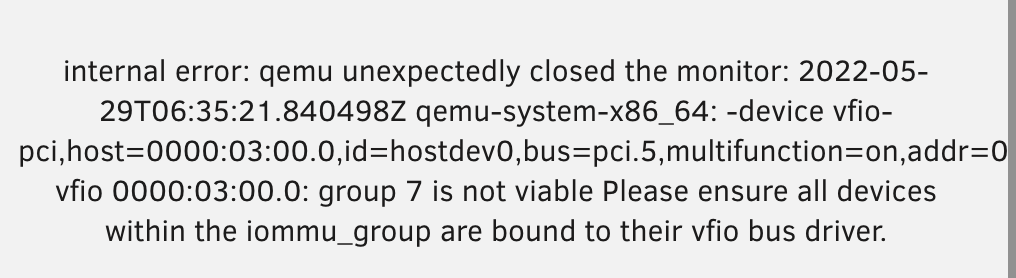

I bind rx560 in my vm and start but it will show errors:
then i go to vfio-pci bind list, like http://192.168.1.10/Tools/SysDevs, it's show here:
I can't select rtx560 to bind, it's grey... i want to know why is that? can anyone help me?
thanks very much!!!
Edited by aikin
lost some messages
57 minutes ago, aikin said:
Hi
unraid: 6.10.2
thanks very much!!!

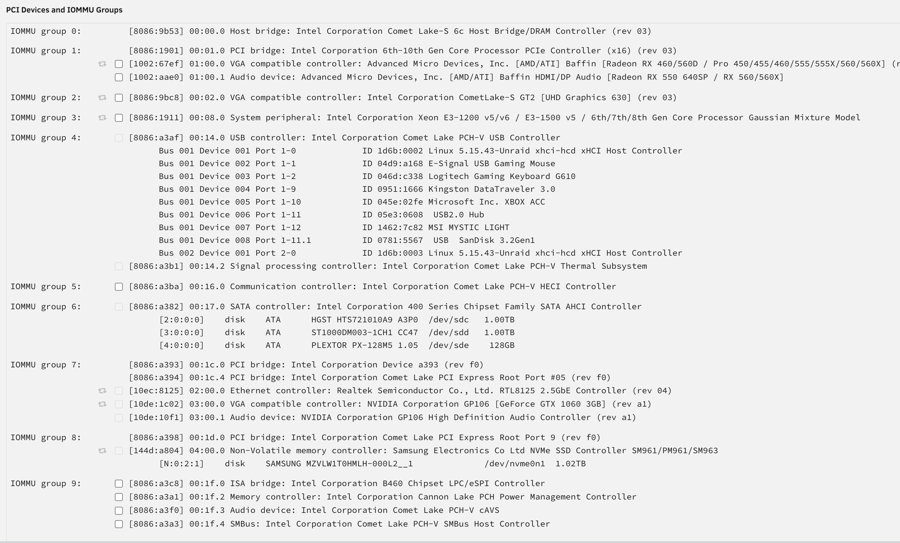

Are you using this plugin as no longer required for the version you are on. Also we need to see the Iommu groups and you and more devices bound to vfio than just the required devices.
The RX is not bound, you may need to change the bindings if you have added recently the 2nd as that could change allocations.

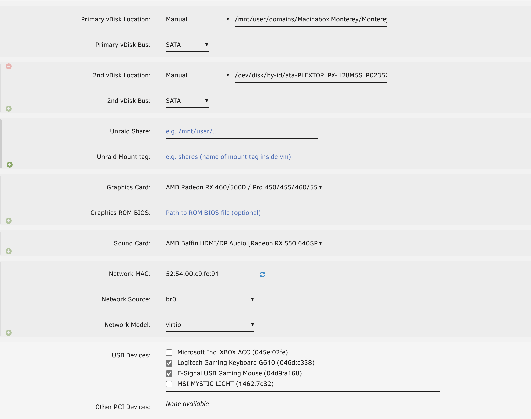

OK,I can give your more screen picture. It's all bindings.

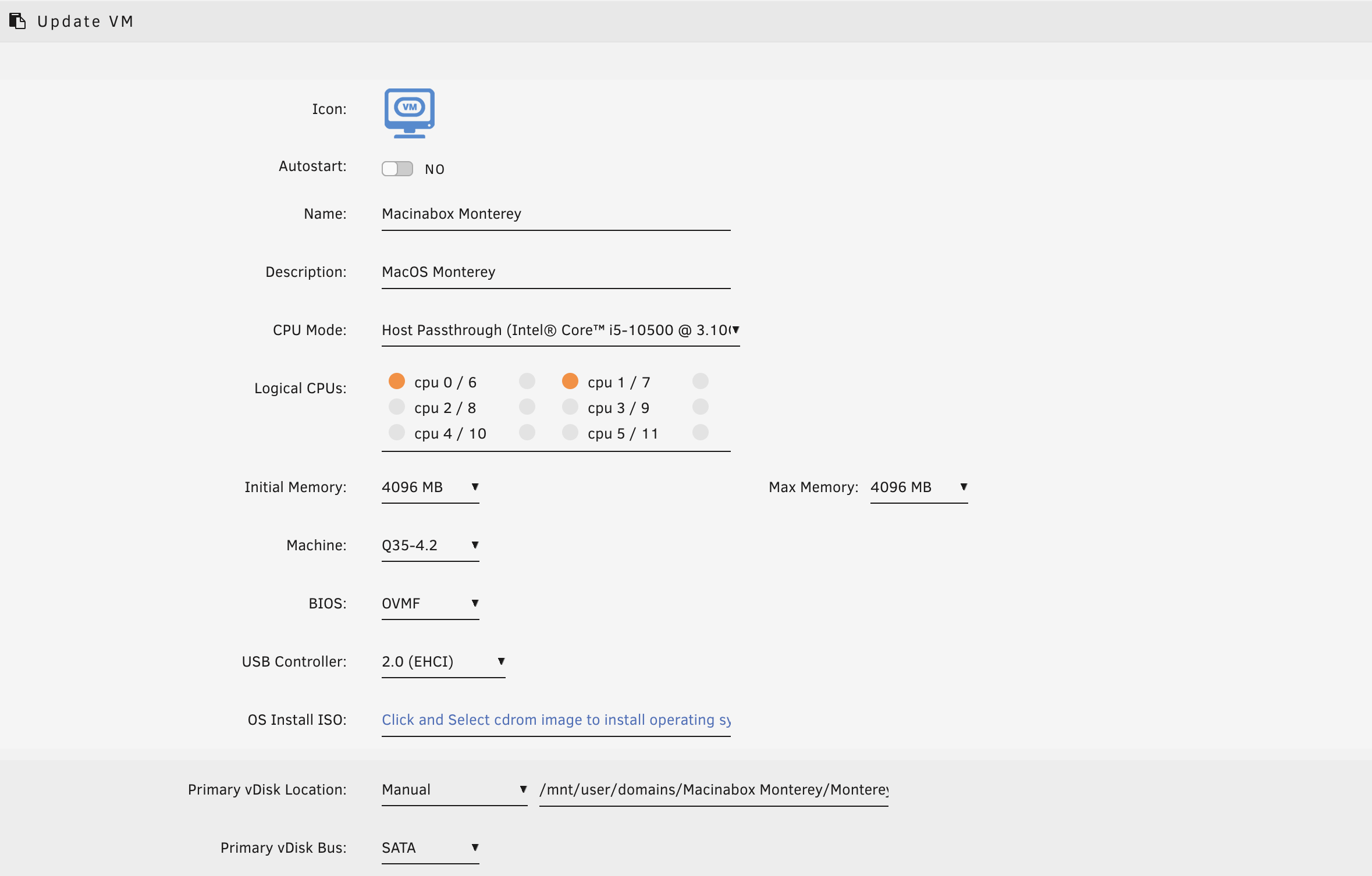

and my vm device setting
and full xml

finally, you said i need to change the bindings? how ? thanks your quickly replay!!
Edited by aikin
messages
I have tried swapping the positions of the two graphics cards. then rtx 1063 can't select. It's my motherboard cause ? and is my motherboard not support?
