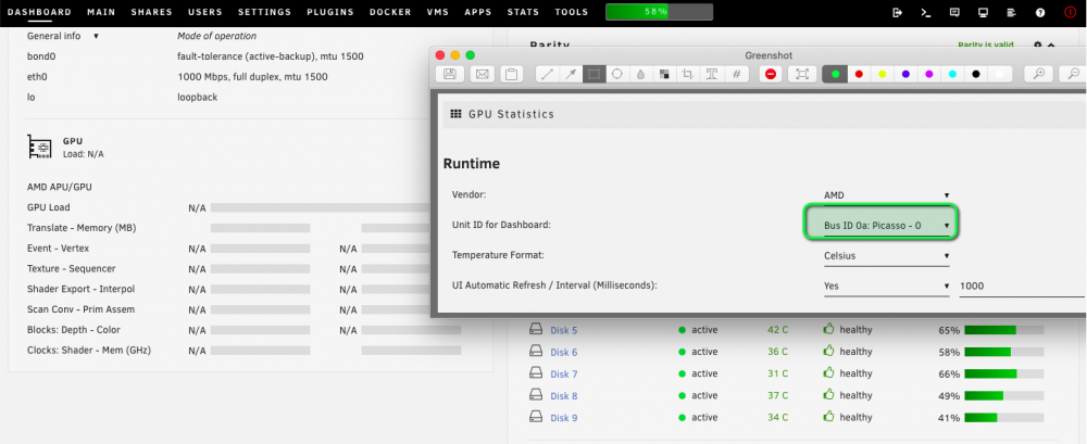

root@NASIR:~# lspci | grep VGA
0a:00.0 VGA compatible controller: Advanced Micro Devices, Inc. [AMD/ATI] Picasso (rev c8)

I was hoping your issue was the same as @jungle's, but it isn't.  I had to adjust the inventory regex again to make their card recognized by the plugin, but yours was working with the original regex.  If the card isn't showing up you are likely not reaching the inventory code for some reason.  Can you run this in in the console:
I had to expand the inventory regex a tiny bit to cover yours.  Once I release a new version of the plugin it should start working, hopefully.

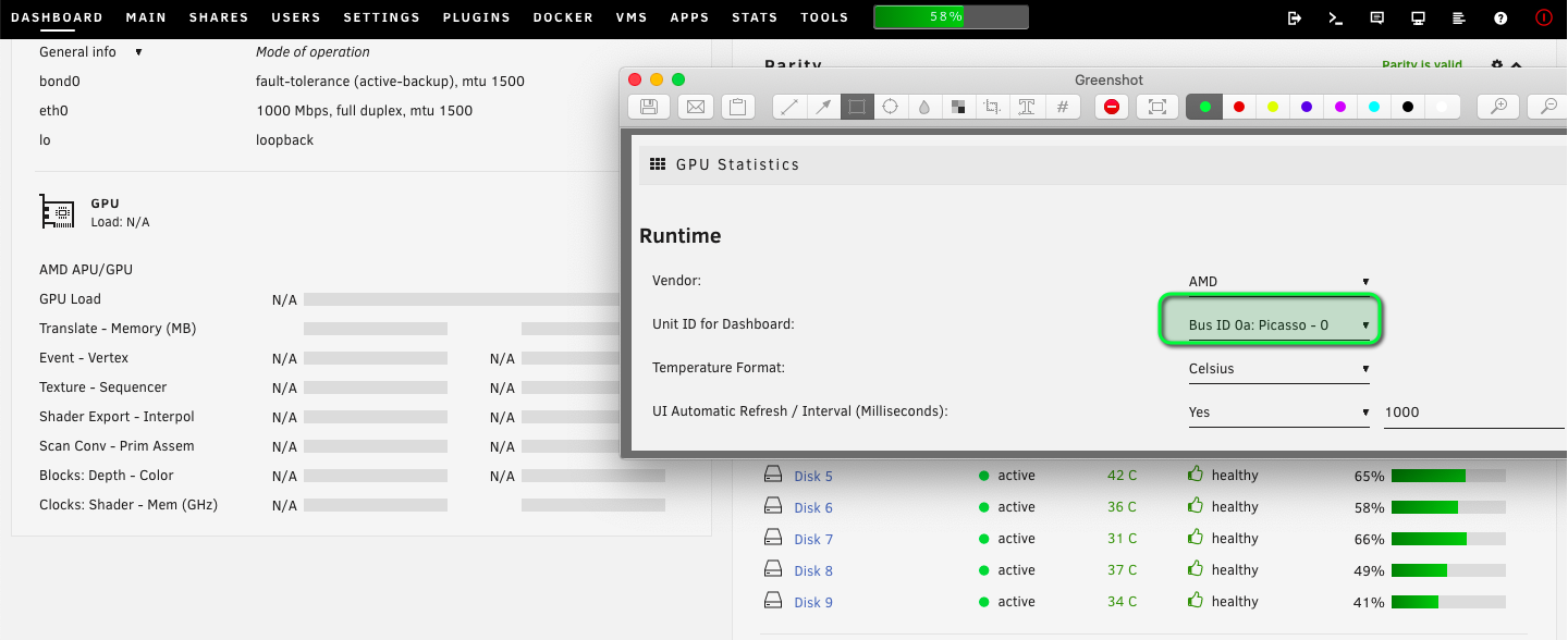

The Unit ID is picked up now but the Dashboard still has N/A on everything. Do I need to unblacklist the amdgpu drivers? https://forums.unraid.net/bug-reports/prereleases/unraid-os-version-690-beta35-available-r1125/page/11/
Sigh.  I forgot to remove the int cast before it gets sent to the Settings page.  Pushed yet another update.  Re-install or update if available and then run through the settings again making sure to apply at least once to take the new BUS ID.
It's ALIIIIVE! Thank you sir :) Where can I donate to you?
