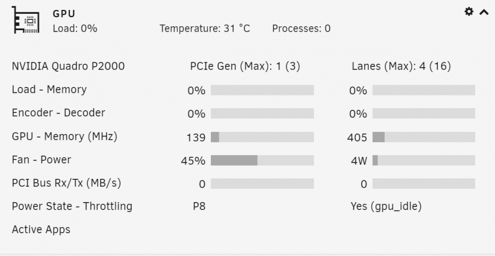

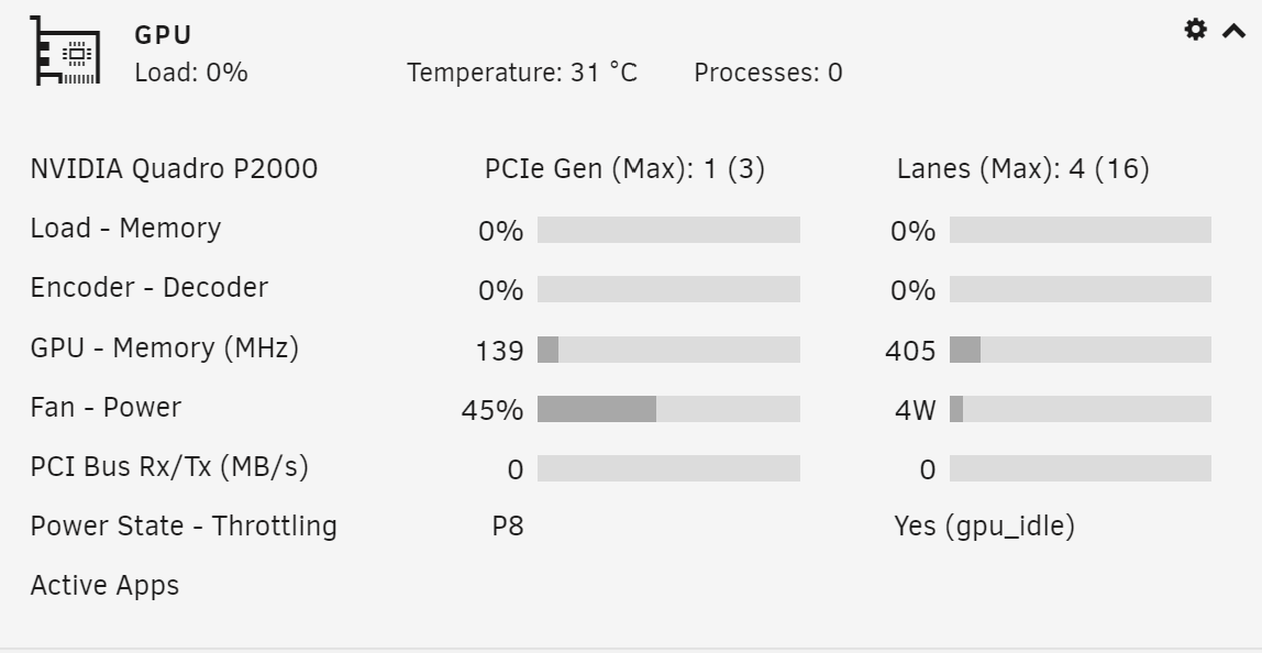

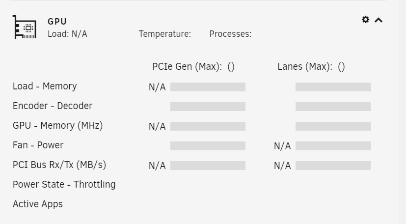

I just threw in a Quadro P2000, and i'm noticing that plex shows that it is transcoding, but no statistics are showing on the dashboard:
This screenshot was with a video playing.
Could an old mobo bios be the cause?
here's what my app info looks like:
Edited by danimal86

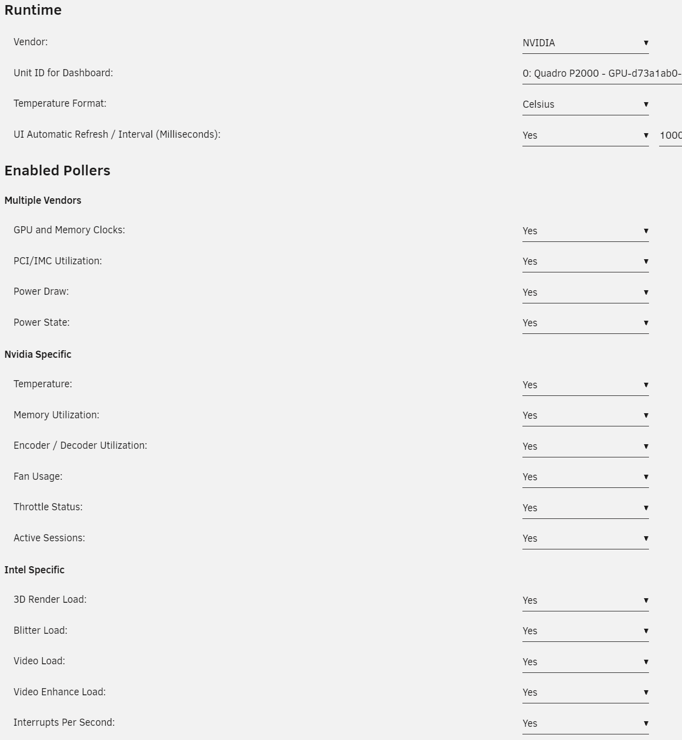

I need the info from the troubleshooting section in the first post of this thread. The first picture is helpful but it really depends on what you’re getting from the main PHP routine. That’s the one where you run gpustatus.php manually in the console. My guess is it’s reaching an error.
I changed the Vendor from Nvidia, to change me, and back to Nvidia and its working now

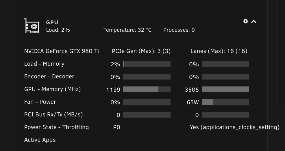

First up, thanks for making the plugin. worked perfectly straight away.
I do however have 1 question.
I can see that I get the attached.
My output is as follows.
root@Tower:~# nvidia-smi -q -x -i 0

Any idea how to fix the " Yes (applications_clocks_setting)" issue I am having?
Cheers

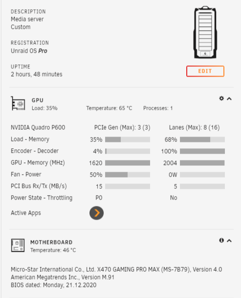

So 1 small nag (maybe a feature request) and an actual enhancement request:
Transcoding using handbrake NVENC, but the icon not showing in the UI. From an at-a-glance standpoint, would be nice to have that included.
The other "issue" I have is my GPU name is stupid long "Nvidia TITAN Xp COLLECTORS EDITION" - is there a way to make that editable so the characters don't overwrite/overlap each other?
That is a funny problem to have.  I think most cards are identifiable within three words.  I can probably manipulate it so that if it exceeds a certain length to only take the first three words or something like that.  File an issue on Github so I can remember to include in the next release.

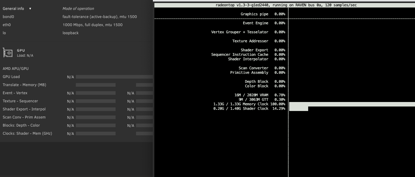

Question. I have a Ryzen 5 3400G APU and I've installed the GPU Stats and Radeon TOP plugins (Radeon TOP installed first) - I can see some activity when in the CLI and running radeontop but there is no activity on the dashboard. Am I missing a step or is this due to the APU?
I'm guessing you weren't able to select the APU device in the Settings page.  It's because the regex I'm using to capture the inventory doesn't expect non-numeric characters in the Bus ID (yours is 0a).  I will add this to my fixlist and release an interim update shortly.
Hey @b3rs3rk you got it. Drop down doesn't allow any selection.
