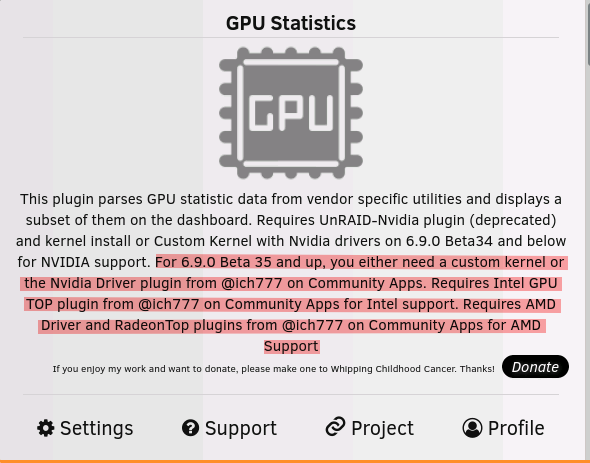

I just wanted to stop in and say thanks for making this plugin. My transcoding GPU has been acting up for while, but I wasn't sure what the problem was. This plugin helped me see that the temp was high and the fan wasn't working. Turns out I had a stray wire blocking the fan's operation. So thanks again, I appreciate it.
Deepstack and DisqueTV app detection released.  Emby detection has been removed due to false positives.  Until we define a method to uniquely determine ffmpeg is being launched by Emby it will remain disabled.

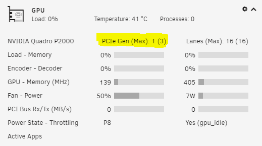

Is this info accurate?
How can I be sure if it's using version 3 or 1?
The first figure is usually dynamic based on the power state.  To reduce power consumption, the card uses Gen 1 when idle and ramps up to the maximum as determined by the power state.  The value in the parentheses is the maximum of your card or your PCI express bus capabilities and is static.  My maximum, for example, displays as Generation 2 because I'm using an older motherboard/chipset even though the Quadro P4000 I'm using can use 3.0.

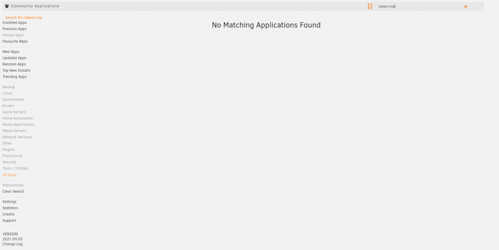

can someone help me out? i have a vega 64 frontier edition that im trying to setup on my server for mining till plex encoding starts to work for AMD but when i try to install GPU statistics from the CA it throws the following error and I am not sure how to proceed

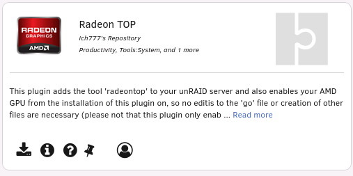

You have to install the Radeon-TOP Plugin from the CA App so that GPU Statistics can work.

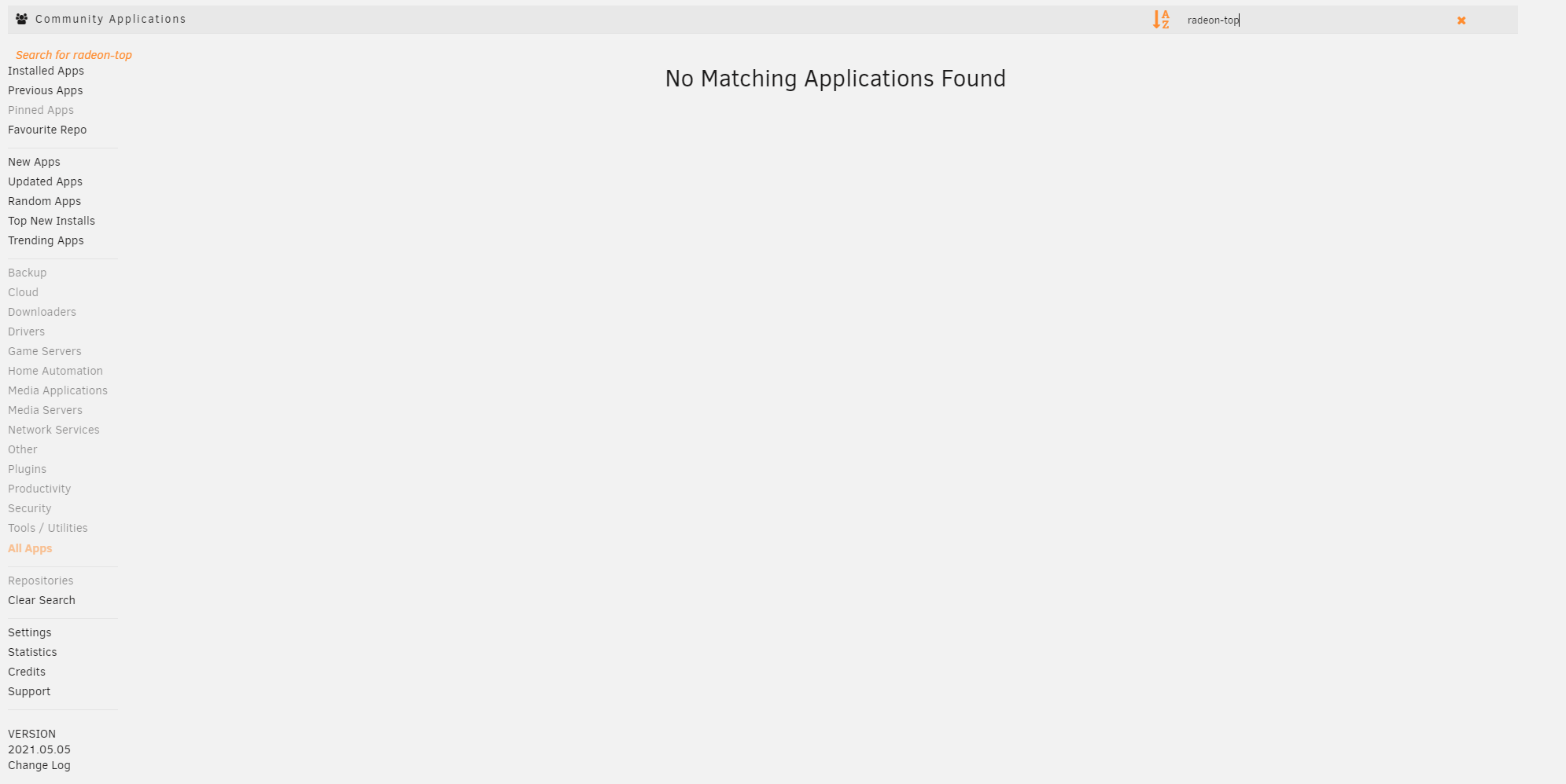

I have the CA plugin and updated but it does not return any results when searching for radeon top. sorry for all the screenshotsimage.thumb.png.74e79fced4341915a3674f79afa7073d.png
You also can search for parts of the name like in this case 'Radeon' and you will find it too. :)
Please also keep in mind the description of the GPU Statistics says that you actually need a vendor utility Plugin like Nvidia-Driver, Radeon-TOP or Intel-GPU-TOP.
