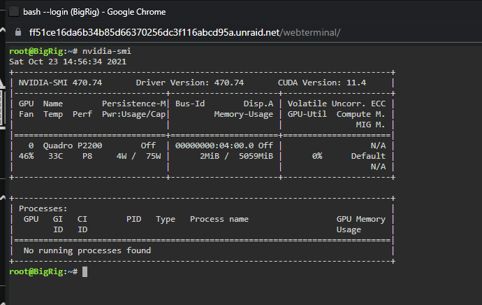

On 10/22/2021 at 1:56 AM, ich777 said:
The same as in the the post that I've linked (a few posts above) applies to your card:
nvidia-smi attached below:
You have already posted the screenshot from nvidia-smi, this answer was not yours...

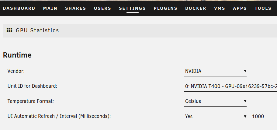

Have you made sure that you have set the right card here in the plugin settings:
On 10/22/2021 at 2:06 AM, ich777 said:
Have you selected the right card on the plugin settings page?
image.thumb.png.9609c7039de0451bbf469f14b3357bf1.pngYes, with all options toggled to on.

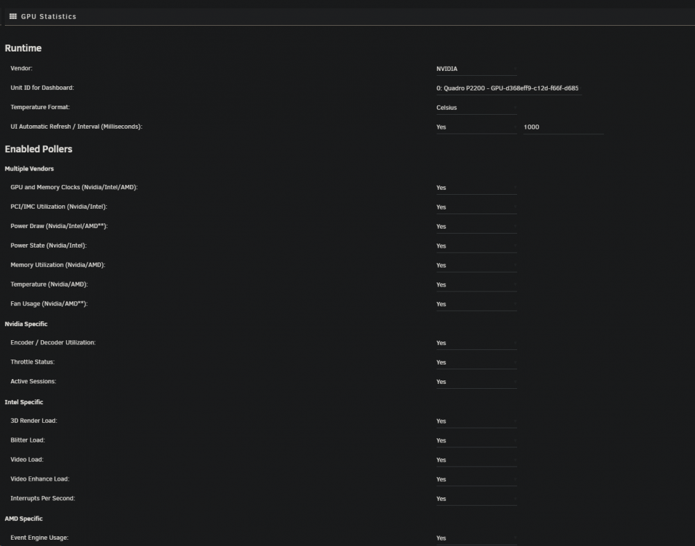

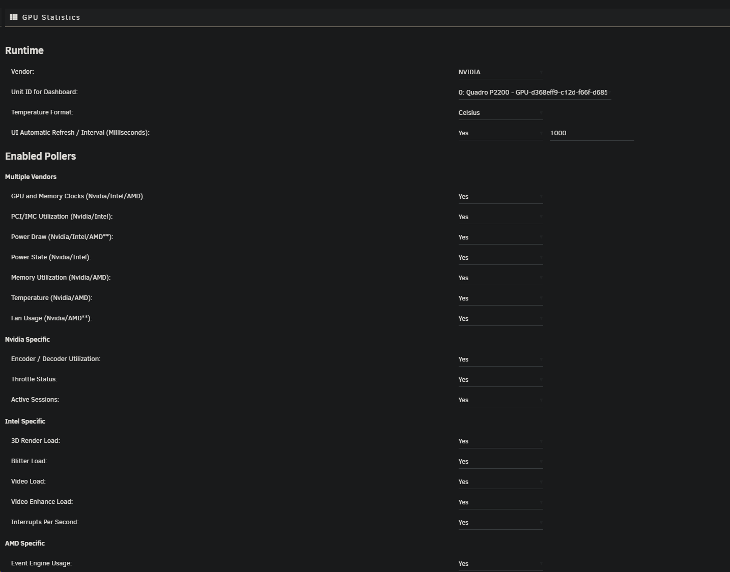

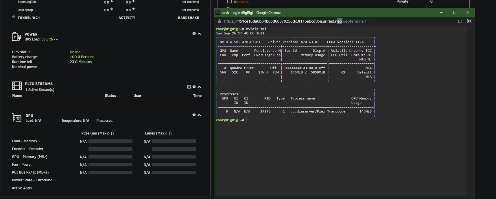

On 9/26/2021 at 6:42 PM, mihcox said:
Im having issues with my p2200. It works and transcodes as excpected, but no statistics load on the homepage. NVIDIA-SMI still works in the command line though.
Any ideas?
Some kind of error when the actual statistics collection process is triggered which is returning no data or an empty array most likely.  Please read the first post of this thread and include the result of the troubleshooting step that involves running the PHP script from the CLI.  I'm not going to copy paste it for everyone that chooses not to read it.  Hint:  It is Step 2.

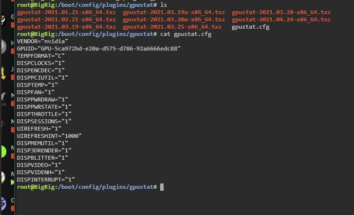

But this PR was "by accident", because mainly I was troubleshooting why my AMD Card don't get shown.
On Paper the sensor data are there. They also get exported via telegrafs sensor plugin.
But on the unraid dashboard, the panel is empty if I select AMD Vendor in the Settings.
Radeontop is installed and running.
Any Ideas?
I have reviewed your PR.  Please check that out when you have the chance.  The work looks fine, just need a couple things changed and the PR re-opened to the dev branch.
There are ways to determine what is calling the ffmpeg process.  I do that for deepstack because nvidia-smi only shows python3 is running.  I dig out the PID info, check some of the extended information and make a positive match that way.  Might be doable with whatever third application you wanted to add as well.
As for your stats not showing up for your AMD card the GPUID setting in your config file needs to reflect the BUS ID of the AMD device.  Yours is still showing the UUID for your Nvidia card which will cause it to fail.  Probably a bug on my part but this is likely caused by you switching back and forth.

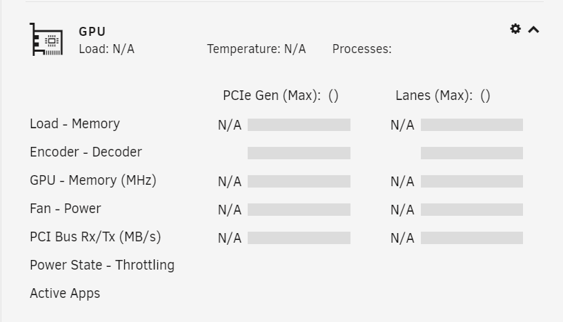

My dashboard doesn't show any information. Debug info:
nvidia-smi -q -x -i 0:

cd /usr/local/emhttp/plugins/gpustat/ && php ./gpustatus.php:
{"clock":"N\/A","fan":"N\/A","memclock":"N\/A","memutil":"N\/A","memused":"N\/A","power":"N\/A","powermax":"N\/A","rxutil":"N\/A","txutil":"N\/A","temp":"N\/A","tempmax":"N\/A","util":"N\/A","error":[{"code":302,"message":"Vendor command returned unparseable data.","extra":""}]}
a screenshot of the dashboard plugin:
Seems like your card dosen't report any values to nvidia-smi or better speaking the other way around.
What driver version are you using? Please keep in mind that the driver version v470.74 is the last one that supports 6xx and 7xx cards, the newer ones (at time of writing v495.29.05 & v495.44) doesn't support those cards.
470.74 because, as you say, the 490 series doesn't support my card. :)
Yes, then Nvidia messed up again nvidia-smi and it won't report any relevant stats from your card.
Sadly enough there is nothing @b3rs3rk or me can do about this because this is related to nvidia-smi.

@mihcox That's all valid XML, and should meet all the criteria my code requires to not hit the error you're getting.  Something else must be going on.  Try this:
php -r 'var_dump(@simplexml_load_string(shell_exec("nvidia-smi -q -x -i 0")));'
Looks to be valid as well:
login as: root
Keyboard-interactive authentication prompts from server:
| Password:
End of keyboard-interactive prompts from server
Linux 5.10.28-Unraid.
root@BigRig:~# php -r 'var_dump(@simplexml_load_string(shell_exec("nvidia-smi -q                                                                                                                                                                                                                                              -x -i 0")));'

@mihcox Could you show me the contents of your gpustat.cfg in
/boot/config/plugins/gpustat
17 hours ago, mihcox said:
No need to paste the result of this unless it gives an error:
nvidia-smi -q -x -g GPU-5ca972bd-e20a-d575-d786-92a6666edc88
Just want to confirm your nvidia-smi polling works with the configured GUID.  You are missing some configuration settings, but they are the ones for the AMD monitoring and shouldn't have any effect.  Still, might try to remove and reinstall the plugin completely (including deleting the /boot/config/plugins/gpustat directory after uninstalling the plugin from the UnRAID UI).
EDIT:  This is the problem.  Based on your previous screenshots, the GPU GUID in your config file is different from the one you posted for @ich777 from the settings page.  You need to re-save your settings especially when switching cards.  I'm guessing you replaced your old GPU with a new one and the GUID of the old one is still saved.
Edited by b3rs3rk
