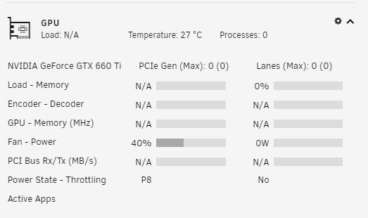

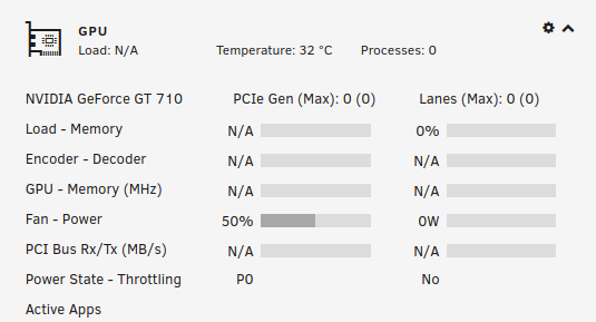

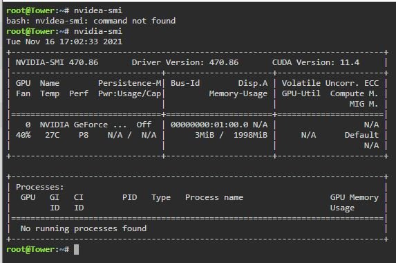

Hello, I am having similar problems as others.  My GPU is recognized by the driver install 470.86.  Plex is transcoding in HW, but there is no information in GPU statistics, just the fan speed of 40% and temp.  GPU is a GTX 660ti (don't judge...haaa).  Any thoughts?
Vendor is also set to Nvidia
also using 6.9.2 Unraid version
Edited by Everest
On 11/15/2021 at 11:39 PM, Big Dan T said:
Soooo, best I can find is @ich777 saying ignor it ?
You can also do this:
Please read the comment above and also the linked post, your card doesn't report this values through nvidia-smi and there is nothing @b3rs3rk or I can do about that.

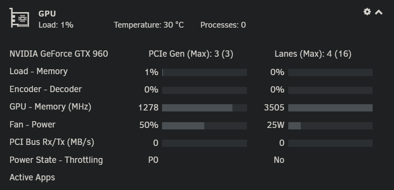

Hello!
New guy here, fresh to the Unraid scene.
I have an Nvidia GTX 960, I have installed the correct Nvidia driver, currently version 495.46.
After installing GPU Statistics, it appears to be working normally, aside from this issue:
When I access the Unraid dashboard through a web browser, the GPU's fan will go from 0% immediately up to 50%, then gradually fall back down to 0% over the course of about 12 - 14 seconds, will stay at 0% for about 5 seconds, and then the cycle repeats as long as I have the Unraid dashboard open.
There is no intermittent load on the GPU that I can see causing this to occur, all of the statistics other than "Fan - Power" are accurate and do not change (i.e the server is idle).
I have seen others here include their "nvidia-smi -q -x -i 0", so I will attach mine in .txt form below, along with a screenshot of the widget on the dashboard, in hopes of assistance.
If further information is required I will gladly provide it.
Thanks in advance!
nvidia_smi_log.txt
I too am having this issue as well... I tried the nvidia-persistenced --persistence-mode and it didnt change a thing... still have yet to get hw transcoding to work... so maybe it's something on my end...
| NVIDIA-SMI 470.94       Driver Version: 470.94       CUDA Version: 11.4     |
| GPU  Name        Persistence-M| Bus-Id        Disp.A | Volatile Uncorr. ECC |
| Fan  Temp  Perf  Pwr:Usage/Cap|         Memory-Usage | GPU-Util  Compute M. |
|                               |                      |               MIG M. |
|   0  NVIDIA GeForce ...  Off  | 00000000:06:00.0 N/A |                  N/A |
| 50%   32C    P0    N/A /  N/A |      0MiB /  2001MiB |     N/A      Default |
|                               |                      |                  N/A |
| Processes:                                                                  |
|  GPU   GI   CI        PID   Type   Process name                  GPU Memory |
|        ID   ID                                                   Usage      |
|  No running processes found                                                 |
On a side note... does this look correct? I dont have the option to check the box or not... this is my only CPU in the system
Edited by mathomas3
thought that I would be smart and try to use the CPU graphics card and force the motherboard/OS to use it and free up the GPU... but on boot...
and the nvidia plugin has reverted to the device is in use... ???

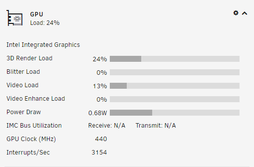

Hopefully an easy one. Any ideas why my IMC Bus Utilization shows blank? Is that something that requires a discrete GPU?
Please post your Diagnostics, what CPU are you using, without that nobody will be able to help.
Don't know if the Integrated Memory Controller Bus Utilization is that important to you... You can also disable it if you want to.
