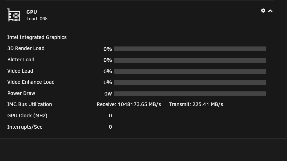

IMC Bus Utilization is always active, is this normal? Also, the Power Draw also seems to be "full" even though 0W is consumed
Well that's the Integrated Memory Controller... Hope that makes it a little bit clearer what it is and what it does.
That's a bug in the intel_gpu_top executable and nothing that could be easily solved for now...
Can you share your diagnostics so that I can send it to the developers from the intel_gpu_tools so that they can take a look at it?

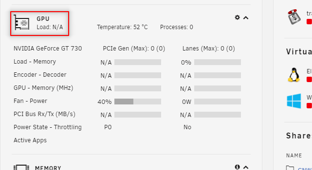

I have put a GTX 760 into my setup today, but for some reason the only data that displays is the Temperature and Fan Speed on the dashboard.
nvidia_smi_log.txt
I have the same problem on my recent install of the GPU Stats app.
On 9/2/2021 at 6:49 PM, shimi269 said:
GTX 760
Both of you, can you please open up a terminal from unRAID and issue the command 'nvidia-smi' (without quotes) and post the output as a screenshot here?
The main problem is that this two cards are really old by nowadays standards and it is very common that these cards report not much anymore through nvidia-smi, this is a common problem with older Nvidia cards and there is nothing @b3rs3rk or I can do about this.
May I ask for what both of you are using the card? Also keep in mind that Nvidia dropped support for 6xx & 7xx series cards and will not be supported with the next driver release (Nvidia driver 470.xx.xx is the last one that supports those cards).

Im having issues with my p2200. It works and transcodes as excpected, but no statistics load on the homepage. NVIDIA-SMI still works in the command line though.
Any ideas?
Hello, After installing, dashboard show the fan % , but encoding and decoding show NA... and the load show NA as well... may i know is there anything i have done wrongly?
Edited by spacezmonkey
The same as in the the post that I've linked (a few posts above) applies to your card:
Any ideas?
Have you selected the right card on the plugin settings page?

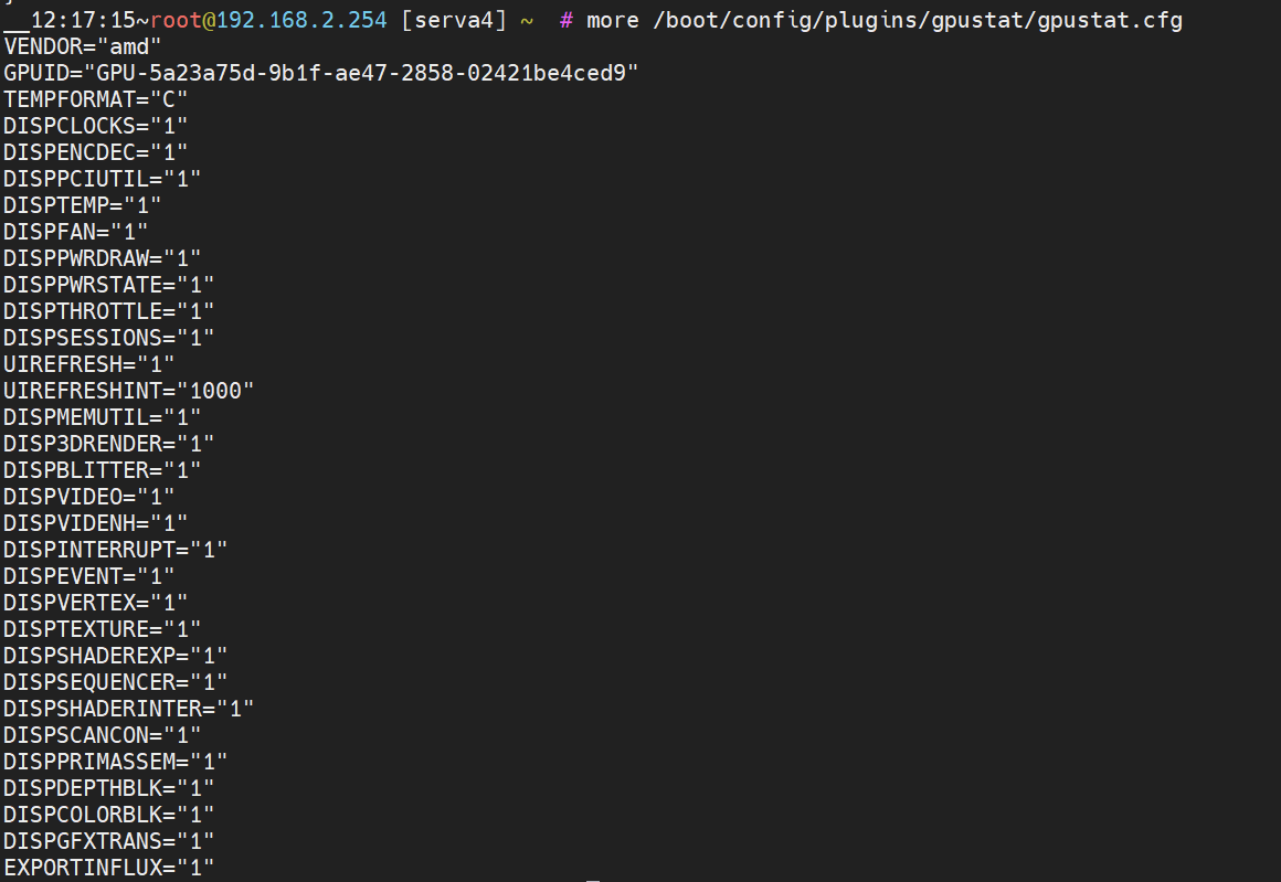

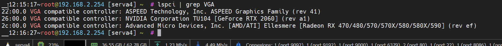

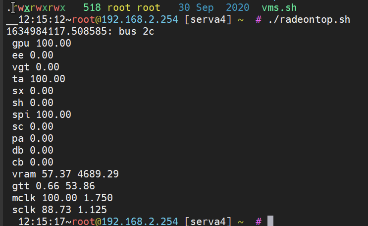

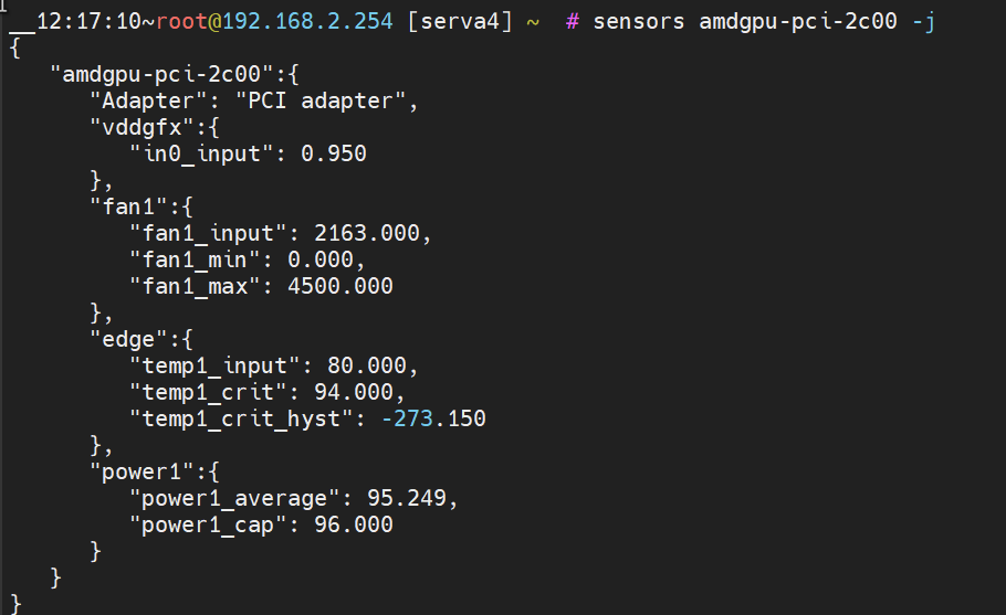

Hello again,
I just made a PR on Github, in which I added support for two more App, Shinobi and nfsminer.
Sadly the third app is ffmpeg coming from frigate, but there is no clear identifier to be sure that this ffmpeg binary comes from frigate.
But this PR was "by accident", because mainly I was troubleshooting why my AMD Card don't get shown.
On Paper the sensor data are there. They also get exported via telegrafs sensor plugin.
But on the unraid dashboard, the panel is empty if I select AMD Vendor in the Settings.
Radeontop is installed and running.
Any Ideas?
