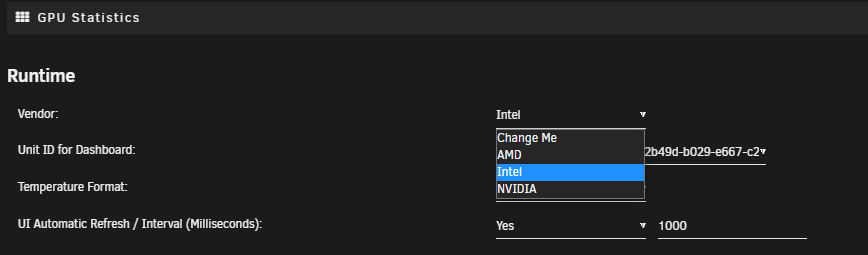

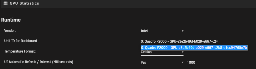

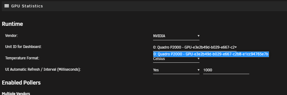

I can't understand, I can't get my intel 9900K to show up. Only get to choose my P2000.
I got the Intel-GPU-TOP installed.
Anyone see why?
Thank you!
Can you please be a bit more specific?
Where can you choose only your P2000?
The driver for your iGPU is already loaded from what I see from your Diagnostics, have you passed through the device "/dev/dri" to a container (not a path!).
Or do you mean in the GPU Statistics plugin?
In the GPU Stat Plugin
I have set /dev/dri to Plex this weekend, but it did not even work before that. Not even when I remove it..
What does the Vendor drop down display?
 Even when I select Intel at Vendor, can still just see P2000 in the drop down.
@b3rs3rk can you help here? Something seems wrong...
