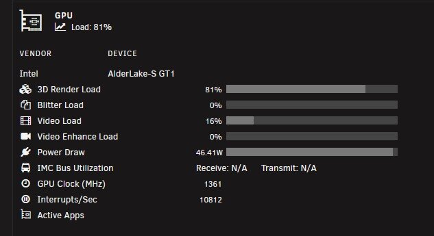

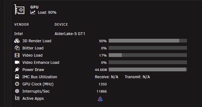

In my case, using Jellyfin and forcing to transcode, I'm getting this:
The load is always 0%, nothing in 3d render load and also nothing in active apps.
3D Render Load is usually only utilized when you transcode HDR source material (of course with HDR transcoding enabled in your Jellyfin settings) because this uses OpenCL.
It always depends on the workload that you throw at your iGPU which bars show load.

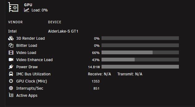

I see. Forcing in the browser a transcoding to 720p it shows also activity in 3d Render Load and also up, in the GPU Load %.
But in a normal transcoding the overal Load is always 0%. Do you know why?
Also, I have to configure something else to show Jellyfin in Active Apps?

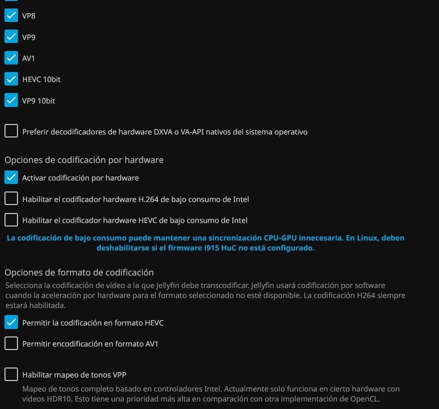

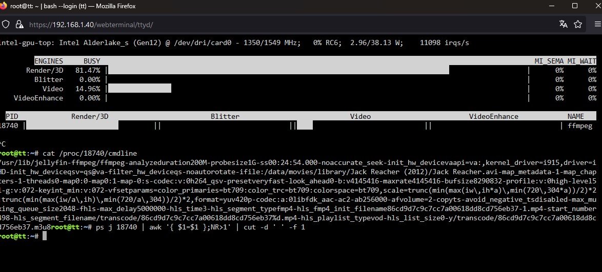

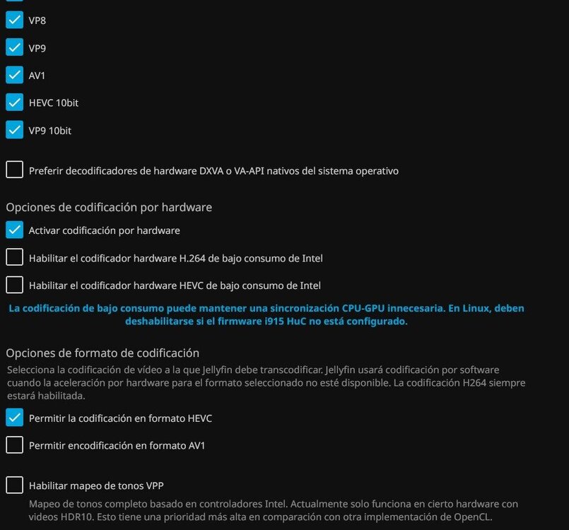

I was also playing a bit with Jellyfin transcoding configuration. After disable hardware docoders of OS and disable also the intel low-power hardware decoder options, the 3D Render Load and Load % are now working always.
Still not working the Active Apps, inside nvidia settings.

Was transcoding in progress when you copied the file as no client info in there. Other option is to run intel_gpu_top.
Looking for this info to id the app.

Not at that time. Now I just updated the plugin version and tried again.
gpudata00000002.0

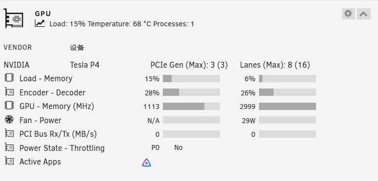

I am just using emby and use its own hardware acceleration setting.
I 've tried plex before, it shows the active app correctly. Jellyfin also works well as shown in the screenshot.
In the terminal, the analysis when using Jellyfin can be seen below.

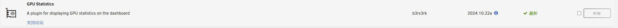

 I 've updated the plugin and tried again, the "active app" still remain the same
screenshot of plugin:
version of plugin:
analytical statistics:

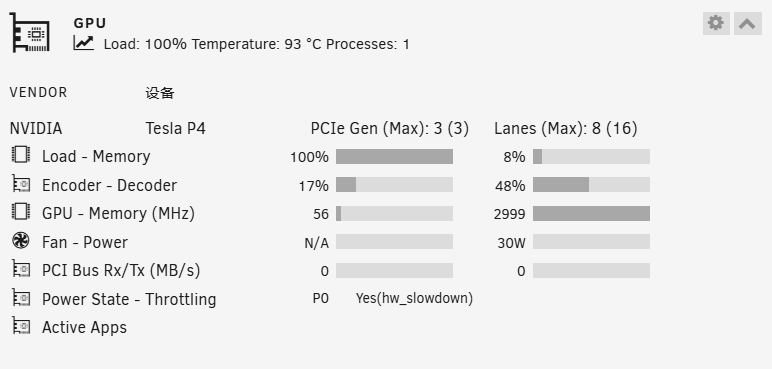

Wed Oct 23 22:24:06 2024
| NVIDIA-SMI 555.58.02              Driver Version: 555.58.02      CUDA Version: 12.5     |
| GPU  Name                 Persistence-M | Bus-Id          Disp.A | Volatile Uncorr. ECC |
| Fan  Temp   Perf          Pwr:Usage/Cap |           Memory-Usage | GPU-Util  Compute M. |
|                                         |                        |               MIG M. |
|   0  Tesla P4                       Off |   00000000:06:00.0 Off |                  Off |
| N/A   93C    P0             30W /   75W |     615MiB /   8192MiB |     87%      Default |
|                                         |                        |                  N/A |
| Processes:                                                                              |
|  GPU   GI   CI        PID   Type   Process name                              GPU Memory |
|        ID   ID                                                               Usage      |
|    0   N/A  N/A     26939      C   /bin/ffmpeg                                   612MiB |
I have a Intel i7 12700K, the gpu stats have been working for over a year, but for some reason recently it doesn't display anything. The iGPU is working and i can see it woking in Plex with HW transcoding. If i change the gpu stats to my discrete GPU a NVIDIA 3050 that i use for a VM that displays information. Not sure what to do to get this to work again?
Look some messages back. You have to modify the timeout settings in the plugin.

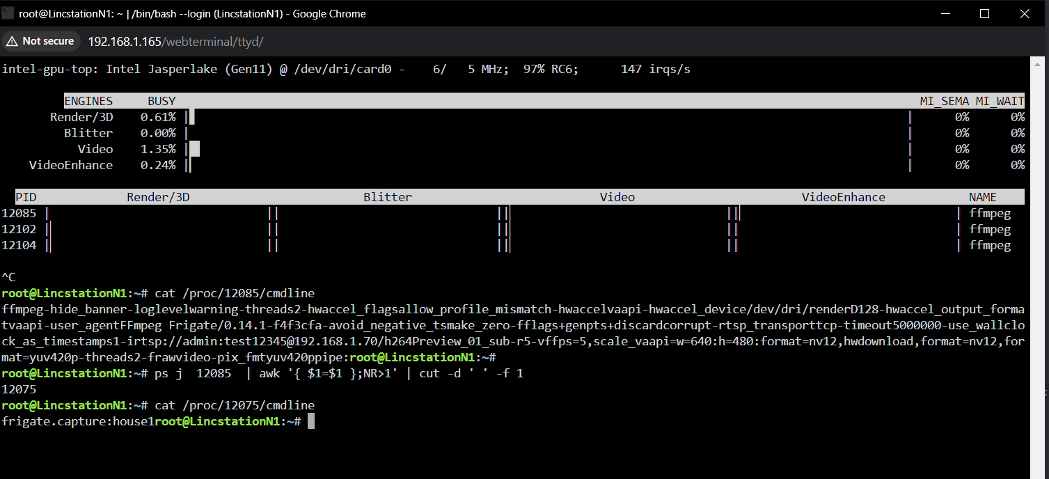

Does any apps show when you run intel_gpu_top
I need this info to check plugin is correct for intel
@tonywang1201 Can you do the same for emby?
Here ya go.
Forgot to add.
Things like Fileflows, Tdarr and other things show, just Emby that doesn't.
