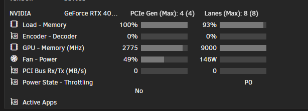

16 hours ago, alturismo said:
in your current screens it doesnt look like anything is currently using de/encoder ...
may rather post a screen while you transcode and what should be shown ? plex, emy, jelly, ffmpeg, ...
I'm not using it to transcode, the memory in use is over 90% and nvidia-smi returns an active application, python in this case, with a pid but that's not being reflected in the dashboard.
Here's another shot showing it using more than just the memory.. is Active app only enabled when transcoding is triggered?
Can you provide nvidia-smi -q -x and cat /tmp/gpujson

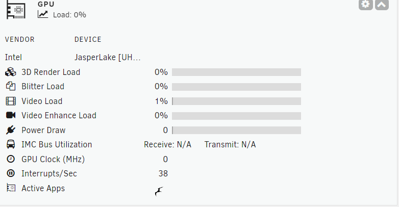

Hi all,
Today, out of nowhere this started to happen with this plugin. Any idea how to get it to stick? Notice the error that shows at the bottom? I have no VMs at all.

2 minutes ago, Twix_sv said:
What does this mean, what can i do?
which gpu would you like to monitor ?
sample, Intel iGPU > intel gpu top, Nvidia > Nvidia plugin, ...
@alturismo
I wanted to check the iGPU of my N100.
On the one hand to save power if necessary and secondly to check whether it is also used when transoding.
Did the "intel gpu top" have some GUI for the Dashboard?
Greets .. Twix_sv ..
1 minute ago, Twix_sv said:
@alturismo
You need to install intel gpu top as that is used by gpustats.
each vendor needs different plugins.

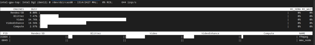

Doing some testing on these specific apps, they are working on Nvidia cards but not on a friends Intel Arc gpu (6.12.x thor build kernel for arc support).
I can see the same app name show up in his intel gpu top output, I'm assuming name detection use the same definitions created in Nvidia.php? (couldn't see anywhere else to define)
Any thoughts on how to troubleshoot the issue?

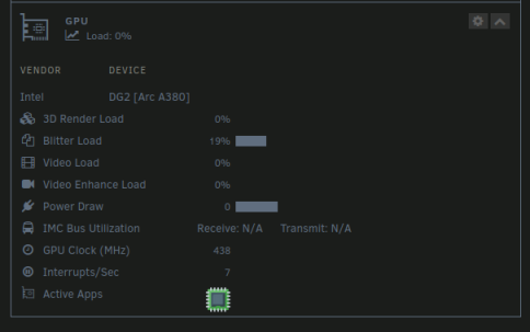

Hey @SimonF this has worked for ARC gpu for the apps I added.
Would you like me to wait until you release the updated plugin with intel support before submitting my PR?
We also did notice Emby uses ffmpeg for transcoding on ARC, not sure if you have any ideas on how to make it identifiable, we don't seem to be able to see the full command in intel gpu top.

Thank you for this plugin.
Will the above files fix my blank gpu stats? Intel Arc 380.
